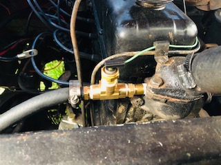

    This one checked in spec so far, well, what I did was use my resistance box to find out what it wanted for Cold and Hot and just found a sender in that range. I found some numbers that are supposed to be good on the Stovebolt forum. My plan is to leave the aftermarket mechanical gauge in for right now to compare to the 56 electric and this sender. If it's good I'll pull the mechanical out and cap off the old hole. Actually I just remembered I had pictures on my phone, borderline OCD when it comes to numbers, haha. This sender was a BWD crossover from a Echlin TS6469. 100deg Cold at 368ohms-220deg @ 80ohms. 1/2 pipe with the ****on (nail head looking) terminal. The fuel sender should be in Friday and I'll run it and see. Got it plumbed in already. I'll let you know how it goes though.
    This is where I've put the electric sender in this old 235 for now. I read you can get the housing off of a 261 and it's got 2 tapped holes, but this guy is going to small block this car pretty soon anyway. So he said T it in.

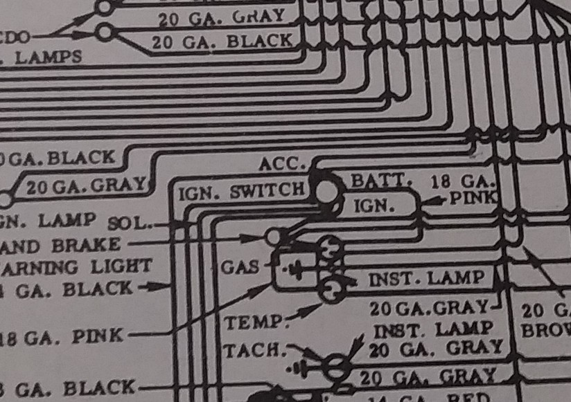

    Bump. My '56 Vette gauge isn't working. When it turn the key on it moves from below empty to empty, so it must have power. If I ground the other side terminal (brown wire going to tank), without disconnecting the brown wire, should it read full?

    Is it just a 2 wire gauge? I wasn't sure if the Vette gauge was something different or not. Just saw this and hadn't looked for a diagram yet. Basically when I was working on the 55 Chevy, I grounded the gauge (cluster/gauge flange) and powered it up and with full ground to the sender post, it sat at E. When I moved the float on the sender and gave it 30 ohms of resistance to ground...it would move to full. So 0 ohms or straight ground at the sender post (12v at the power post of the gauge) was Empty and 30 ohms resistance to ground was Full. So if it works like this 55 gauge I was working on... It sounds like you're getting full power and ground to get you to empty and your float or sender is never giving any resistance to make it move toward Full. You could take a meter and check resistance to ground on your sender wire or at the sender and see what you've got.

    I just finished messing with it. My wiring diagram shows 3 wires I think, hard to tell. Anyway I disconnected the brown wire to the sending unit and it goes to full when I turn the key on, so I suspect either a grounded brown wire or the sending unit isn't working. Thanks for the reply. 20210719_155918(2).jpg

    No problem, the float may have a hole in it and it's sitting on the bottom of the tank (showing empty). Looks like it is a 3 wire, but the 3rd wire is just a jumper wire to power the temp gauge. I think you're on the right track though, finding out why your sender wire is giving the gauge full ground.
