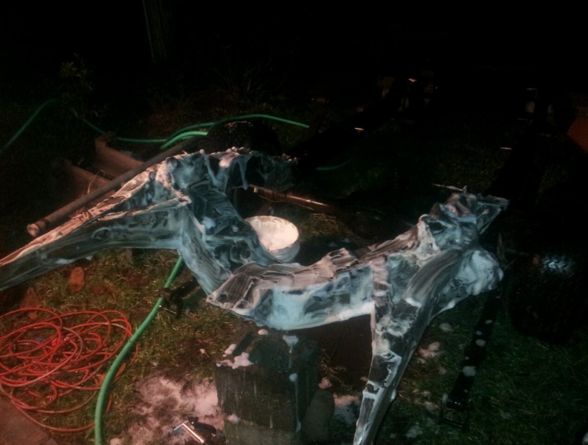

    It was 33 deg out last night but I still got my **** out there and scrubbed up the frame last night.

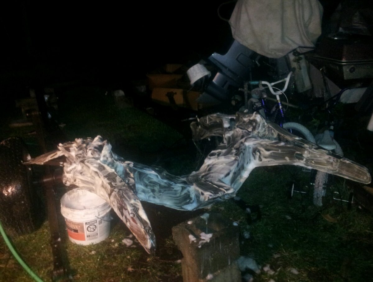

    And then it was white! I had enough left over white rustoleum left over from my Model A build to paint it...... till I knocked my Harbor Freight gun over.... luckly tractor supply is open pretty late...
    I guess you can add another $45 (gallon of white and hardener) to the total.... since we will use some more of this paint.

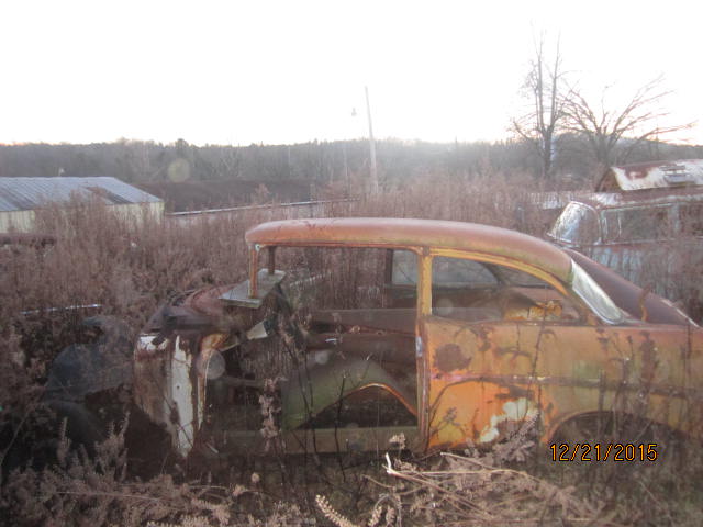

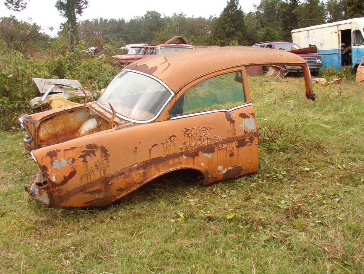

  9. 55 &56 chevy 001.JPG 348.jpg For a second I thought you all had my 56 body. It is now setting on a 55 frame with the 55 cowl. 55 &56 chevy 001.JPG

  10. wheeldog57
    Joined: Dec 6, 2013
    Posts: 3,848
    wheeldog57
    YOWZA! That is a crispy critter!Looks like you will be welding for awhile.
