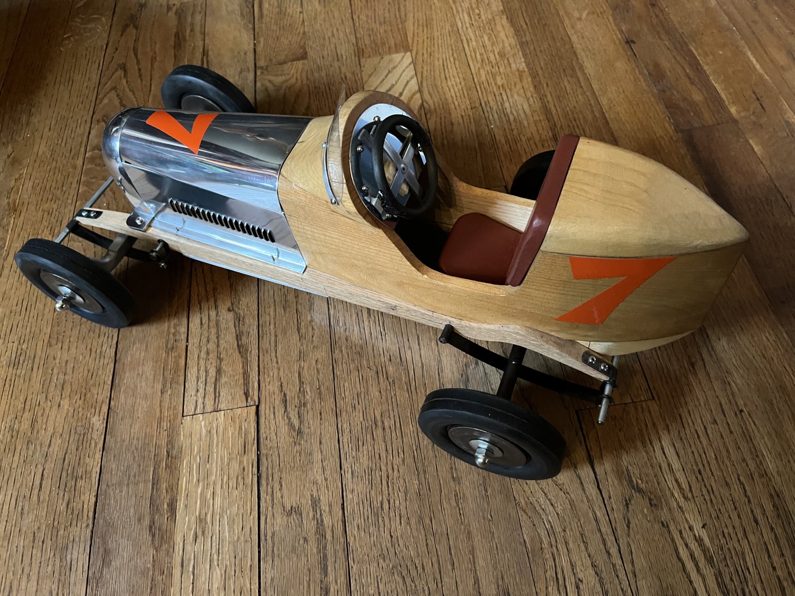

    A Boner
    Just start off building a static model of one.....the main thing is to take the first step. Then build a second one if you think you can do better. Here is one I build many years ago. It has wood tail and cowl areas, and the sides are made from some 1/8" thick hobby shop plywood. The grill shell is carved out of a chunk of wood. The hood is .030 -.040 aluminum. The pan is some aluminum that I had a friend with a brake fold the sides down. The axles are threaded rod with an aluminum tube covering. The wheels and tires are model airplane from a hobby shop. The air cleaners are axle caps from a hardware store. The windshield is from a soda bottle! Give it a try, you will have fun!

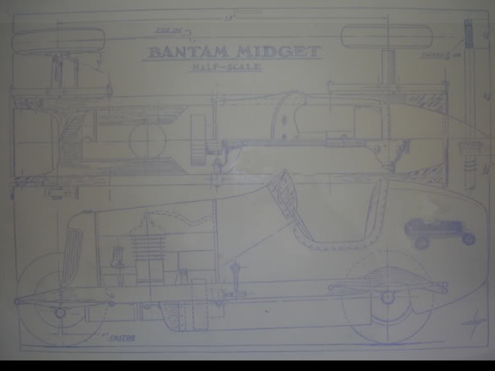

    A Boner
    Here are some plans for a Bantam Midget......13" wheelbase......and a "loose" example of a Bantam Midget. Many were built, very few followed the plans 100%. Most Bantam Midgets had the main body made with (pine), and the frame rails made with (Maple). This example, the only wood used is the Maple frame and the blue painted pine tail top.

    A Boner
    Another (unfinished) Bantam Midget loosely built using the 1940 “Model Craftman Magazine”, blueprints from (post #9) above. I enlarged the image in the magazine to the actual 13” wheelbase dimension, on the blueprint.

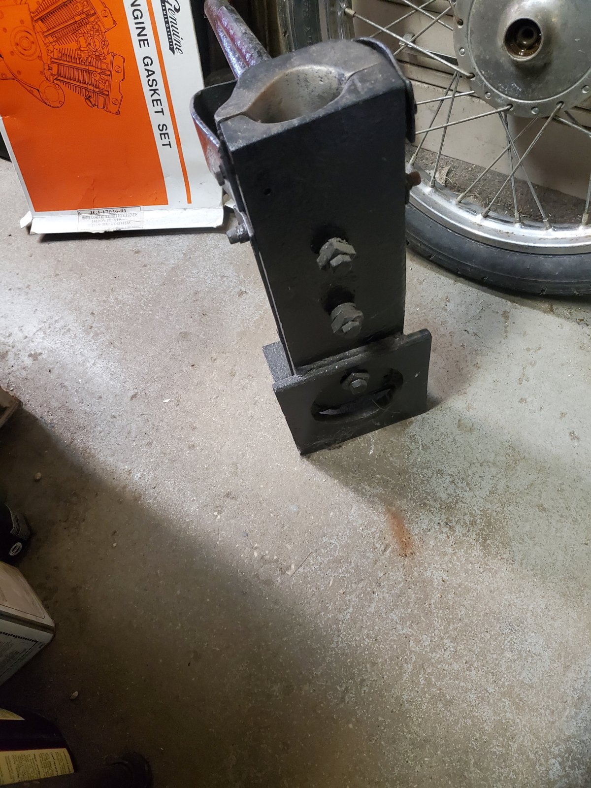

    ROADSTER1927

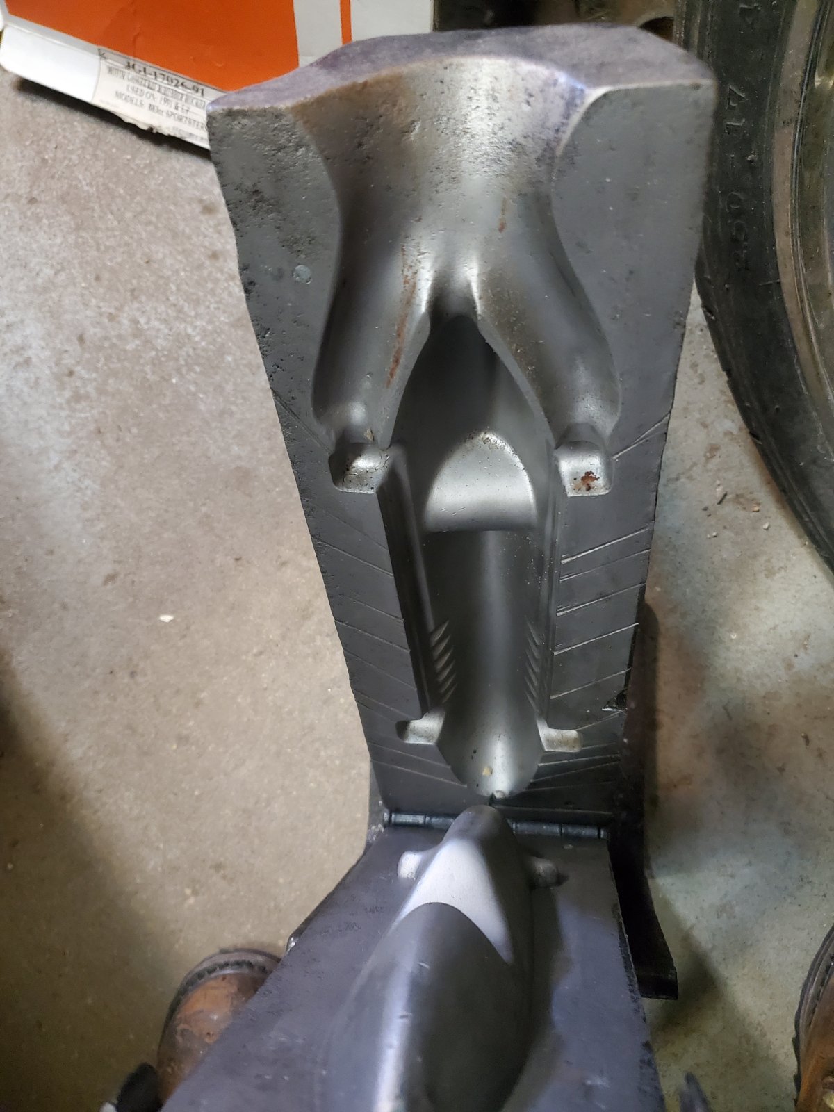

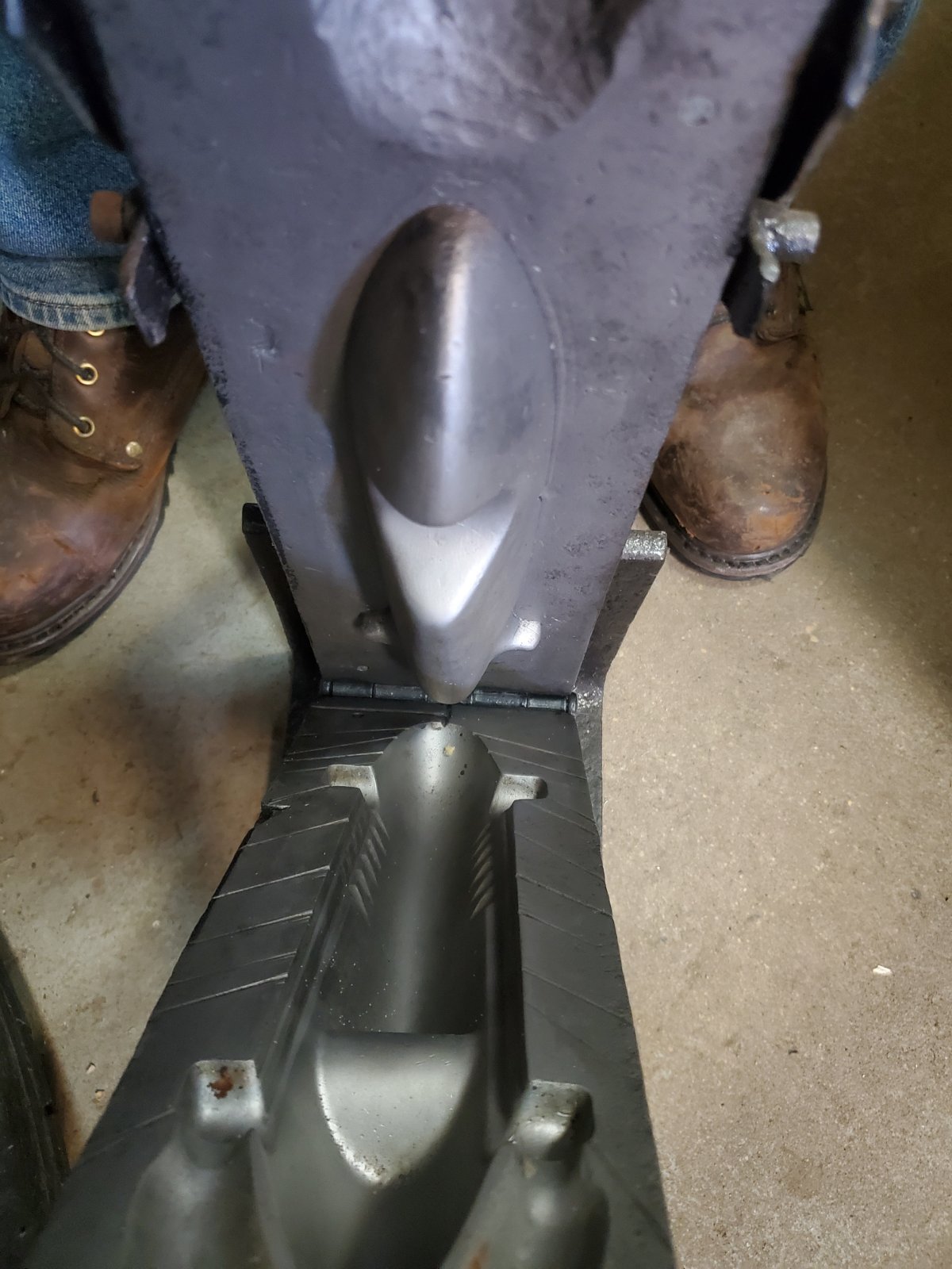

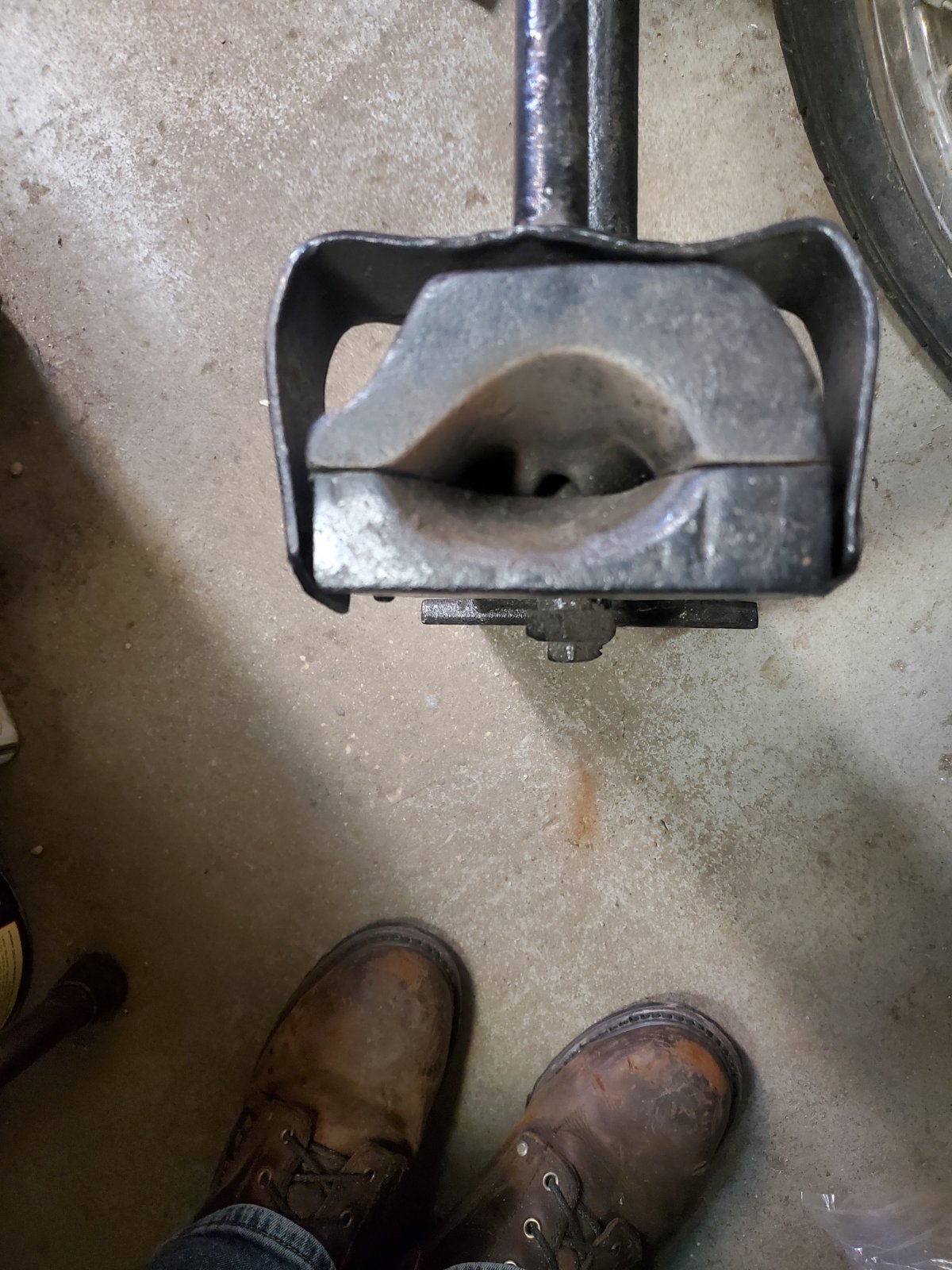

    I have a tether car mold and I thought about casting some. I have not casted anything before and could use a few pointers! I think the mold is steel. Gary 20240326_152634_resized_1.jpg 20240326_152640_resized_1.jpg 20240326_152708_resized_1.jpg 20240326_152721_resized_1.jpg

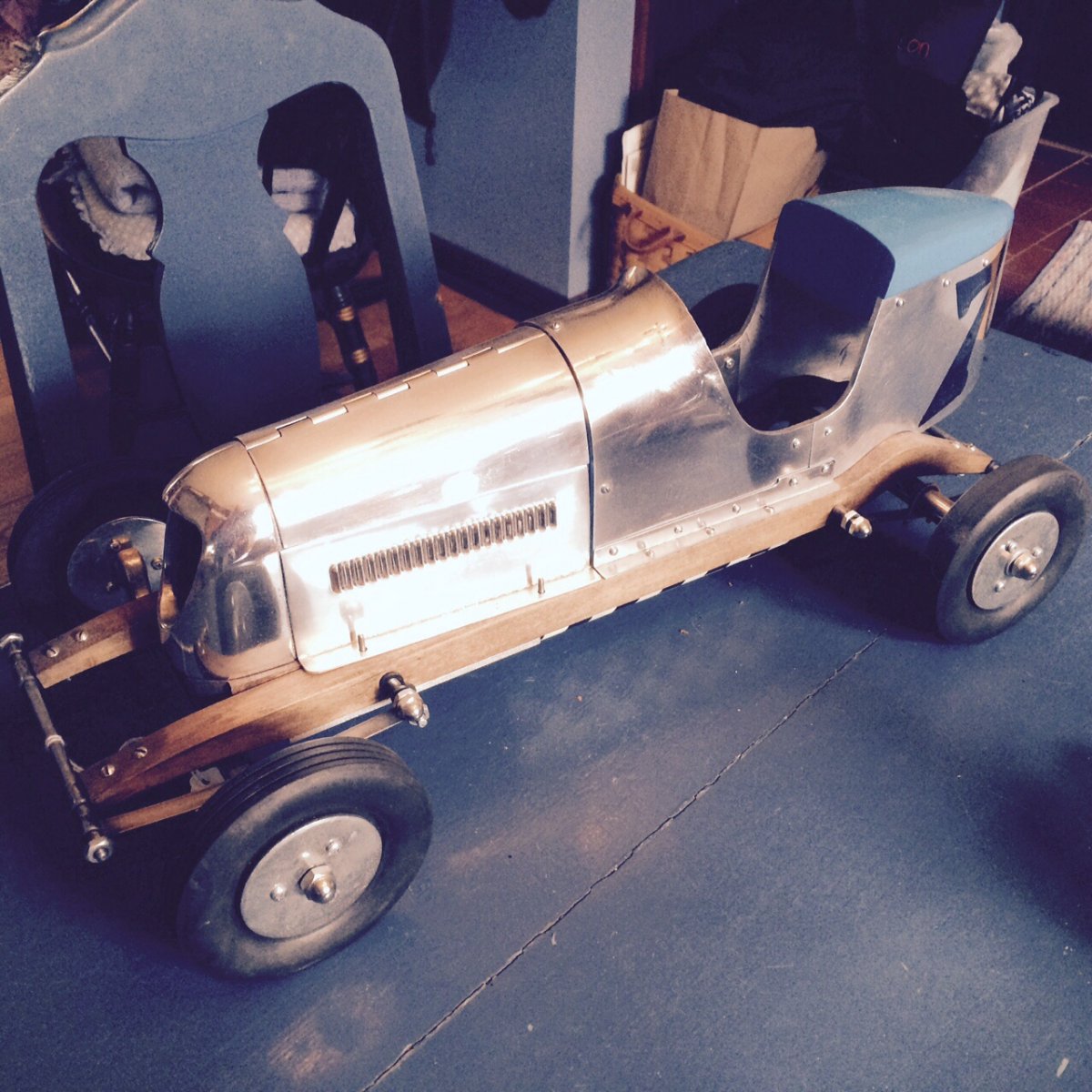

  21. I had a good friend who was in the business of reproducing pieces from lost wax casting. He found pieces of a tether car at a Model T club swap meet. The tail, cowl grill shell, belly pan and the axles are all castings from his molds. I machined wheels for him. I didn't have a lot of interest until I saw the tires he made from molds he engraved him self. I was, and still am astounded at the lettering detail on the tires. The springs are pieces of a band saw blade. He made a form to bend the hood and then made a die to stamp the louvers. He even sewed the upolstery. Tony passed about 15 years ago and I still miss him.

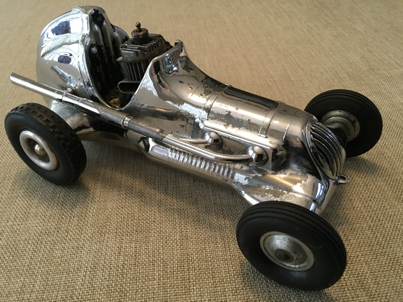

    Tether Cars come up for sale quite often on eBay as well as engines and other drive train components. I sold this Thimble Drome a couple years ago which is a more modern version even though I had it since the middle 50’s. IMG_0928.jpeg IMG_0929.jpeg

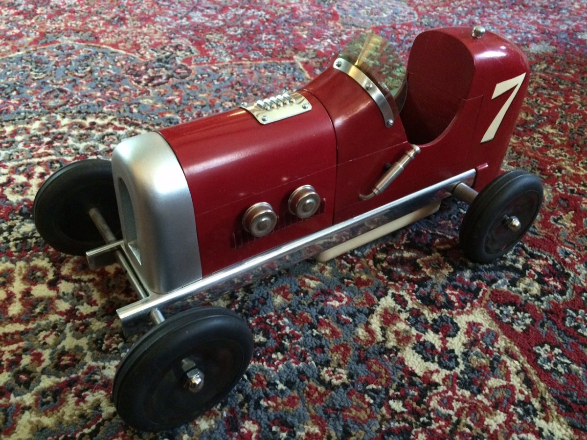

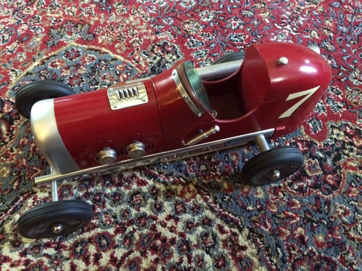

  25. Dad bought me this Ohlsson & Rice teather car in 1956.
    Nobey, oil burner, A Boner and 3 others like this.

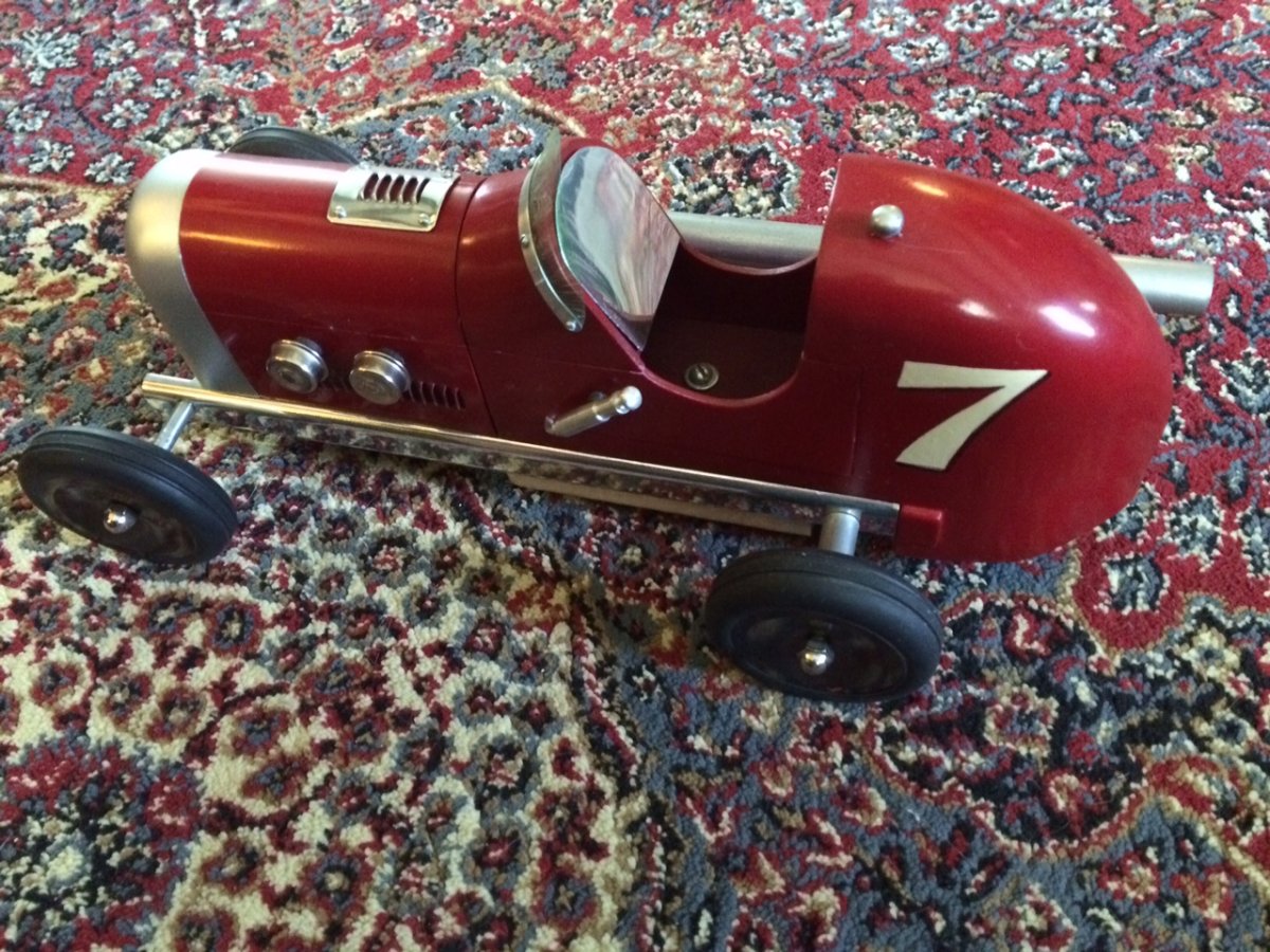

  26. The other side.
    Nobey, lurker mick, porkshop and 5 others like this.

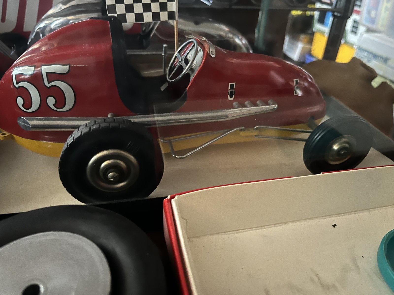

  27. A Boner
    Joined: Dec 25, 2004
    Posts: 8,031
    A Boner
    890E80EF-2F36-4B1D-B0F9-54903B60745E.jpeg Here is my favorite O&R…sorry for the crummy pic. They are definitely the slickest looking mite cars.
