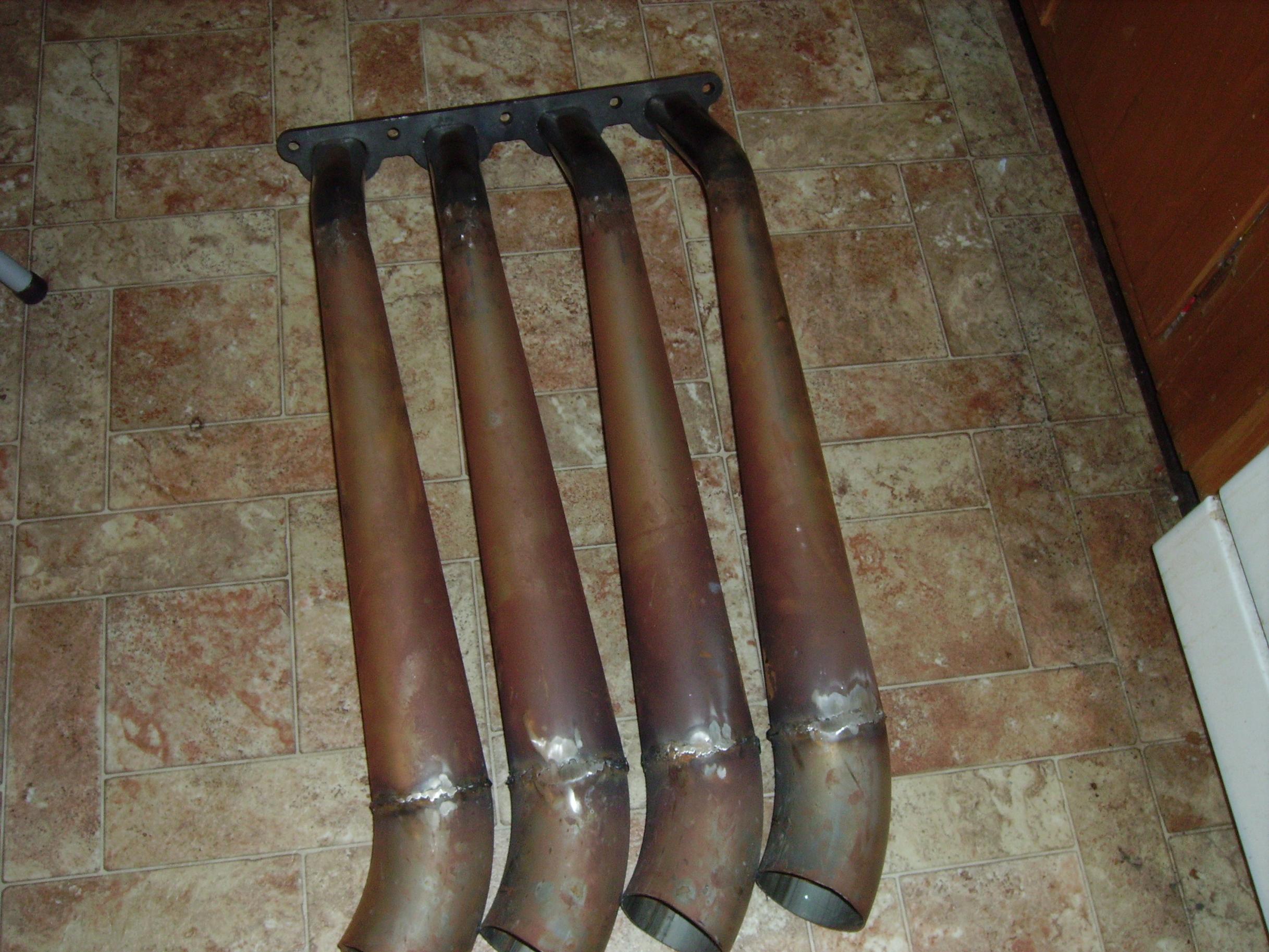

    Here is a picture of my zoomy at 8AM left out overnight. The pic in my avatar was 5PM the previous day.
      507.1 KB
      192
