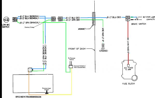

    I'm replacing a 350 in a customers truck. To a 350 lockup.. Can anybody tell me how to make a correct wiring so it work good. i have vacuum switch. that's all... I have done it on 700R before just with +12v on the contact and off by brake or ''botton off''. Now i need to to it serious. Thanks...
