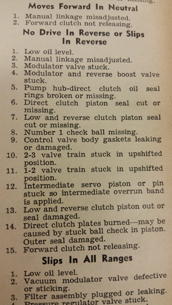

    Wrong valve body gasket?
  15. saltflats
    Joined: Aug 14, 2007
    Posts: 13,781
    saltflats
    from Missouri
    Maybe this will help.
    Zettle Bros. likes this.
  16. Excuse me ...There are 5 on a T350. The last two are for forward clutch, which we are told, works.
    The other three are for direct (3rd) . I am concerned about them because you need the direct for reverse.
    I suspect a non- stock mis-match , or malfunction in that area.
    Can see how the v.b. gasket is wrong, when he said he didn't change anything else.
    Not being there, all we have is words on a page.

    How would the valve body be wrong if I didn't have a problem before?
