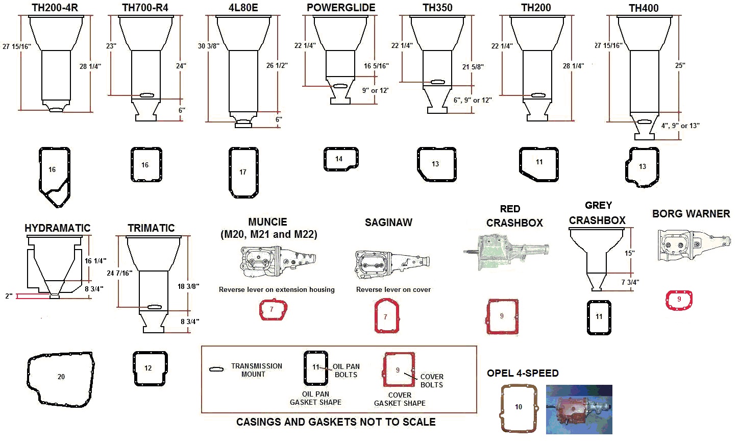

    How to identify th-200 and 250? vs 350? I have an 84 olds cutl*** with 3.8 and an 80? pontiac yellowbird with 3.8. Would like to ID trans believe both working but have sat for years.

    Transmissions and their respective Gasket Info.jpg The T-250 looks like a T-350, but will have a band adjustment screw between the cooling lines on the case.
    Slow down and alphabet soup like this.
