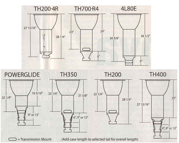

    I've never done it, but this may help.
  3. squirrel
    Joined: Sep 23, 2004
    Posts: 59,175
    squirrel
    the long tail 350 is the same length as a 700, and has the mount in the same places as a short tail 350 (it's on the main case, not the tailhousing), so it seems to me it should work just fine. Might be more of a pain to get it up in there, though.

  9. Bruce Lancaster
    Joined: Oct 9, 2001
    Posts: 21,681
    Bruce Lancaster
    That chart is for post-1964 Glides. Iron ones AND early aluminum ones are shorter, have different splines.
