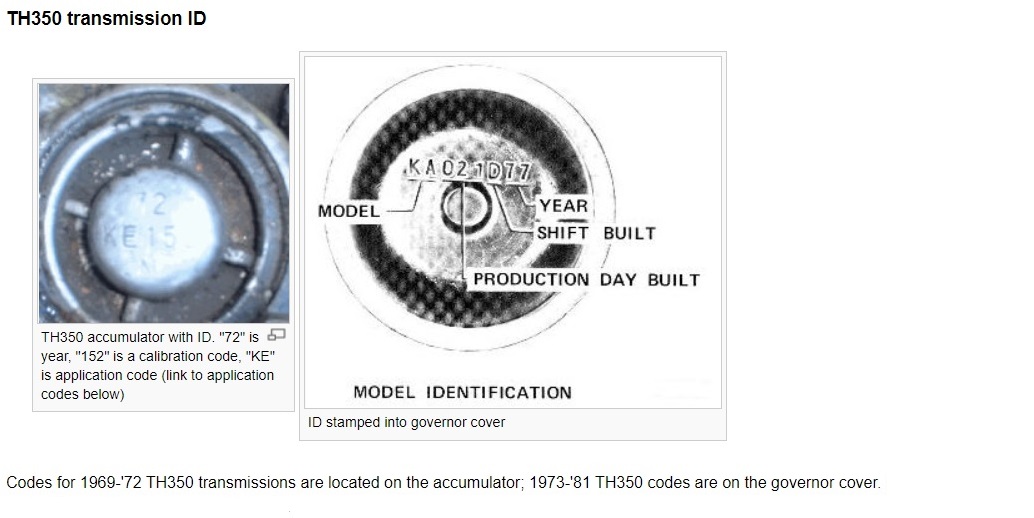

    I just bought a used Th350 and was told it was out of a Camaro. But the only numbers I can find on it is a large letter C and the number 3 on the bell housing and the number #137427124 that was located on the left side of the case (facing forward) I want to find out what year it is and where it was made!
    Any help would be great! KC

    All these response's are great but what I wanted to know was what year it is and where it was made?

    If 137 is a partial VIN then it's a Chevy car, 1973, built in Lordstown, which made full size cars.
    Is that enough info?

    Thanks, Squirrel!
    That's what I wanted to know! KC
