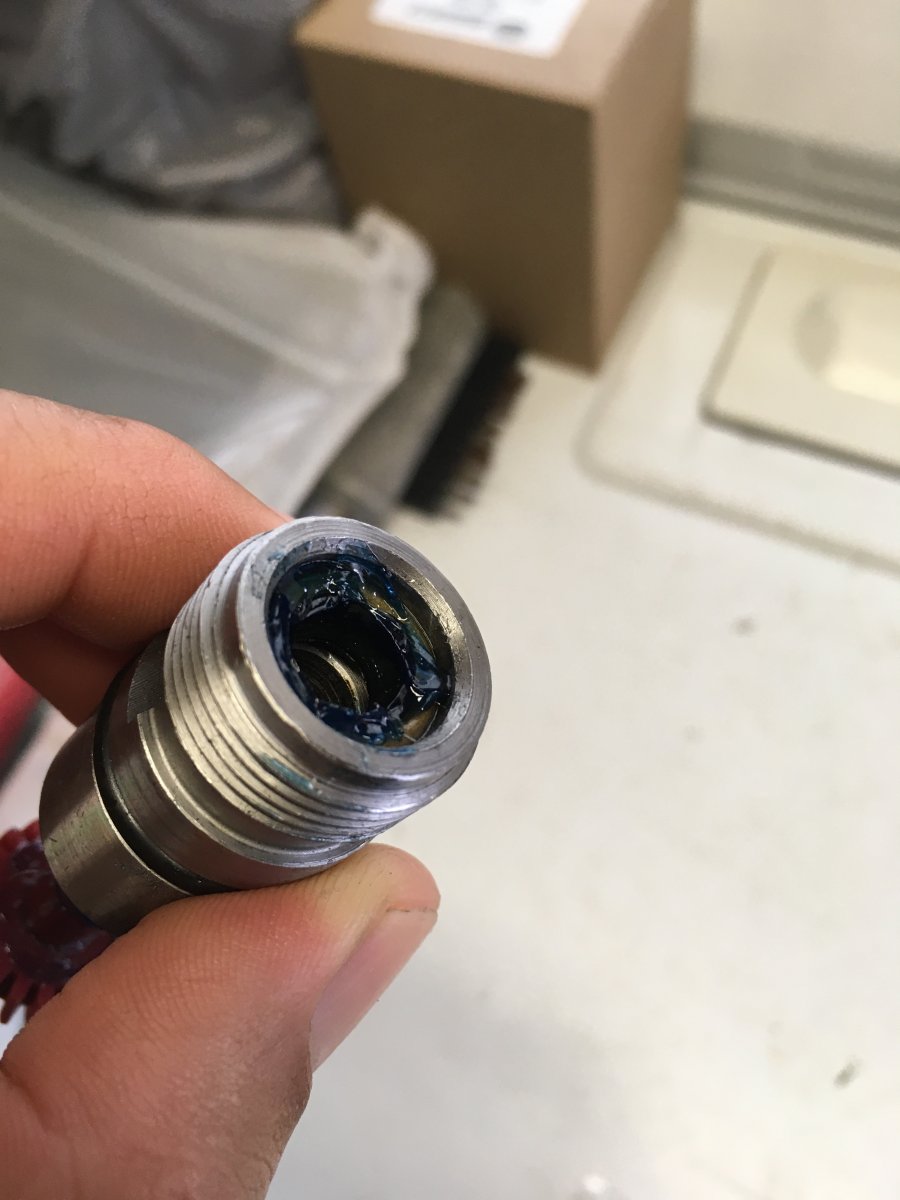

    Hi, does anyone recognize the blue grease in the photo for the speedo bullet assembly? I bought a new one with new red gear and it came with blue grease but I'm not sure if that's supposed to stay or I'm supposed to clean that off.
  26. TA DAD
    Joined: Mar 2, 2014
    Posts: 1,562
    TA DAD
    from NC
    It looks like assembly lube, you can leave it.
    SDrocker likes this.
