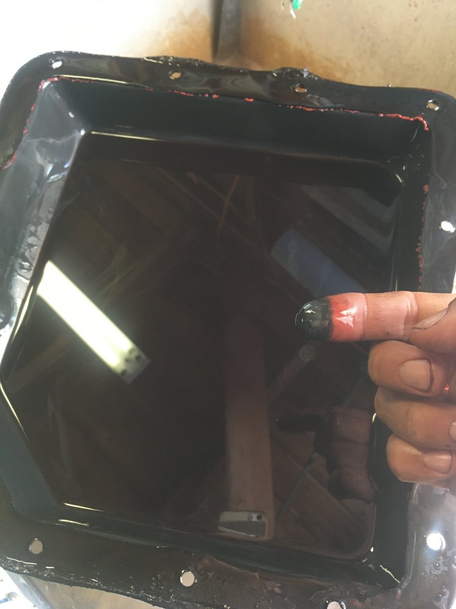

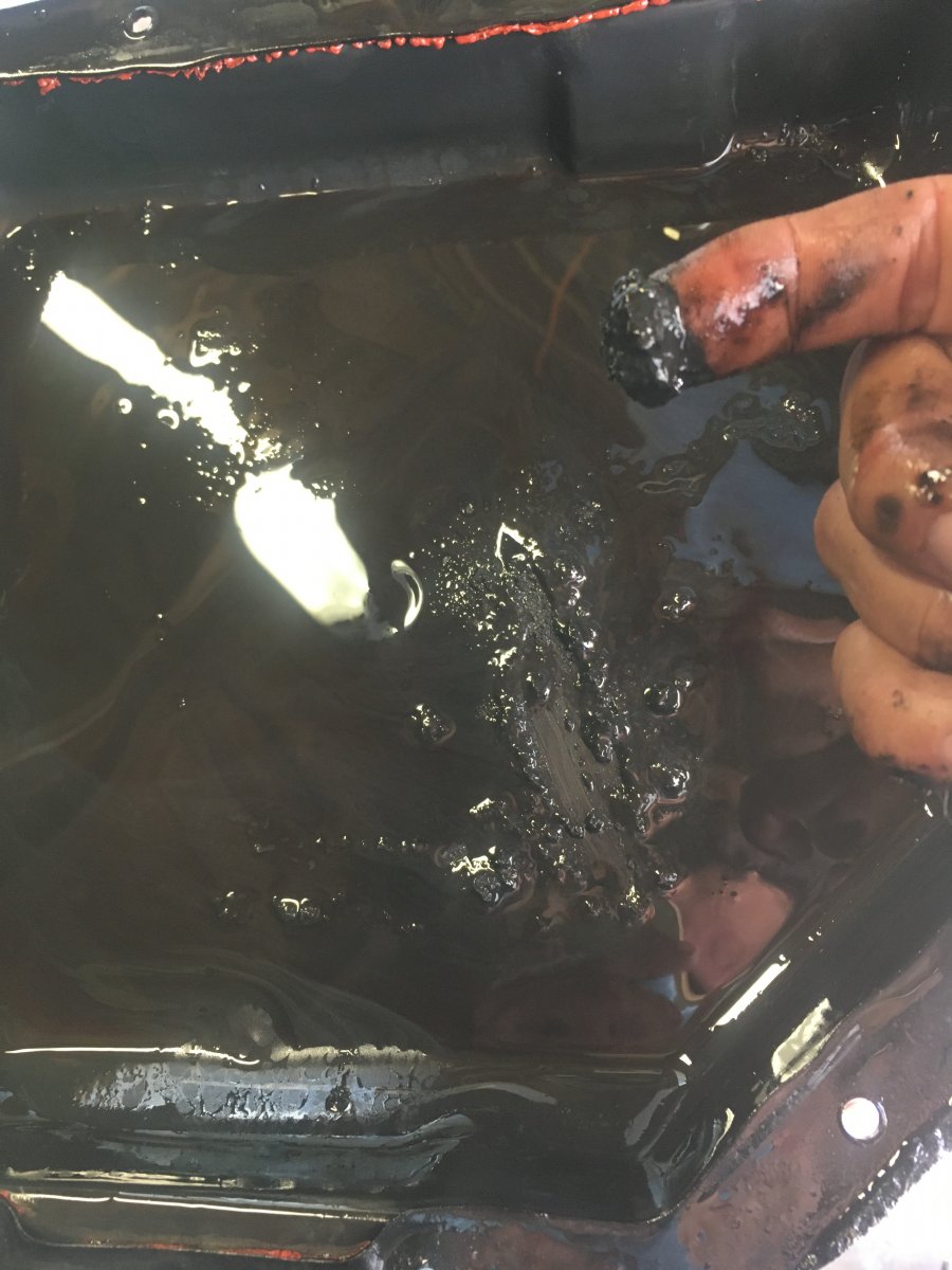

    There's absolutely no downside to changing the fluid. The trans obviously has had some damage internally based on the metal in the bottom of the pan. You can't hurt anything by cleaning it all out and replacing it. On the other hand, keeping that **** in there will only accelerate the wear on your already damaged clutches and internal parts.
    Driver50x, Lil32 and SDrocker like this.

    That was once your clutch & band friction material , looks pretty much worn out .
