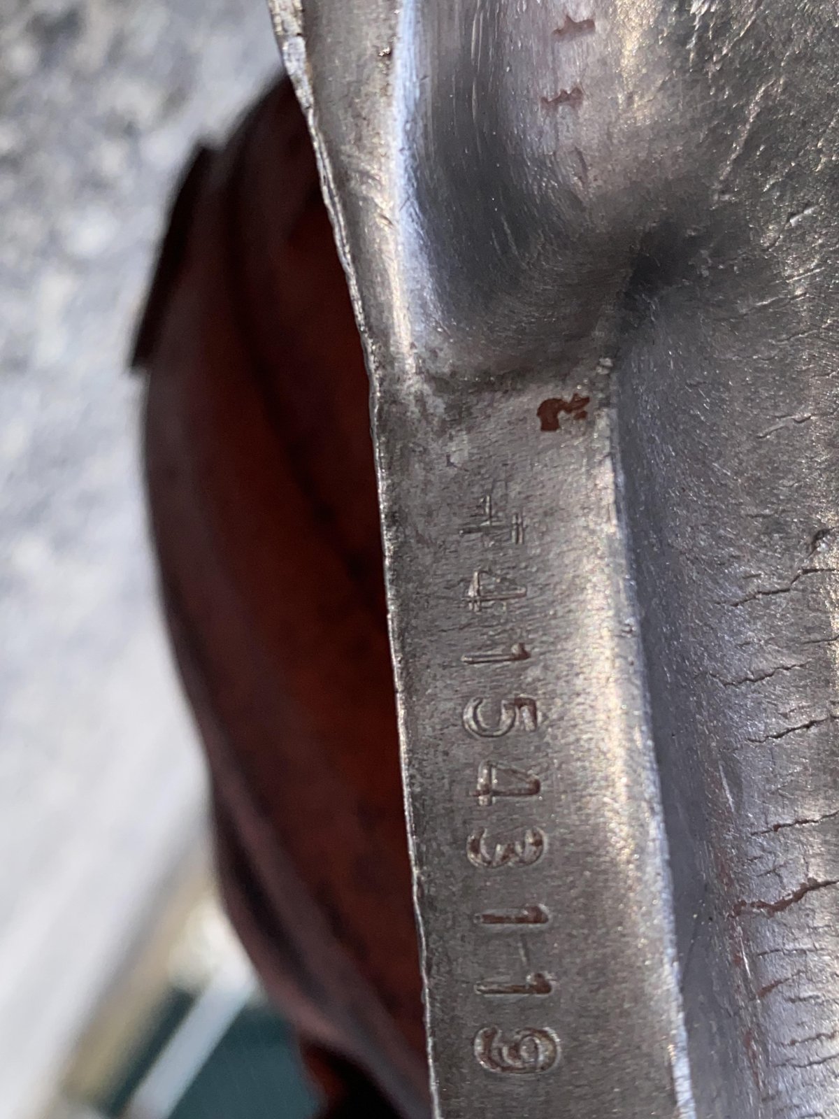

    Can anyone tell me what this turbo 350 transmission came out of , its a Chevy bell housing and 6" tail stock length, here are the numbers from the unit
    VIN Pad
    T41543119

    Most likely not.
    Is there a reason why you need to know the origin?
    You know the production year and the tail length.
    The biggest differences in 1974 would have been the speedometer gears, and the governor weights.

    full size 74 chevy ***embled in Oshawa
    which, as he said, really doesn't help you at all.
