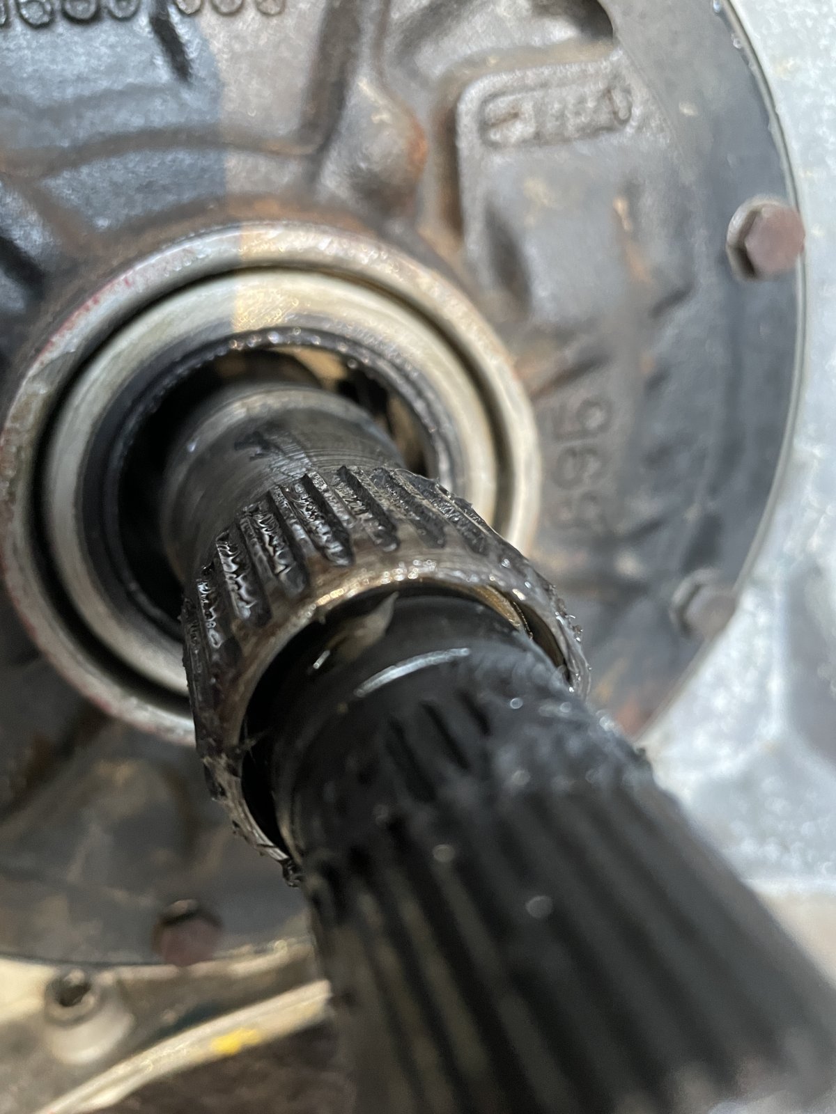

    So I finally got it out and looking at it I don’t see any damage from the outside. Thinking of dropping it at the trans shop though to be safe. What do y’all think? The putter splined shaft doesn’t rotate though is that normal? The TC slides in nicely otherwise and no funny sounds when I turn it. Thanks!

    I don’t see the ears on the pump gear. Can you look between the seal and the stator shaft and see the ears on the pump gear? Two tangs? Should be visible. Is so, take a small screwdriver or pick and see if you can turn it.

  19. 19Eddy30
    Joined: Mar 27, 2011
    Posts: 5,149
    19Eddy30
    from VA
    Removed seal much easer to see
    Budget36 likes this.
  20. The picture appears to show that the pump gear is in backwards with a chip broken out of the drive tag. Since your shop put it together, take it back.
