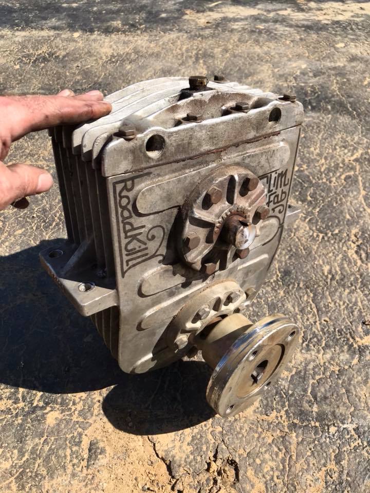

    make sure you get a stout V drive....did you see what happened to Stubby Bob last week?
    "Roadkill is at the Eagle Field Drags and we just broke our Casale Toploader v drive. We need a replacement v drive ASAP. If u can bring one here in the next few hours we will love you forever! Needs to. E this exact model and we also need the woodruff keys for the input and output shafts. "
    enloe and loudbang like this.

    Those Casale box drives were not that strong. Used mostly in mid to upper hp lower rpm family ski boats.

    i had a stout one in my 1964 16' rayson craft with an L88......thing whined like a rock crusher.....miss that boat

    That's an old V-drive, like early to mid 1960s. We had one just like it in the flatbottom my Dad built back in '61-63. Should be plenty of units out there now days that can take a whole lot more abuse than that one.

    Had one in my '66 Beyers flat, 425 Buick. Like I said mid to upper hp and lower rpm.
    Don't know about using the v-drive method. May set the engine way too high. Saw one at Delavin car show years ago in a Falcon pickup. Engine with blower sat higher than the roof.
