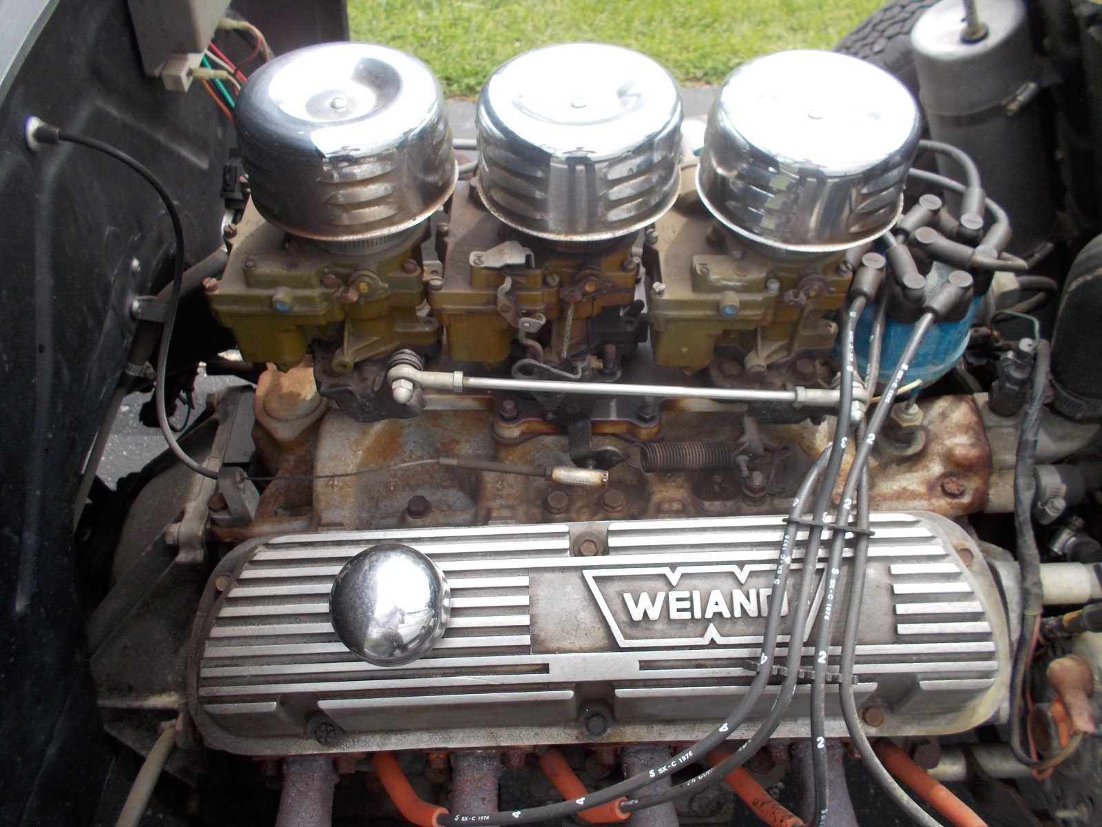

    Thanks Doug. It has fooled a lot of people. You should do that on your build for the look of trips and the bottom end tractability of a two barrel. You may need to add some sheet aluminum skirting around the botttom of yours to complete the look.

    Here's a pic of the other side with the bogus secondary progressive linkage. Note the carbs are turned around backwards to clear the front mounted Ford distributor.
