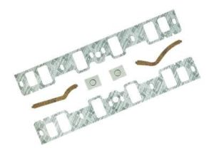

    1250 gasket is what fixed it.
    casting numbers on ford heads are on the bottom and hard to read when installed, also locating them between the pushrods makes it even more fun.
    If you want casting numbers and such, send me a head gasket set and the time to tear them back off, and I'll givem to ya.
    the date on the top of the head says 8E25, april 25 78,, too many things not making any sense with this deal.
    A local ford guy looked at the heads after they were installed and says they were 77-80 ford truck heads, and thats what I ordered gaskets for. (dont give me any **** about that either, you are the SBFKing and you incorrectly id'ed the heads as 76, hard to be 76 heads when they were cast in 78)
    as for the difference in teh water port holes on the gaskets you displayed, I was working off pics from teh auto parts store's website. the size of the pics makes it a guess as to port size.
    You guys should include accurate measurements in your books/catalogs so those of us without the gaskets in stock can have access to them without having to order a smathering of gaskets.

    no, not on the first call. that was found by ordering a smathering of gaskets and picking the one that fit.
    after I had the proper gasket you(?) offered up the 1250 as a possible cure, by then we had it figured out.

    I used a Victor head gasket set it came with both early small port and late large port intake gaskets.I needed the small port gaskets for the 289 Hi-Po heads on my 302.

    He did point me at the other 90103-1 gasket but by the pics and without measurements it looked the same size front to back and shorter top to bottom. I didnt argue with him about whether it would work or not.
    again, you have access with the dimensions, we as customers do not.

    8E25, May 25 1968- and the heads are obviously earlier small water port. Most of the early small-block heads have their engine size cast in fairly large numbers, under the valve covers in plain sight- 289, 302, 351 etc.
    Applications for the gaskets you bought are below; NOT "any and all 289, 302, 351 windsor motors".
    You misidentified your heads and bought the wrong gaskets. Get over it. The extent you're going to here to NOT admit you made a mistake and shift the blame to others probably shows why you and the Felpro reps didn't "hit it off", and ended up turning a molehill into a dramafest- again, get over it, and let this ill-conceived thread die

    I may very well have made a mistake, havent and wont deny it, just was a little put off by the customer service guys.
    One mistake was not looking closer at the gasket around the water ports, wont happen again.
    as for the mis id,, dunno thats not my feild of expertise. I got a buddy that gave me his best guess and thats what I ran with. Call customer service to find out what the issue was and got nowhere. they too it seems missed the correct id on the heads, as did sbfking here.
    by your list those gaskets should fit every one of the wrong Id's.
    it would suprise the **** out of me if these heads were of 60 vintage, but stranger things have happened.
    anyway, its fixed and I'm on to other issues.

    To add to the bull shi .I orderd week ago from Summit, full engine kit and got 2 intake gaskets large and small.

    Just to help clarify the casting #'s, a C8 number isn't necessarily a 1968 part, it designates the model year of the vehicle it was designed for, in this case '68 which was when the 302 came out. That makes it possible to have a C8 part with a 1967 date code, as the model year and calendar year are not the same, and '68 cars were in production in mid-'67. The casting # stays the same until a change is made in the basic casting (a revision), and at that point a new casting # is generated reflecting the change. Same with the D8OE number used as an example, designed for the '78 model year, and probably, but not necessarily, put into production in '77. The "O" designates that it was designed for the midsize Fairlane line, A is full size, Galaxie etc., Z is Mustang, T truck, etc. The suffix (as in "-A") designates exactly which casting it is, as the second part of the casting number defines what type of part, 6090 is a cylinder head, 6015 is a block, 9425 is an intake manifold, etc. An example is a C8OE 6090-N, otherwise known as the 428 Cobra Jet head- 1968, designed for Fairlane line, cylinder head, and the -N defines the particular 428CJ casting. Another is a C2SE 6090-B head, which came on a 406- but also on a rare '62 M-code 390-340hp 3-deuce T-Bird, which came out before the mid-year introduction of the 406- so it has the "S" line designation of the Thunderbird line, as it was originally designed for the Bird, and then also used on the 406 later
