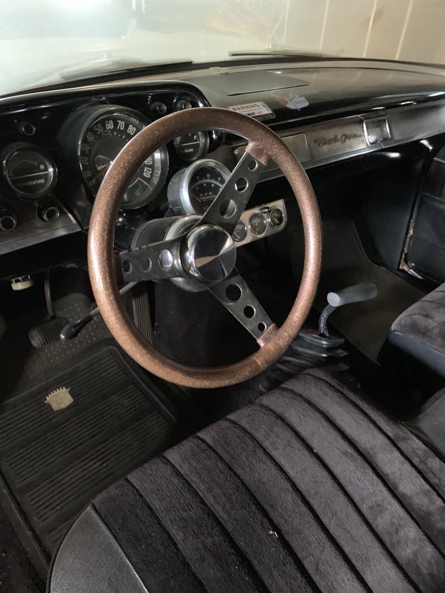

    My ‘57 h top , was set up for a 4spd before Hurst came out with the C shifter. As you can see , she has the old cut bench modification. I custom bent an old Comp Plus for optimum placement : A43816FA-D127-4F55-A70B-B7053AE1526D.jpeg

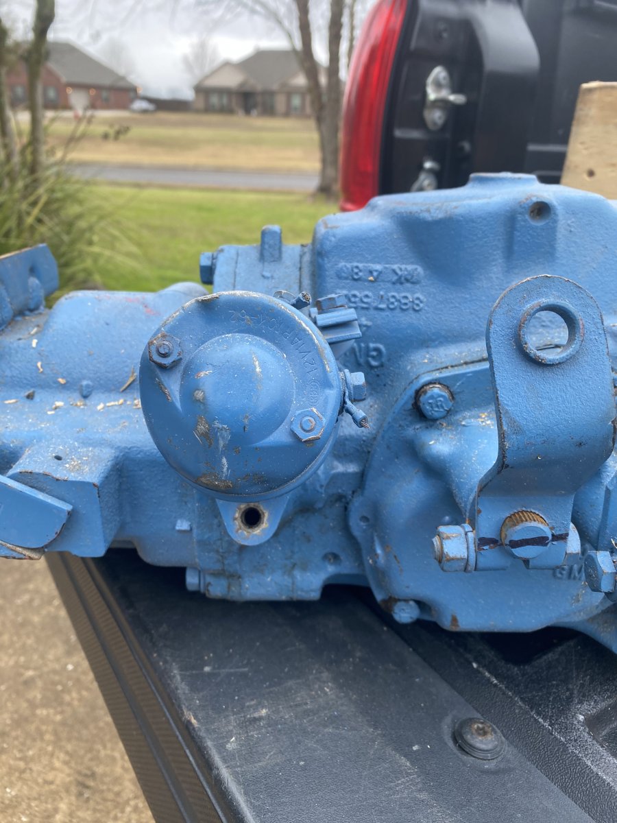

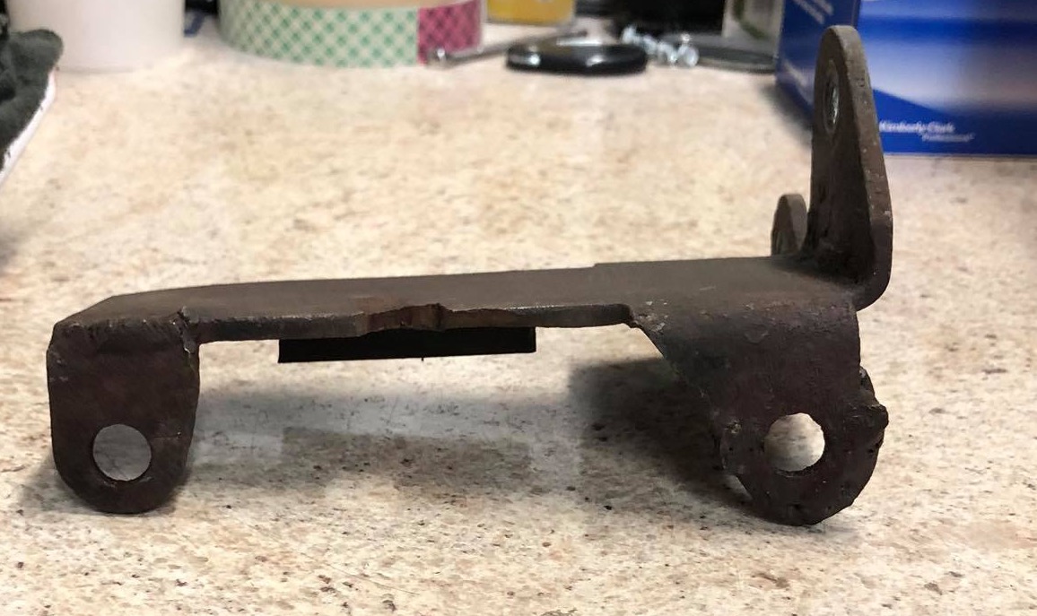

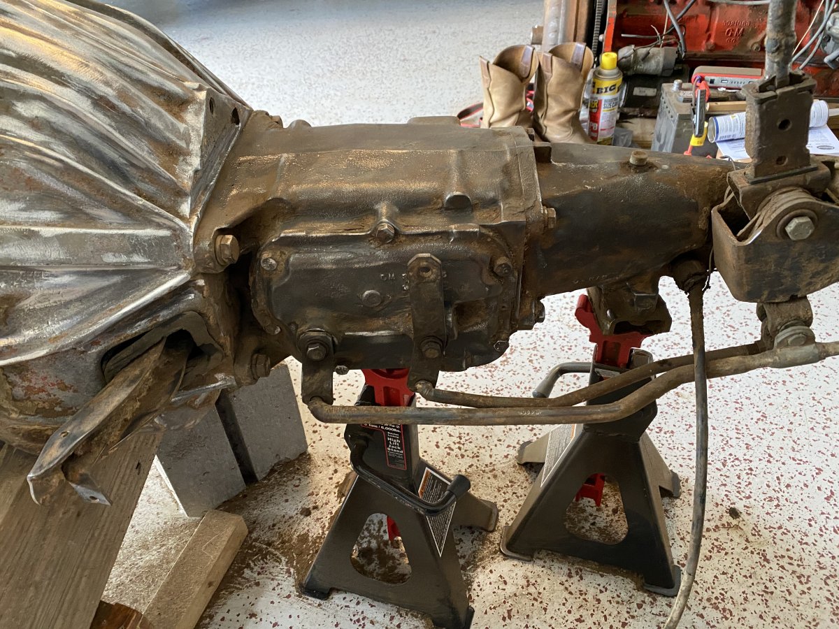

    Sh2

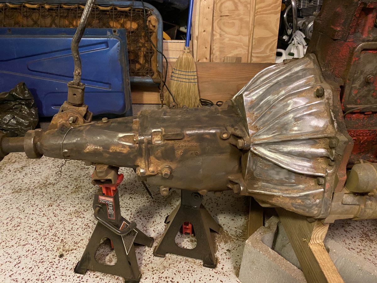

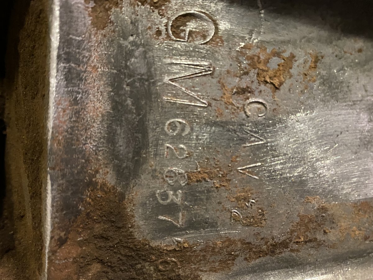

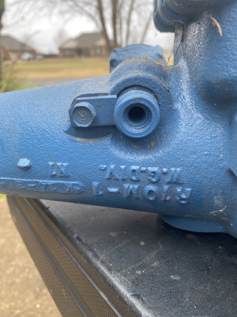

    You just don't know how much I appreciate this information. The friend that I teach with, who is old enough to be my father, like you suggested the OD transmission. In that same breath he said, keep the saginaw.
    The saginaw has been taken off. I'm going to buy a new clutch and pressure plate. I'll get the flywheel resurfaced.

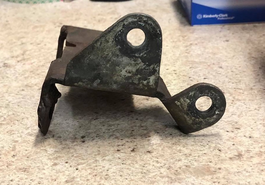

    DCF3FE40-CB9A-487E-98A8-4766CE55D13F.jpeg 4D727323-19CE-478B-9005-F618E590D968.jpeg 1E032514-323C-4547-9C37-2BD8B418FF25.jpeg 419B9457-FF41-49C9-B08A-907FF7519F5E.jpeg 64C2A1B1-993E-42B4-AC6E-E231CF61D6D7.jpeg BC74E1DD-3AAD-4AF9-9436-B8F57F59F4B2.jpeg

    Your Muncie 319 does have an extension housing cross-member mount, but it looks to be broken/missing part of the rubber mounting. I'm also going to guess that the lower transmission bolts to bell-housing mounting has bolts/washers/nuts, as it is a truck bell-housing, and it's one of those "funny" bell-housings that could take a 5 bolt transmission mounting (there was just a thread on that here). There's really nothing wrong with the shifter that's on the Saginaw, other than the transmission shift levers are on upside down. The engine is a 292 as evidenced by the "tall" side covers. Good thing about the linkage on the transmission, your Hurst Mastershift will bolt to the adapter bracket, and you can use your rods and levers, although they won't be as close "toleranced" as Hurst pieces would be. I'd sell the Muncie 319, and use the Saginaw if it were me. If you compare the Saginaw shifter with the Hurst, you'll see they are very similar, because the same company that actually made Hurst shifters for Hurst, also made the factory shifters. If you want the mounts for the Muncie 319, I'd need a name/address and shipping for them. Trust me, I'm actually an honest person. I am Butch/56sedandelivery.

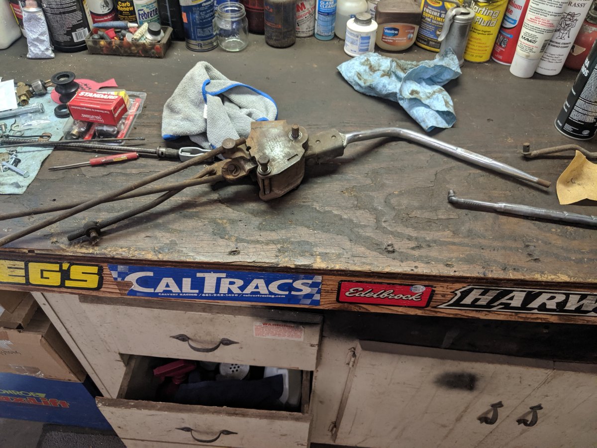

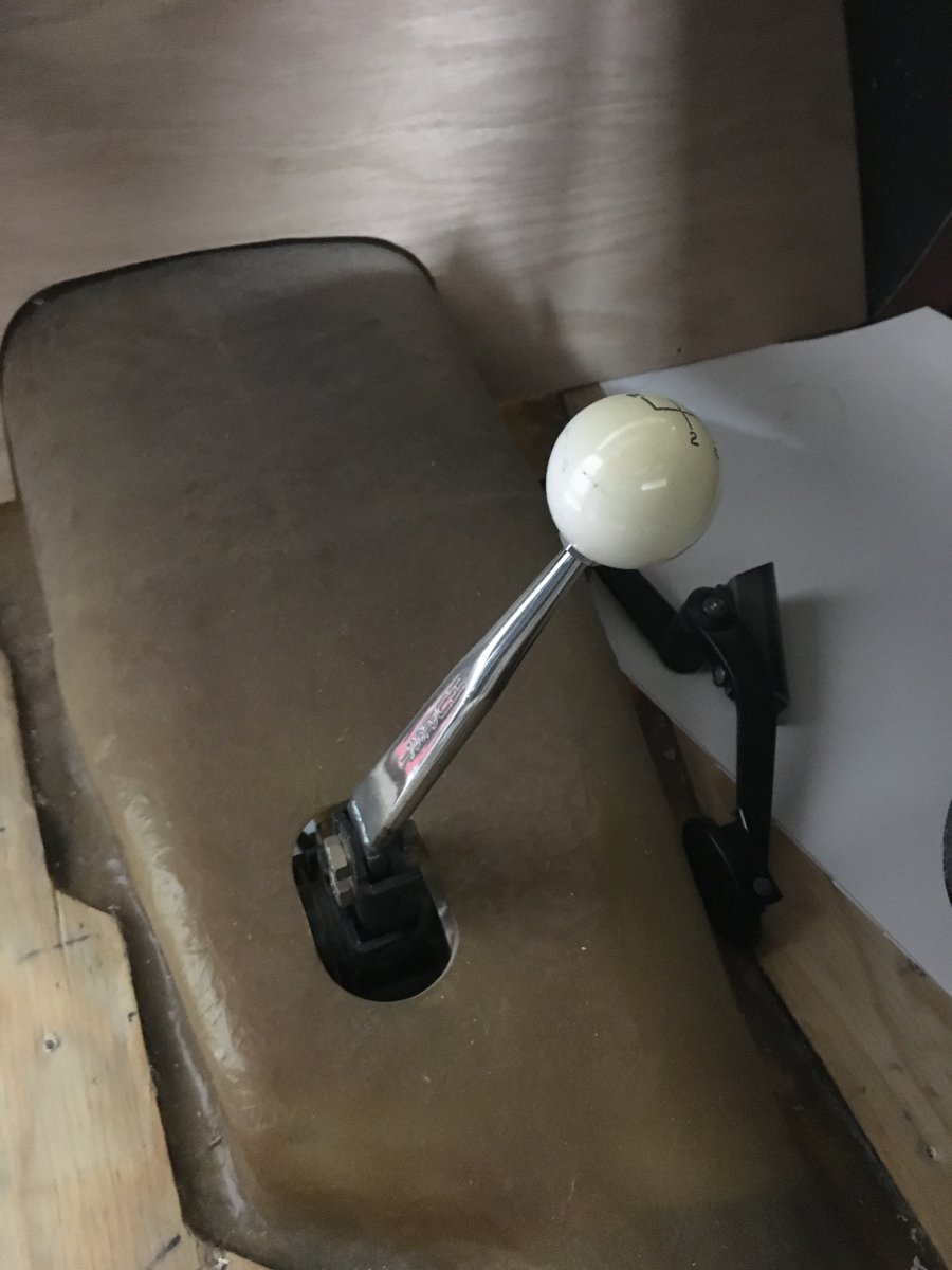

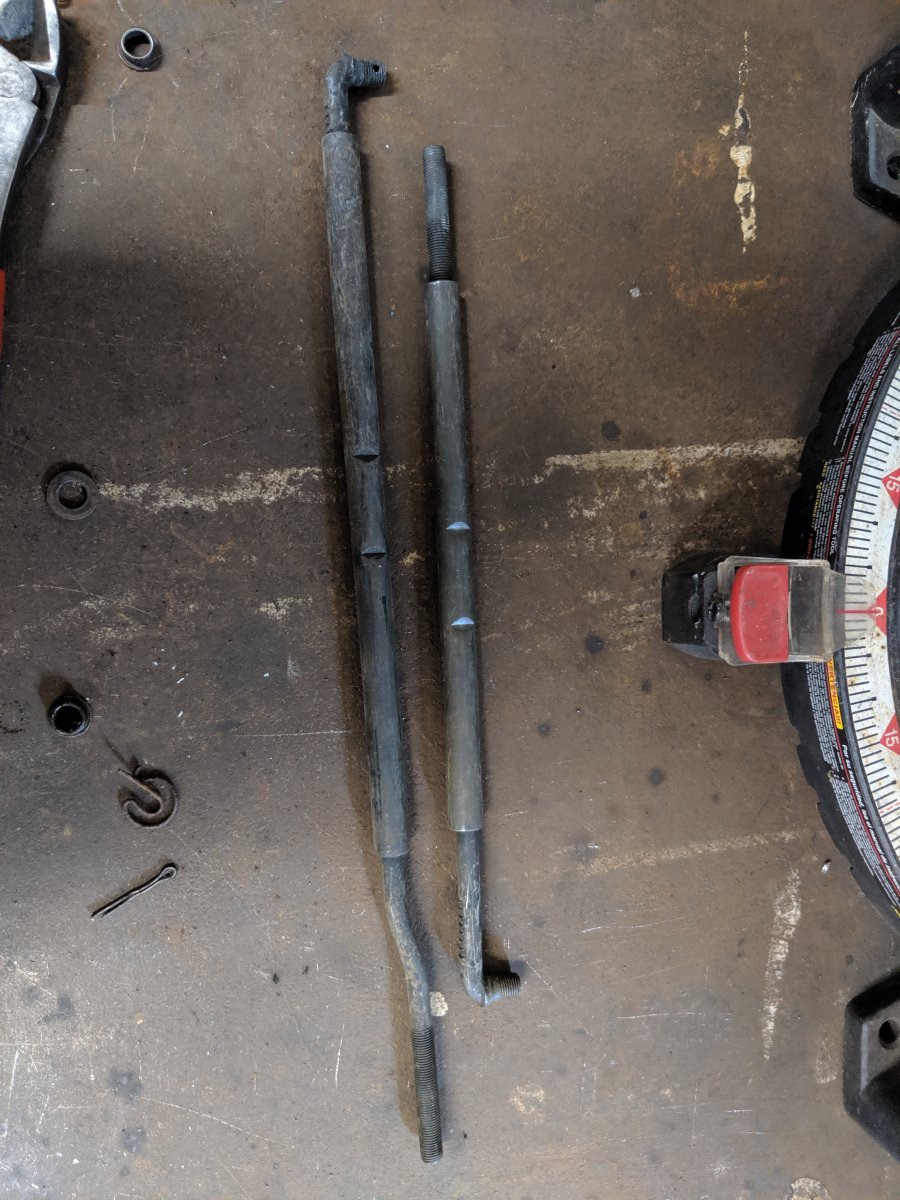

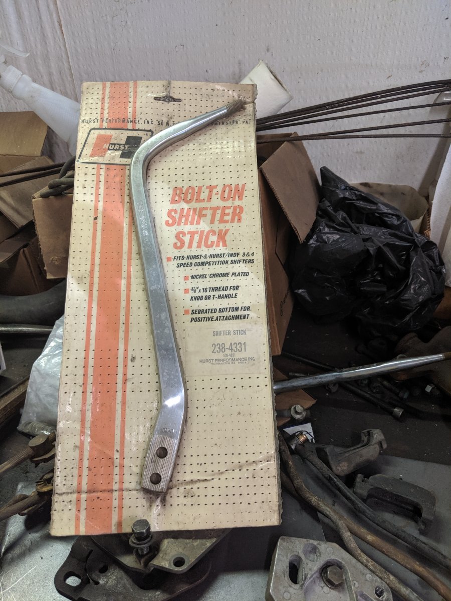

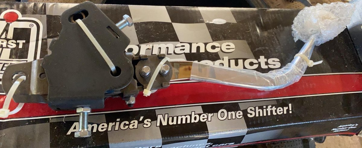

    I'll post a few pics to participate but my real reason to post is to see if anyone can tell me what this came out of.
    Just put a Super Shifter in my car. It's not in the pic but I have an early reverse lock out to put on it. My friend found me some straight reinforced rods to use at a yard sale for like $10 also. (Actually two sets so I have spares.)
    Not sure if I will like the short shifter outside of the track so I found this at a yard sale for $8.

    You can pull the push-in style stick out, drill two holes, and "collapse" the receptacle sides in a little, slip in the bolt-in style stick you bought, use a couple of grade 8 bolts for tightening strength, and you'll be fine. I used a MOPAR application, pistol grip Hurst, and converted it to a bolt-in stick. It's bolted to my spare Borg Warner Super T-10, that's bolted to my spare 327 for my Sedan Delivery. $8 and 10 for new Hurst parts is a steal! I've no idea what your shifter came in originally, but the "tower" ***emblies are all basically the same; some have a longer or curved reverse lever, but even those work with a little bending of the reverse rod.

    Looks like a Hurst "Mystery Shifter" I had one way back because they were cheaper. They do not have stops for the stick and when powershifting just a few times from 1st to 2nd the syncros were shot because of no stops they got pushed onto the forcing cones too far.

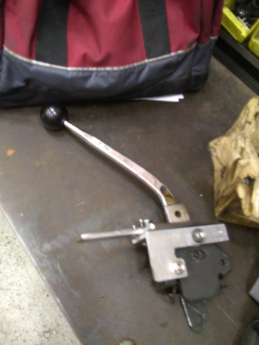

    A ****ty cell phone pic of a Hurst Autostick 1 with home made reverse lockout in Dads 37 Dodge. lockout finished.JPG Here is the lockout mocked up on an extra Autostick. KIMG0058.JPG KIMG0059.JPG

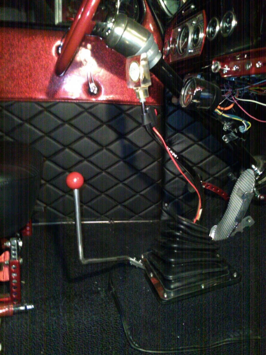

    855BCC8C-5E2C-47F5-9744-4297B2FA4CDE.jpeg Today I decided I need more leg room in my 32' project. Cut the shifter bar most of the way thru, laid it over and welded it in place. Can't wait to try it out. Maybe I will do it again up higher to straighten it up.

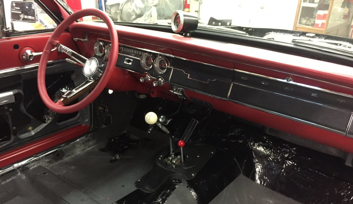

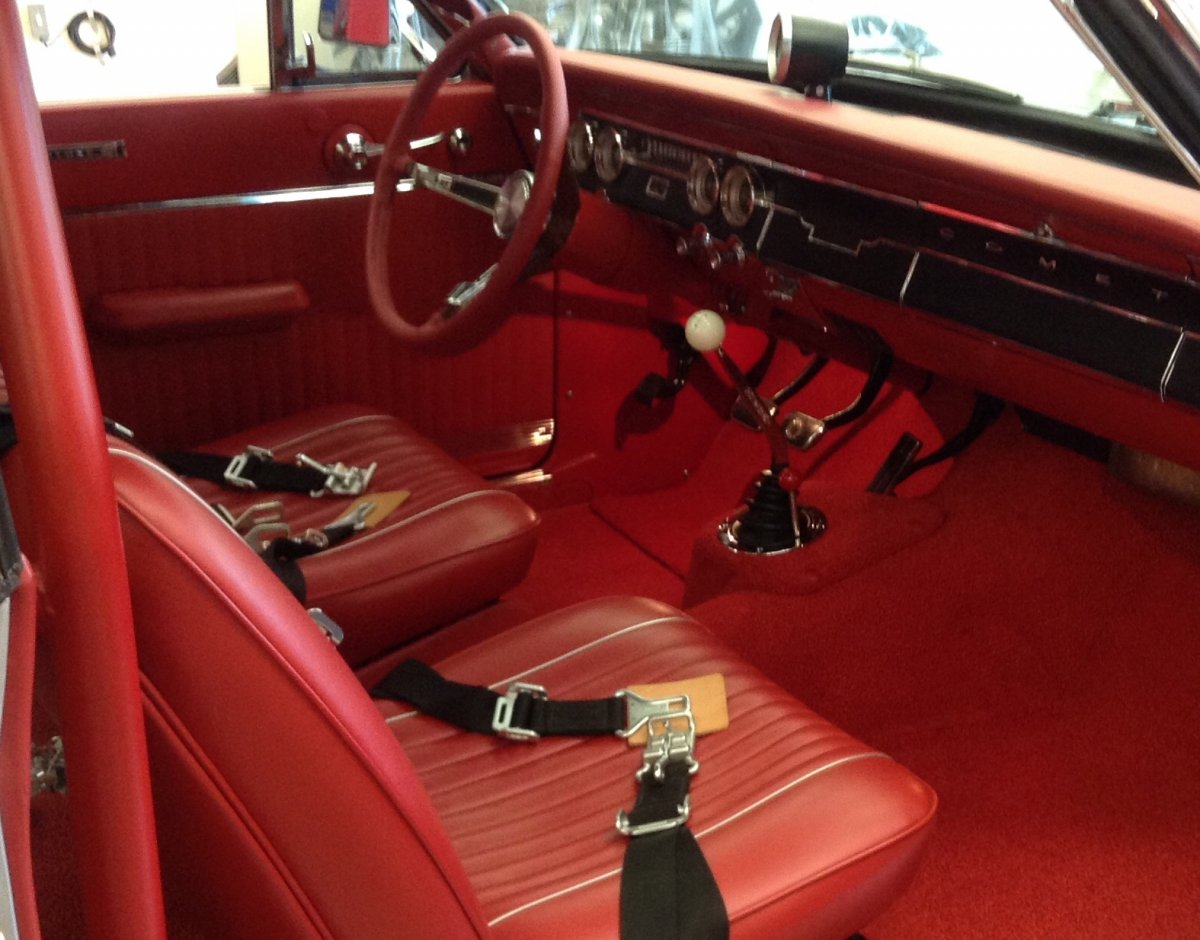

    I have always replaced the nylon bushings with steel even in new installations. The vibration transfer is negligible, the positive feel that is gained is worth the trade off. Plus it will have a cool “click” sound when you shift between gears!
    Here is my Vintage Compe***ion Plus with reverse loc/out in my Comet.
