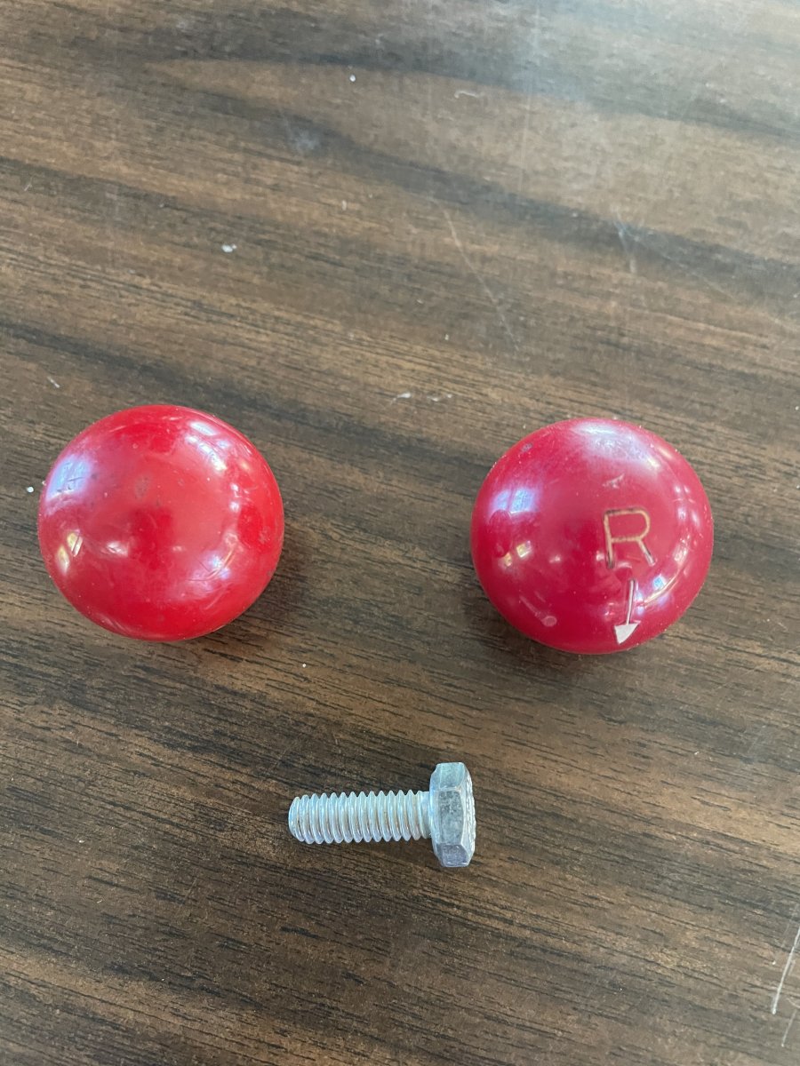

    Does anyone know the thread size on the red reverse lockout ball?

    I am thinking 1/4” co****. I can check one tonight , after work.

    Yep, just checked 1/4” co**** : F4949898-7E7D-4C71-A39B-791C3534D3DA.jpeg

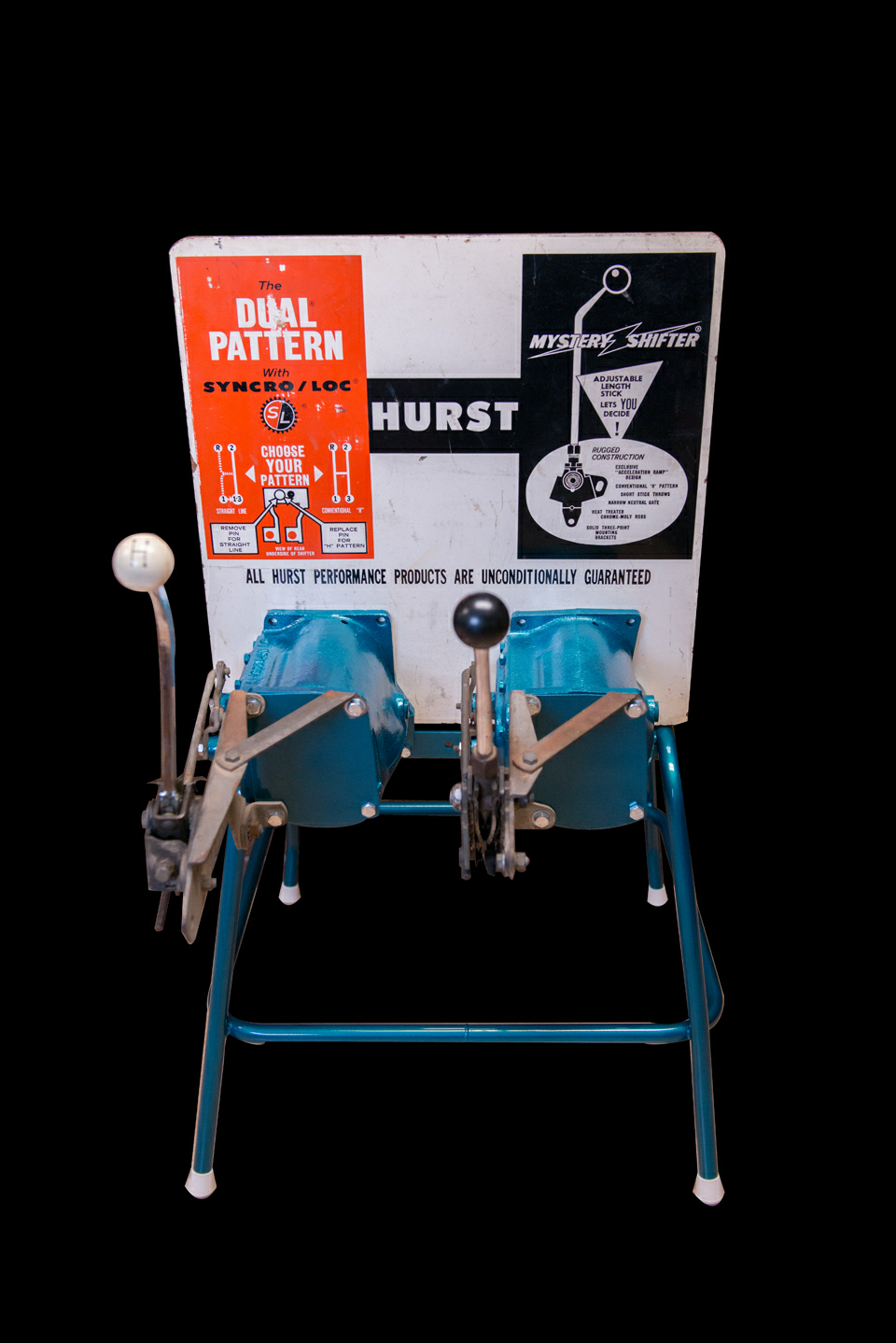

    I saw this and wondered if @Moriarity needs another one.
  12. Moriarity
    Joined: Apr 11, 2001
    Posts: 41,103
    Moriarity
    SUPER MODERATOR
    It looks like the 1 you posted sold at Barrett Jackson back in 2014 for 4500 bucks....
    I wonder if they ever made them with 4 speeds????

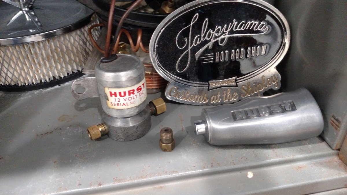

  17. IMG_20191126_225714.jpg I realize the aluminum t-handle isn't on it but I have one for it.

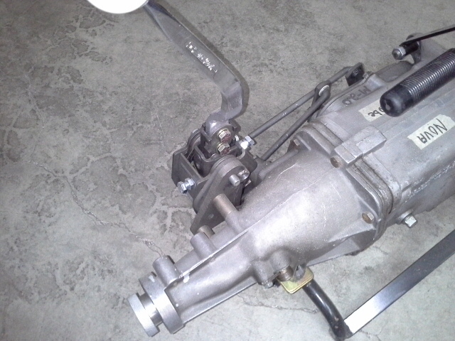

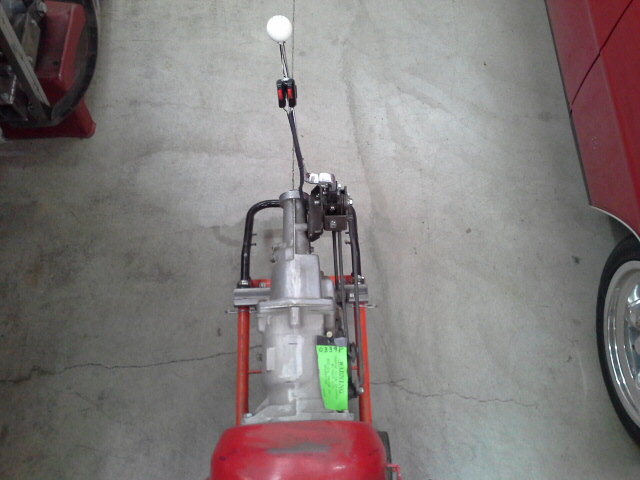

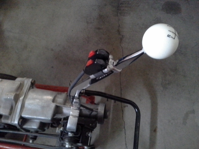

    This is the Hurst Compe***ion Plus shifter on the Muncie M-20 for my Nova.
    I didn't like the shape of the application specific handle and they need to exit the console correctly for clearance so found another one to my liking and modified it.
    The tail housing on these cars require an extra set of shifter mount bosses cast in further forward so they also used shorter rods, especially note the reverse rod, the shortest in GM applications.

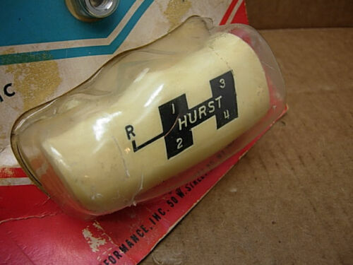

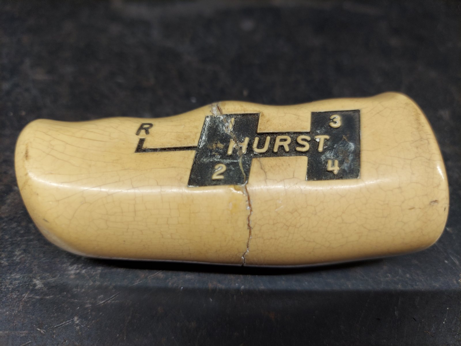

    The plastic T handles were not one of Hursts better ideas. While the two used white 4 speed ones I have are not cracked; the unopened 3speed one is starting to form a crack , without ever having been used! 0555387B-CB7D-4021-B59C-0170ABAE7F3F.jpeg

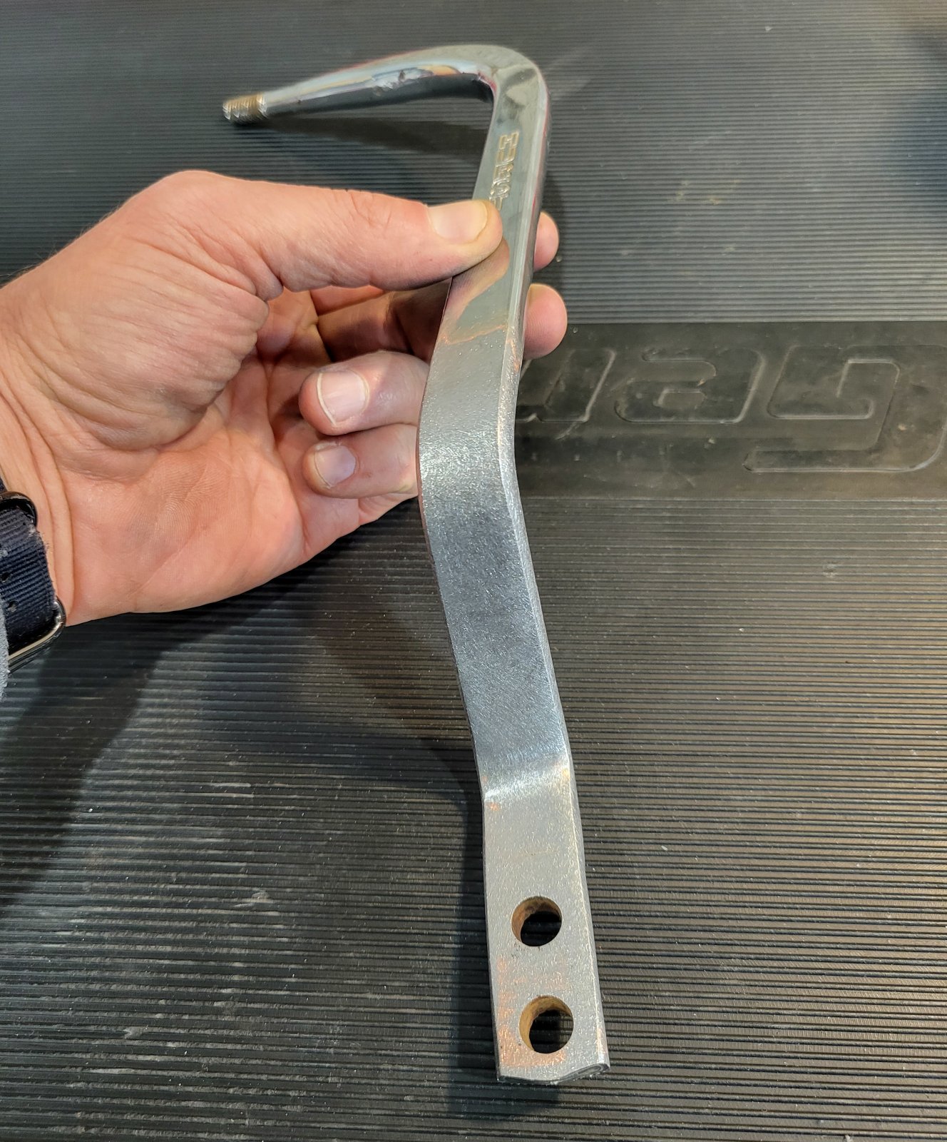

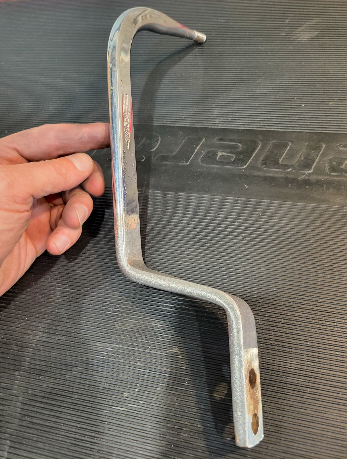

    It's probably sacrilegious to run a Hurst stick on a Long shifter but this $5 beat up Hurst came out pretty good after straightening, heating and bending an offset into it.

    Nice job! Hurst used good steel, I've seen sticks reconfigured many ways with the 'ol heat wrench!
    @bowie - one 2nd gear hit and it has racing history!

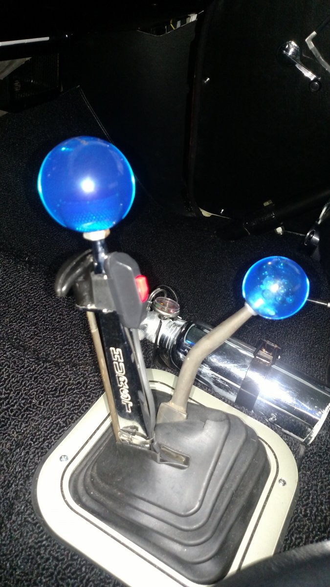

    I agree @chevy57dude . I’ve always been more of a knob kinda guy : 7307206A-40D0-4A4B-A9F4-76FB1C44FB64.jpeg

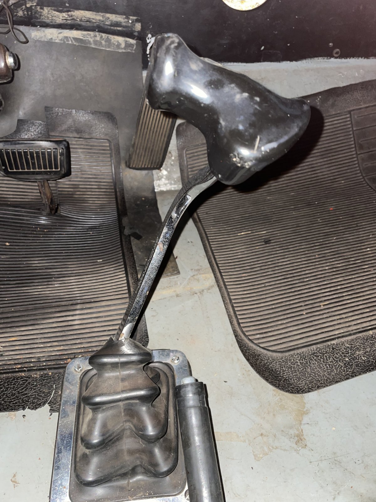

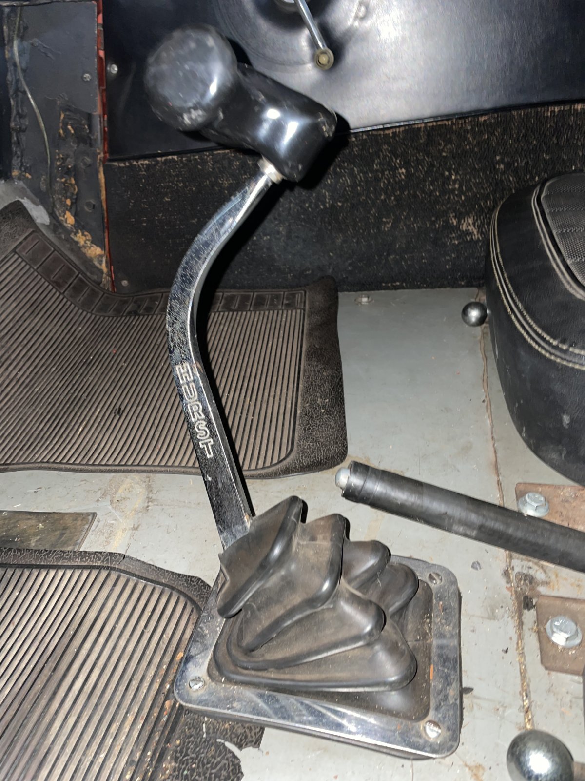

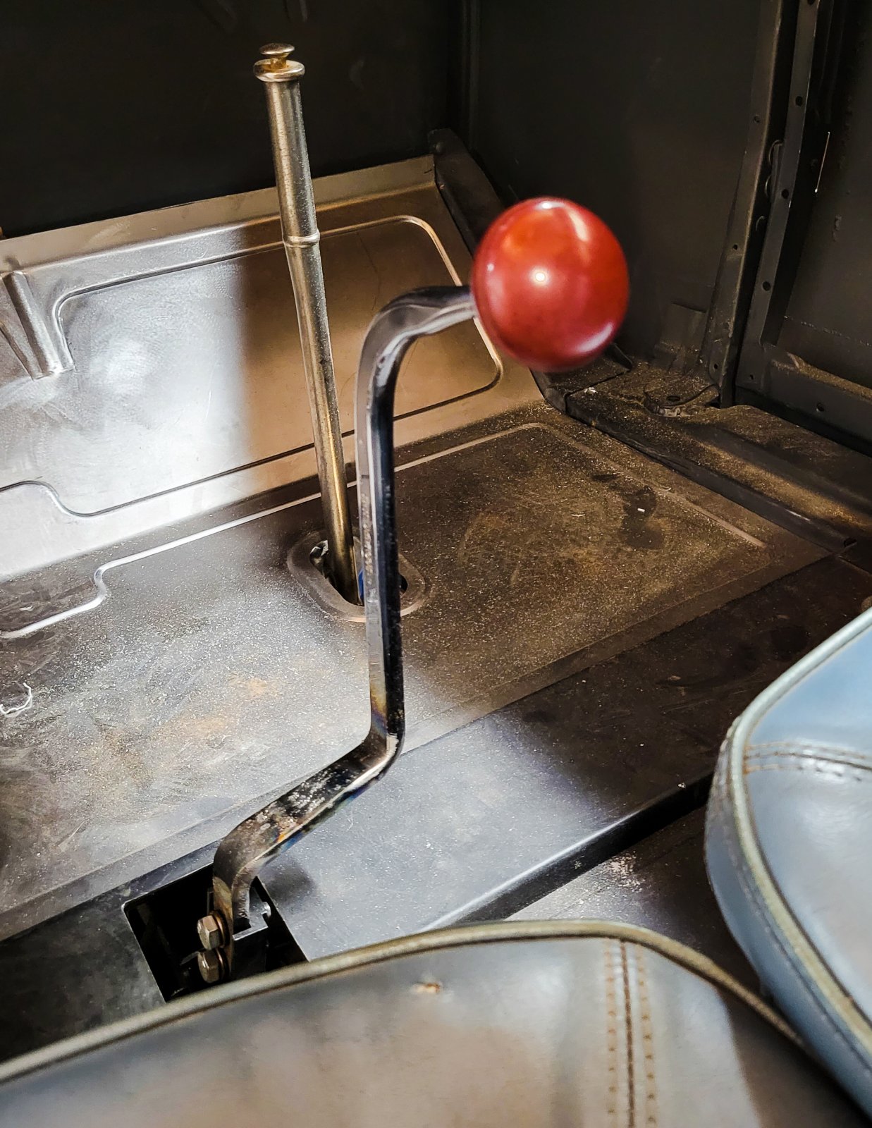

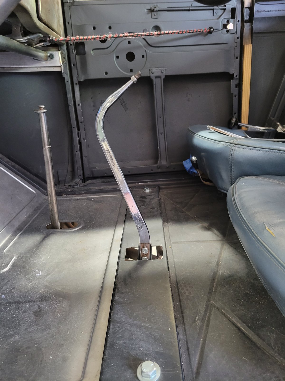

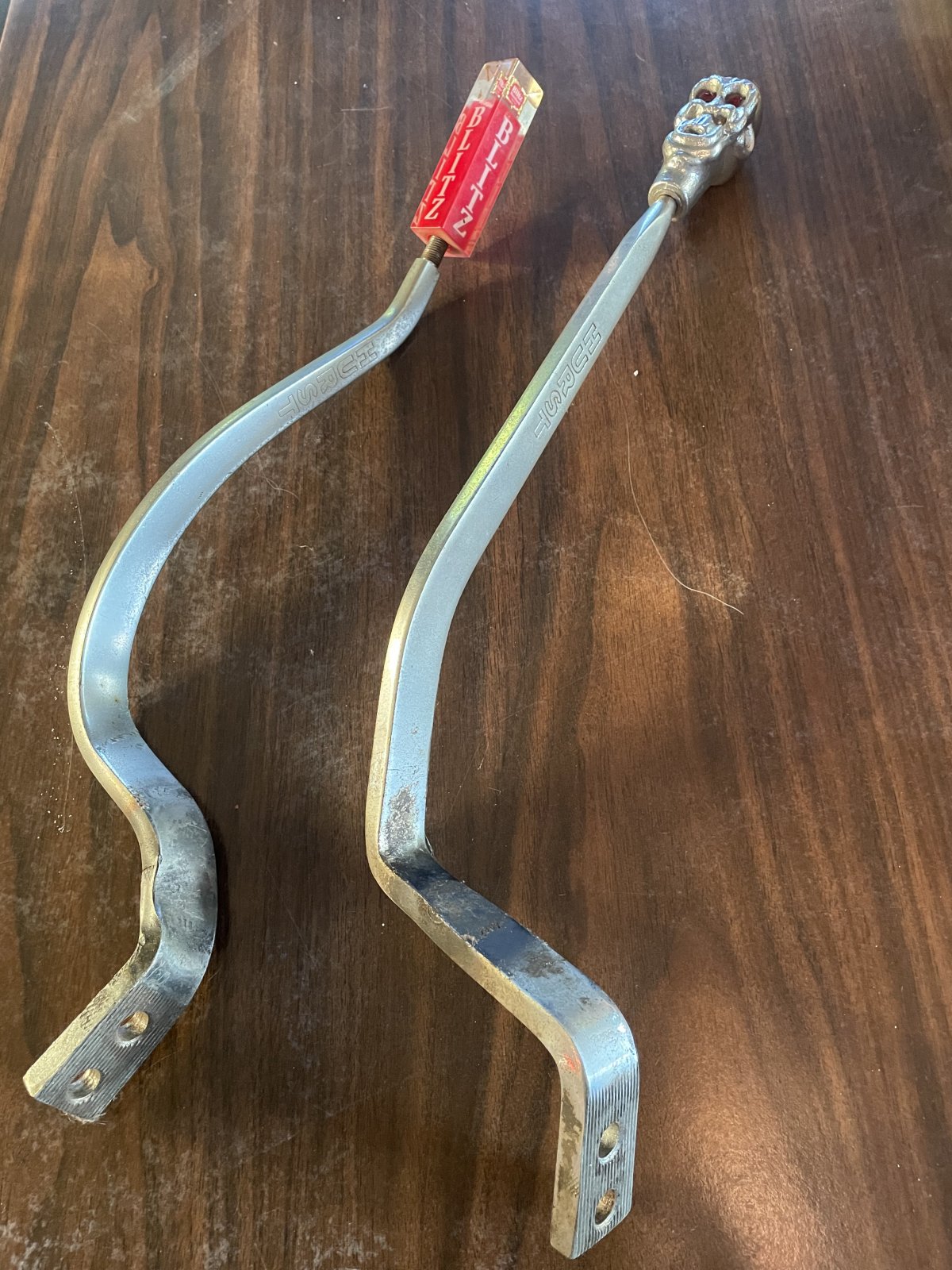

    I’ve altered a few over the years. The one in my coupe puts it just where I wanted it: E403462C-2CA9-4408-AD50-882B8691AE17.jpeg 999957C2-01E3-4E9D-AAED-7AB9FEAD3E92.jpeg FD400040-E17B-4ECE-8D3D-FF0ECF7AEB91.jpeg
