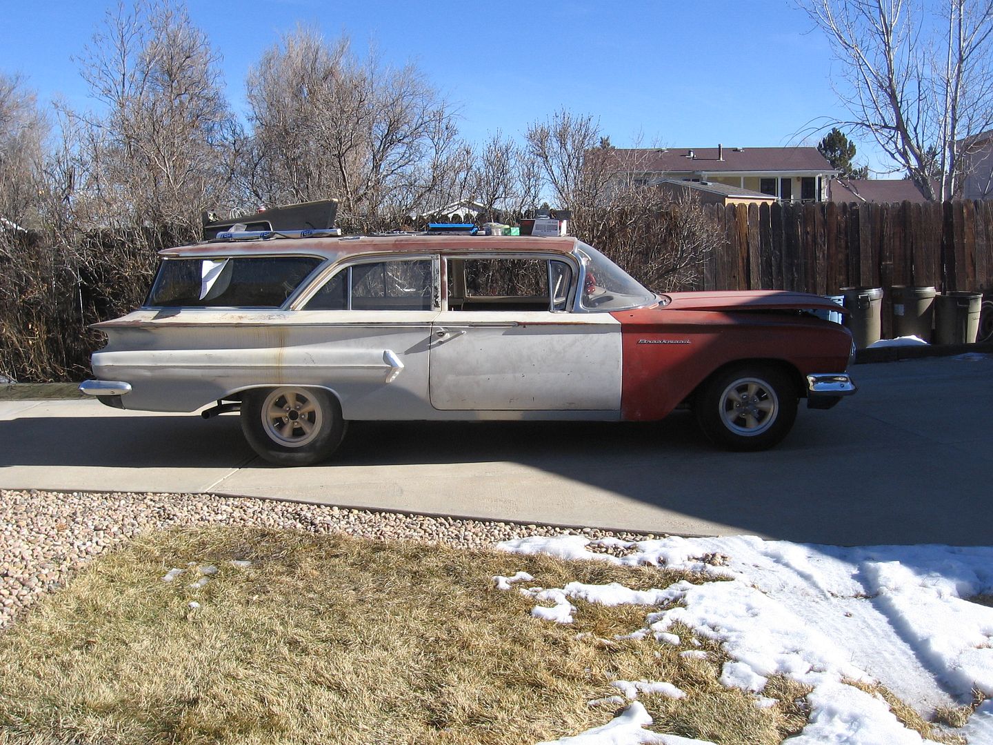

    Update # 18…and the final update…
    So we’ll call this one... “Th-th-th-th-that’s all folks…!!!” as Porky pig used to say a the end of the Saturday matinee cartoon.
    Yep, you read that correctly…19 months after rolling the ’60 in the garage, it’s “done”…well, not completely finished, as you’ll see in this update, but close enuff to say we’re done building it. No, we’re not going to paint it…we’ll run it in its ‘patina’ for this summer, besides, isn’t ‘patina’ the hot look right now…??? Maybe, just maybe, if someone doesn’t step up and purchase the car by next fall, we’ll get after it next winter and throw some shiny paint at it.
    This build was probably the fastest I ever taken a car from ‘junkyard’ status to back on the streets…and of course, I have to thank my brother, Dan, for helping me with the project. He was right alongside me all the time-it’s great to have someone you can rely on for help. FWIW, the majority of ‘building’ this wagon was done on the weekends. Maybe we’ll call this wagon the “76 weekends Special”…!!!
    But let’s not dwell on the end of the updates on this one…besides, as soon as I get license, registration and insurance on this wagon, the ’48 Cadillac Sedanet will be removed from its sleeping spot and rolled into the garage…time to start on that one….again. Yeah, I’ll prolly do a build thread on that one too…!!!

    So, right now, it's been a month since I last updated this thread...so let’s get on with the final update on the wagon. Let’s start by saying a couple of weeks ago we had a catastrophic failure …!!!
    No, that’s a bit too dramatic…and a bit overreaching. Let’s just say the since the engine had sat under my counter for a number of years while we were working on the ’55 Cadillac and then the ’60 Pontiac and finally the ’60 Chevy wagon (this one…!!!), gaskets tend to dry out, especially here in humidity-less ColoRODo. After we’d filled the ****** and moved the car out from the garage, and back in under its own power a few weeks ago, we turned out the lights and closed the door and watched the Broncos get their ****s whipped. With not much else to do on the car except wait until our upholstery guy called us to come get the seats out of his way, there wasn’t much reason to go to the garage to work on the ’60 - we’d gone as far as we could. However, when I did go to the garage and when I opened the door I was shocked to find a flood of red ****** fluid running from under the car to behind the rear tires and all under the car. Damned dry gaskets. It took some time to clean it all up. Worse part, man, there went about $40 bucks running on the floor and two rolls of paper towels…
    So, now we’re back at it…as you can see, we picked up the front seat and mounted it in the car…it looks good.

    The only thing left to do on the wagon now is to take it to the alignment shop and get everything in the front suspension tightened and the alignment set. Once that happens, it’s on to license and registration…then to take it to the local cruise…the first one will be out in my area of town at the Sonic at Hampden and Tower road…we ‘cruise’ from the beginning of daylight savings time in the Spring to the end of daylight savings time in the Fall…the next major ‘cruise’ will be in downtown Golden April First (barring any unforeseen weather…but this is ColoRODo, weather around here can go from 65 degrees at 3PM in the afternoon to blowing snow at 7PM and 25 degrees – seen it more than once around here and Ma Natures’s Spring in ColoRODo is sometimes ruff.
    ANNN-NNN-NND with that, this ends the saga of the 1960 Chevy station wagon build…but, don’t worry, I’ll post some pix of the full interior when that finally gets done…and that won’t be for a couple of months - my upholstery guy is very busy…!!!
