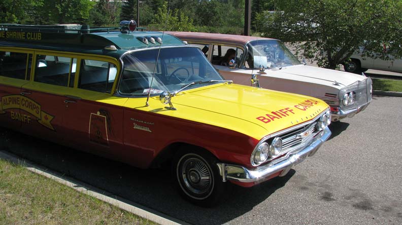

    Just thought I would send you a couple pics to keep you motivated
    (at least you are not doing this more door)

    Thanx Frog, that Banff National Park wagon looks cool...is that yours on the other side of it. I'm looking forward to seeing Banff up close and personal in July...

    No Roger that is not my wagon beside that banff limo...that one belongs to a friend of mine.
    You will love the scenic beauty of banff.
