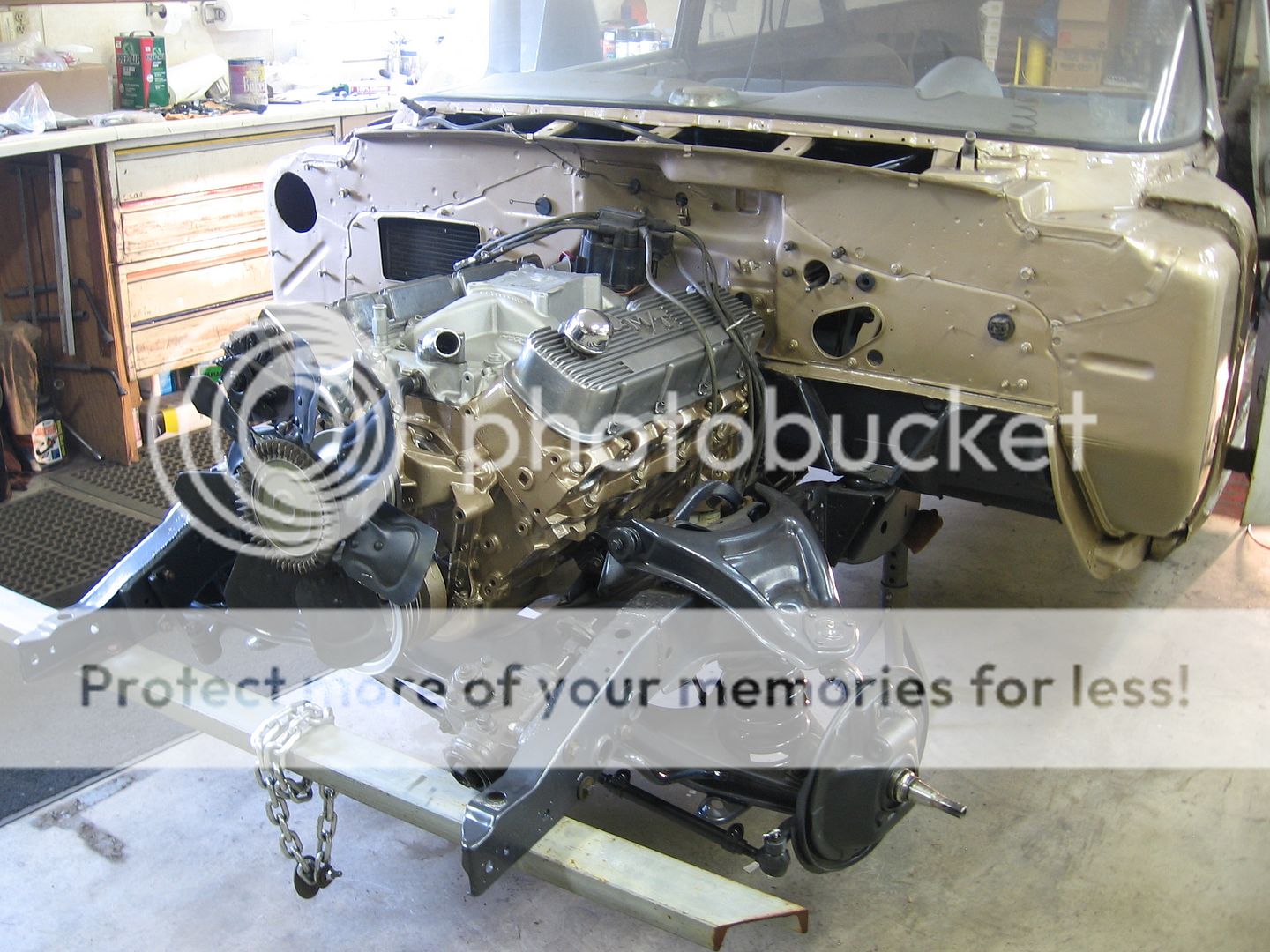

    It didn’t take long to slip the “rat” engine back in…that is, once we got it cleaned up and painted.
    FWIW, here’s a little history on the “rat” engine just so you all won’t think we pulled this engine out of some junk yard POS - I don’t “build” like that. The engine was removed from a ’79 Chevy two wheel drive Blazer an acquaintance had. Said acquaintance was a friend of my son, he’d had the engine and tranny gone thru and then poked it into a two wheel drive Blazer…said it ran like a scalded dog…that is, until him and a pole got into it…took out the driver’s side front end and frame…and he didn’t bother with insurance…!!! Oooops…!!! That’s a definite no-no when you sink more than a few thousand into a rebuild by a pro shop…and have to pay for the pole you took down – the State frowns on ruining their property…!!! According to the Blazer owner, the engine is supposed to have less than 4,000 miles on it. Suffice to say, he had to sell the carcass to pay off some of the accident damage. My son bought the wrecked Blazer from him for $1500…then sold the Boyd wheels (and tires) off it for $750…pulled the engine and tranny and then sold the remainder of the Blazer for $1500, so he ended up on the plus $$ side. Then he said that engine/tranny would be good for the ’60 Chevy wagon…who am I to argue, could I say no to that…??? He said there wasn’t anything he was going to put it in anytime soon so I’d just as well take it and use it, so basically, I got a FREE engine and tranny for the ’60. To top that off, I just sold the extra large Holley carb off it for $200 and will put an Edelbrock carb on it, I like them better and that even puts me on the plus side of the money on this engine.
    So, here’s Dan doing his thing again on the engine…he doesn’t mind cleaning –anything.
    It’s the one thing I don’t like to do…but then again, when it comes to sanding, Dan doesn’t like to do that and I don’t mind sanding a bit…it all works out well when he and I build a car.
    It took Dan a couple of days to get the engine and tranny cleaned up good enuff for me to shoot some paint on it…and an hour or so to mask it off…and about five minnits to spray it…why is it the prep seems to take longer than the actual finish…???
    Ready to shoot some Champagne paint…it’s all shiny because of the “bulldog” paint softener I sprayed on it.
    We covered the top of the engine since the manifold was somewhat clean and we didn’t want to paint it…I went ahead and shot the tranny silver while Dan was cleaning and let it dry before covering it. Once we had the engine all masked off, I shot some “Bulldog” on to soften up the paint and let it set while I mixed up the Champagne color.
    It didn’t take long to cover the Chevrolet Orange…couple of passes with the small gun and the engine and tranny are starting to look new again…have to wait til it dries before we can poke it back in…besides, it was lunch time…!!!
    When we got back from lunch, the paint was dry enuff to slip the engine back into its berth…and hopefully this’ll be the last time it goes in…we’ll see…!!! Never say never…!!! Notice the nice clean manifold on it now…we cleaned it with pre-cleaner and sprayed it with some Eastwood Alumablast color…looks like clean aluminum, doesn’t it…???
    It took all of 20 minutes to set the engine on the stock mounts and for me to crawl under the car and bolt the tranny to the new mount I built. I did manage to put a scratch on the firewall with one of the valve covers…but it’s nothing that can be seen after I touch it up. Would have hated to try to stuff that engine/tranny in over the top of the radiator support and full front clip on the car. Once it was sitting on the mounts, that added enuff weight we could slip the coils into their proper place. As you can see from the photo below, the coils went back in without any problems…

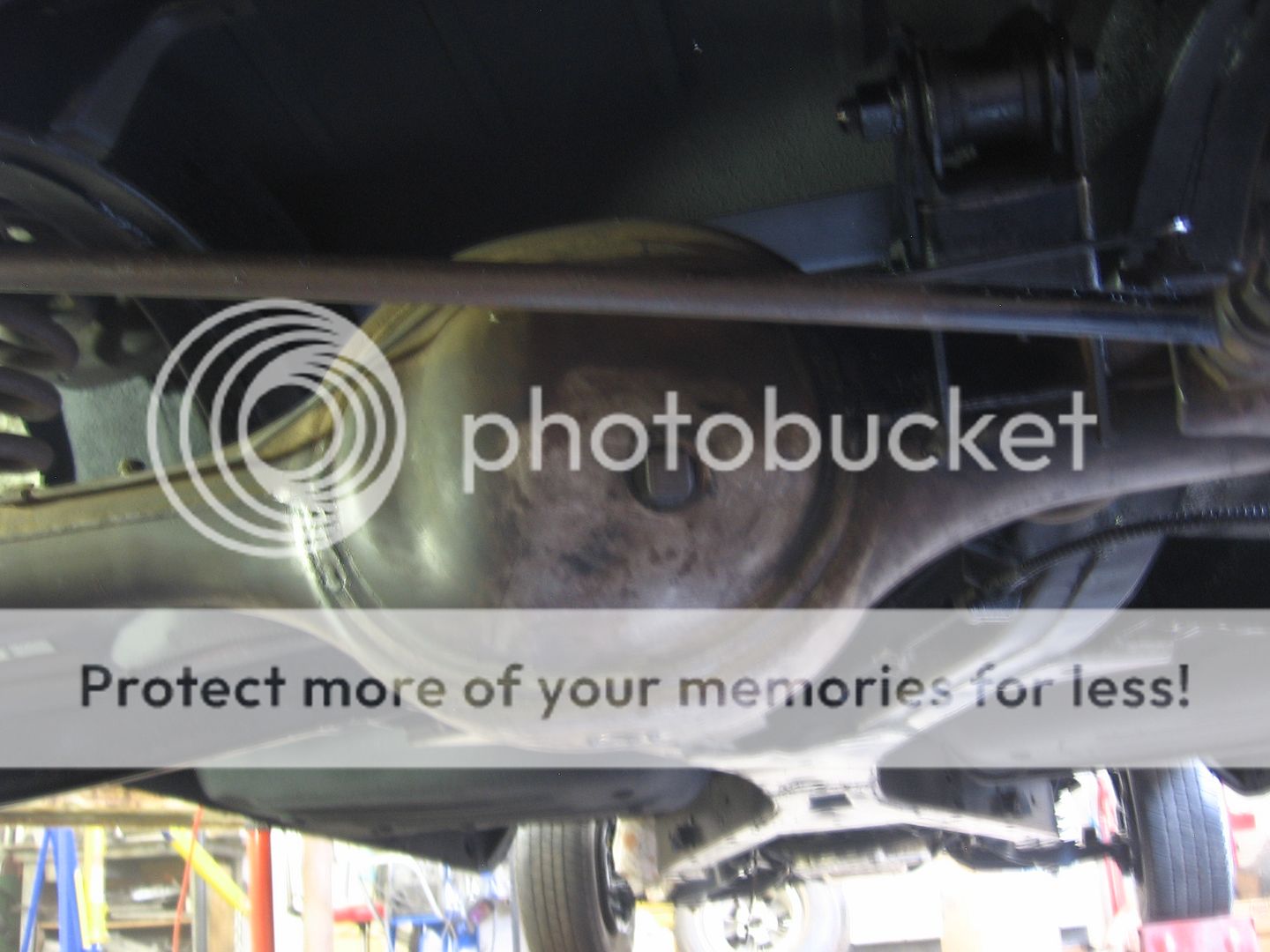

    When cleaning the rearend, Dan “found” the original tag bolted to the third member, he pulled it off but I couldn’t read it, it was too rusty…so don’t know what ratio the rear end is…yet…!!!
    The next weekend we pulled off the old brake shoes (they were down to the rivets) and went and bought new ones…in the meantime, I sent the drums out to be turned since the shoes were worn badly, figuring I’d have to round up some ‘new’ used ones, maybe off that ’60 at the junkyard…or spend some $$ coin to buy new…ugh…and wow…those babies are not cheap. However, word came back that there was enuff metal left to turn them, so spending big bucks again went out the door…
