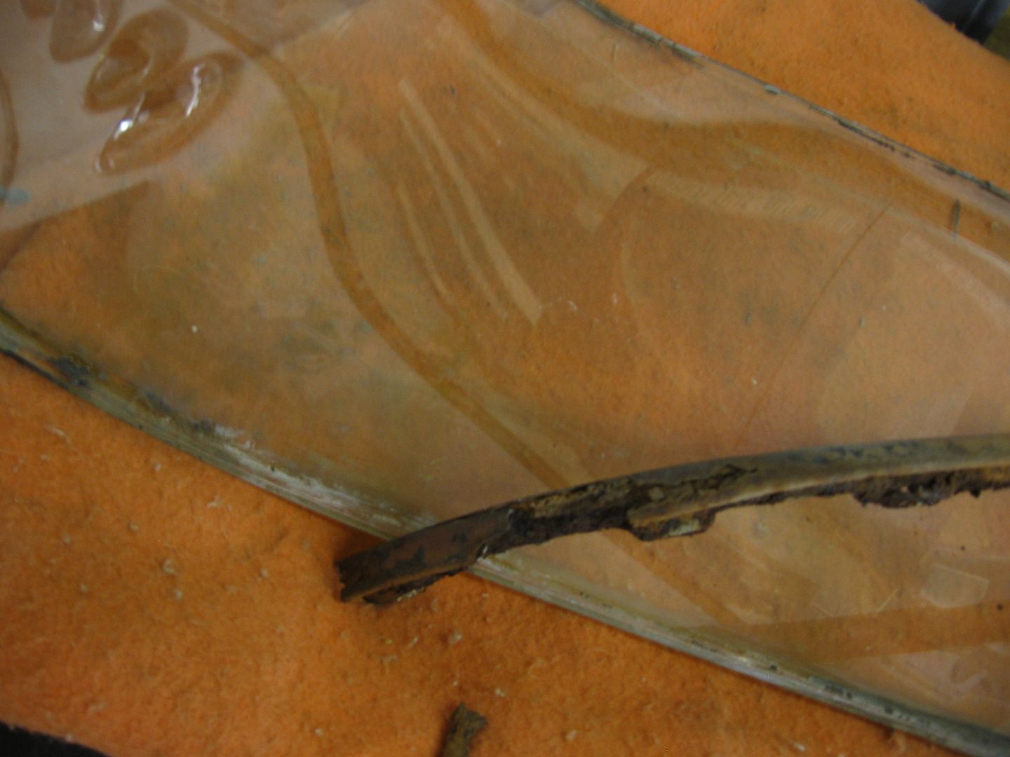

    Yesterday I removed the curved side quarter glass because the metal trim holding in the glass was rusted badly...under it, it is rusted as well. I'm going to use it on that to stop it from rusting under the rubber gasket before I put the glass back in.
    Bad news, eh...??? Fortunately I know where there's replacements, including the curved glass.

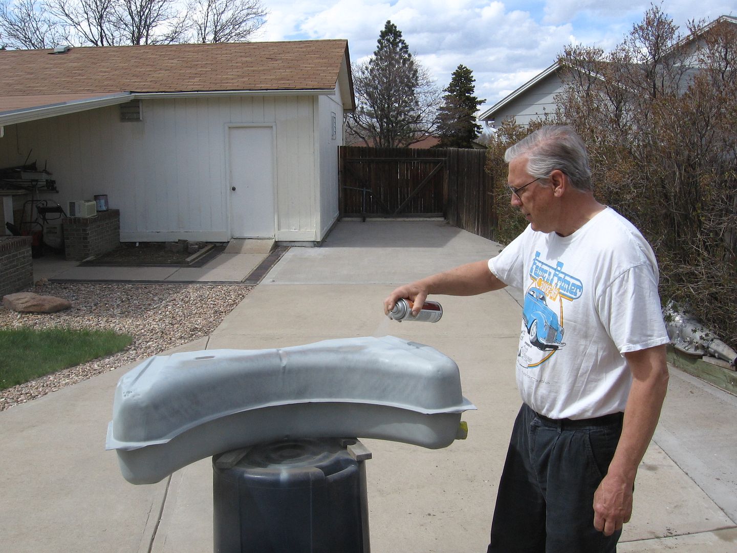

    Since we got the Lizardskin (and the rest of the undercoating) done on the bottom of the car, Dan grabbed the gas tank off the counter and asked “Are we ready to put this in…???” We’d gotten it back from the gas tank guy a couple of weeks ago all sealed up but still needed to sand it and paint it. Of course, Dan likes cleaning things so he took the tank outside and sanded the rust in anticipation of spraying on little primer and a little silver paint on it.
    Dan sanding the rust so the primer would stick.
    And me handling the primer job and the paint job…
    We let it dry a few hours and then proceeded to put it back in its place…wasn’t hard at all, but of course, we did replace the very hard rubber flexible hose that was originally on the fill tube…Ya know, there’s a gripe of mine…you can’t go to an auto parts store and buy as many inches of rubber gasoline hose like you used to - now it comes in a 12” section, in a package…and it’s not cheap…so even if you only need 5 inches, like we did, you’ve gotta buy a package and cut it, then you’ve got an extra seven inches of hose laying around you’ll prolly never use again. I guess that's a "gotcha" these days...
    It didn’t take long to slip the hose on and tighten the clamps down and cinch up the straps that hold the tank in…

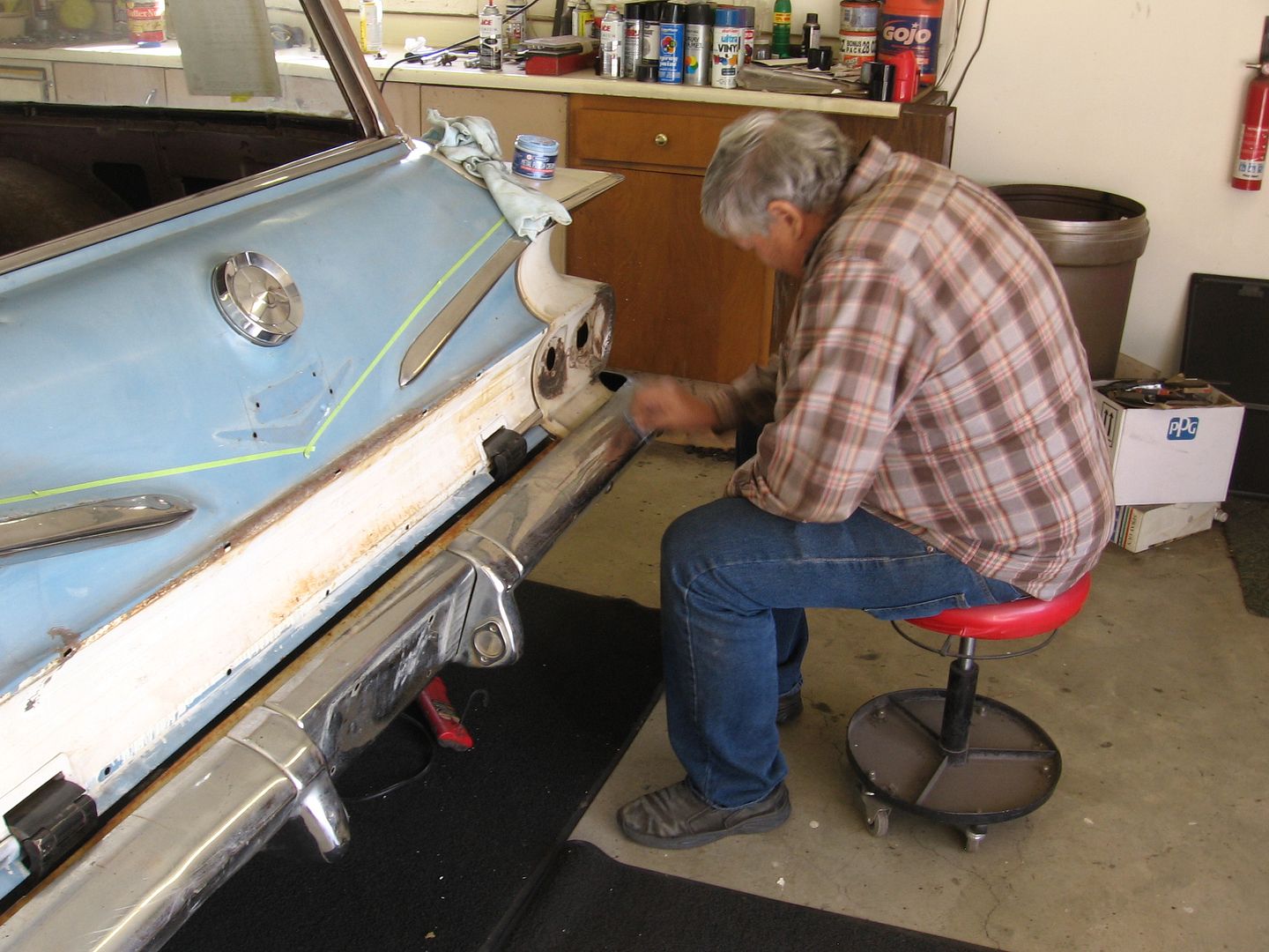

    And here’s Dan just starting to polish the bumper.
    Now all we have to do is find the rear valances and clean them up…we’ll leave them in dark blue paint…but we noticed they were once white and under that Antique Gold…so those valances have been on a couple of cars…or have endured some paint jobs over the years…but with all that paint on them, they won’t rust out for a while anyway.

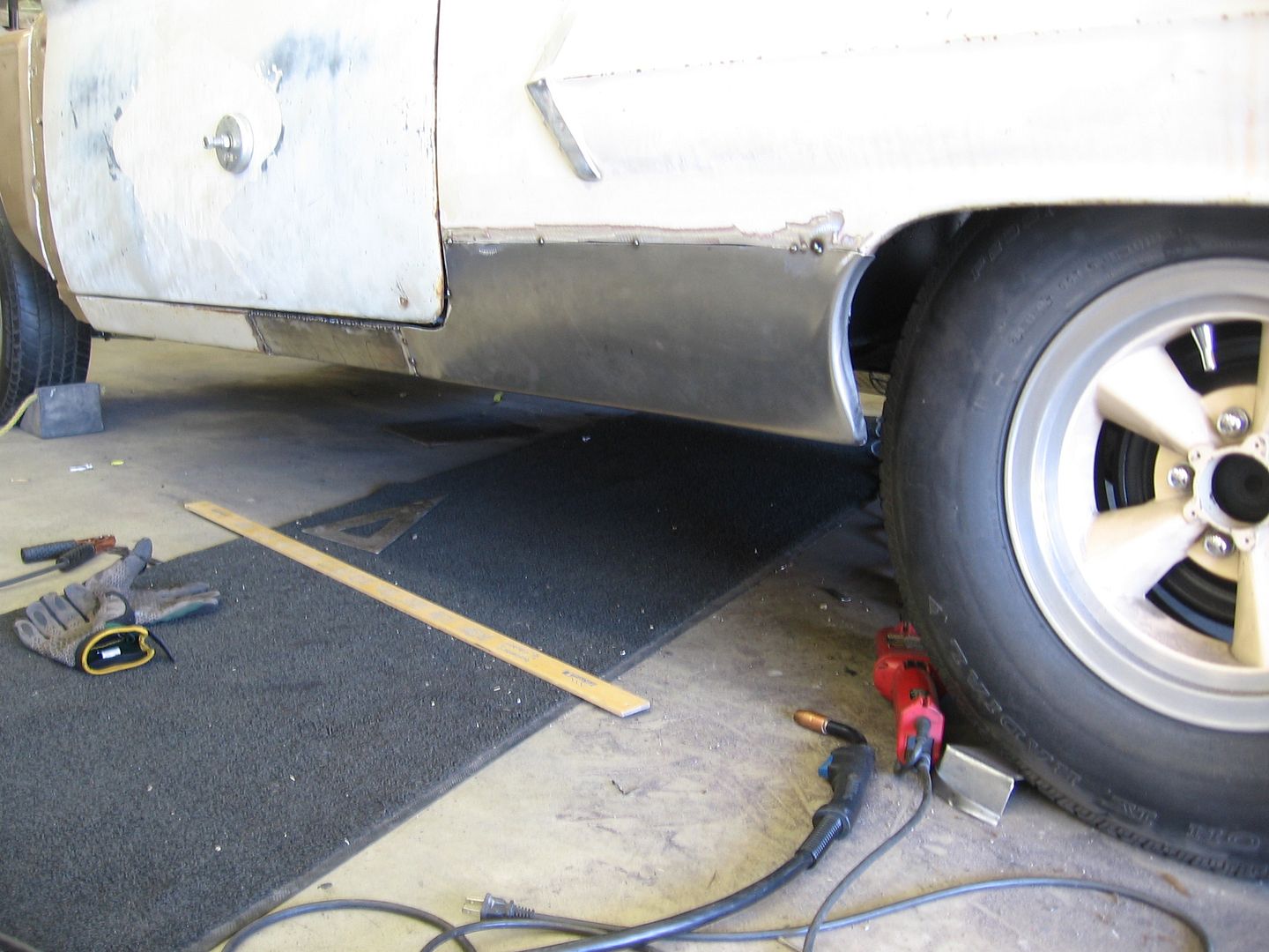

    After we had the tailgate in place, I decided maybe I’d better tackle the last remaining piece of metalwork on the car…and that’d be the partial quarter, behind the door and finish the rocker. I’d replaced the inner structure a couple of weeks ago in anticipation of welding in a new handbuilt rocker.
    Here you can see the inner rocker structure replaced. I had to do it in two four foot sections cuz my pal couldn’t fold a “z” shape into it in longer sections…four foot was his max.
    But first, I had to have a piece of sheet metal measured, cut and folded to fill the gap in the rocker. So when I got that in, I could figure out exactly where the bottom of the quarter panel should sit. Sure didn’t want it crooked. I made a cardboard pattern, then trimmed out a piece of sheet metal, marked it for folding then cut off 2 inches of the rocker to send along with my metal so it could be folded to the proper angle. It came back the next day so I welded it in…
    With the rocker healed, I could fit the partial quarter. I trimmed it to the size I needed and temporarily tacked it in place to see how it was going to line up.
    Looks to be good enuff for me and the girls I go out with…not that they’d ever care if it was slightly crooked…but my bodyman sure would…!!!
    I’ll come back and finish welding it in later…
