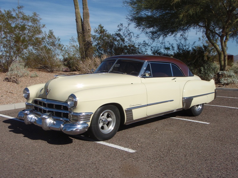

  2. 1949 caddyman
    Joined: Jun 30, 2010
    Posts: 225
    1949 caddyman
    from arizona
    Wow great condition. All the glass there. I got mine that had an older resto 8-10 years ago. I put later model drive train in it & have put 33K miles on it. Its going to the LA roadster show in 8 days.
  3. 1949 caddyman
