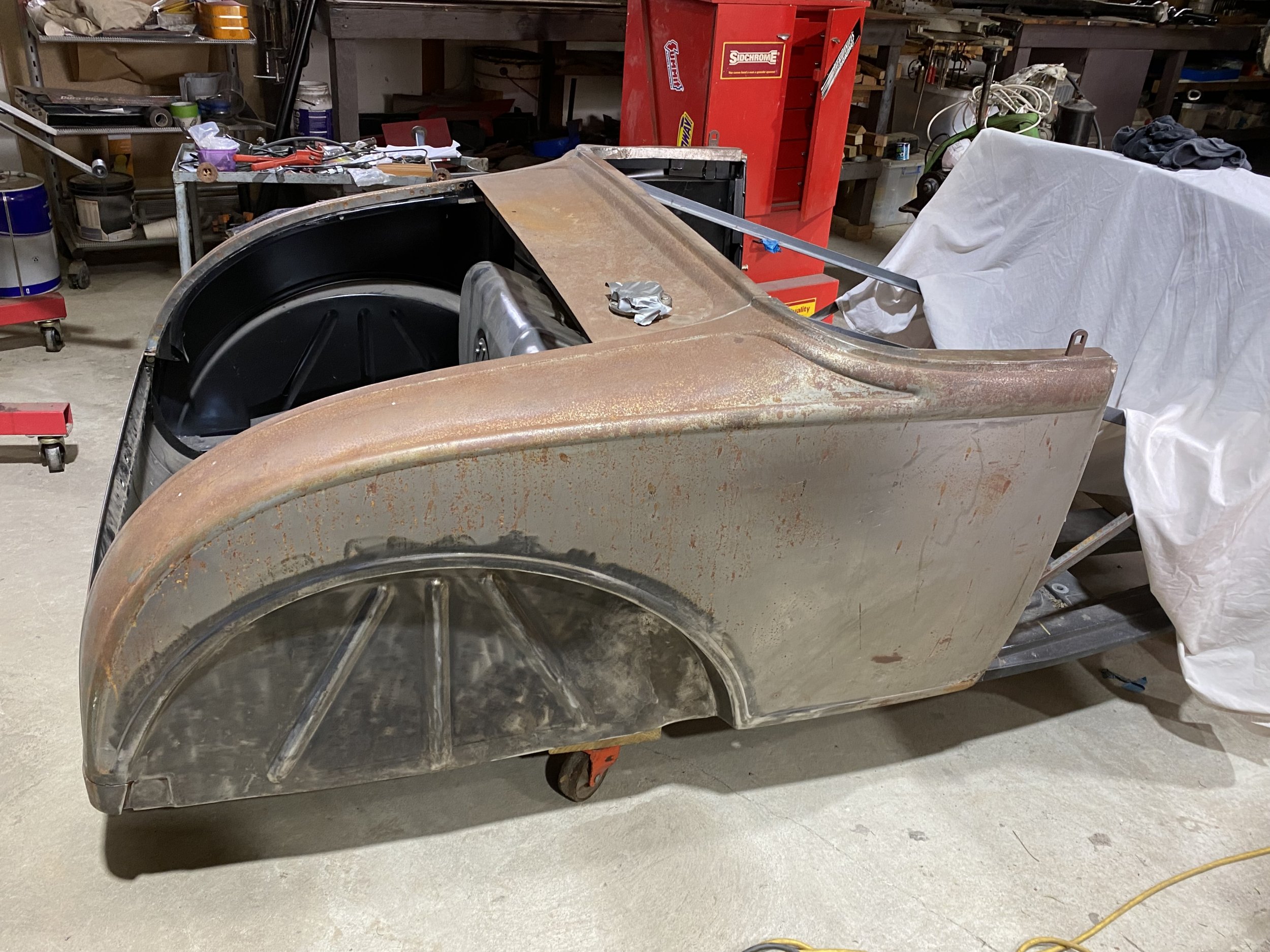

    This a car l brought a while ago. Credit to the previous owner and bodywork guys as it’s a really nice body which needs minimal work.
    Original cowl and doors with a repro steel rear.
    I am going to run the chassis it came with but will have to box it due to engineering requirements down here.
    It’s already stepped up a little at the rear and running a dropped original front axle. AB17F14F-41C1-430F-9F5D-71E48E7B6232.jpeg

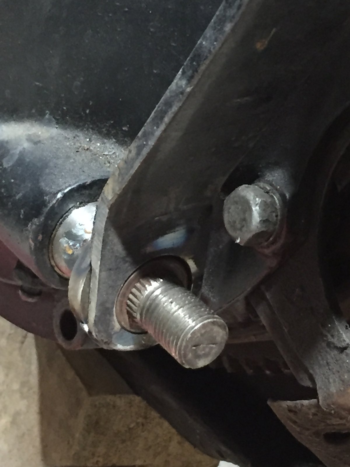

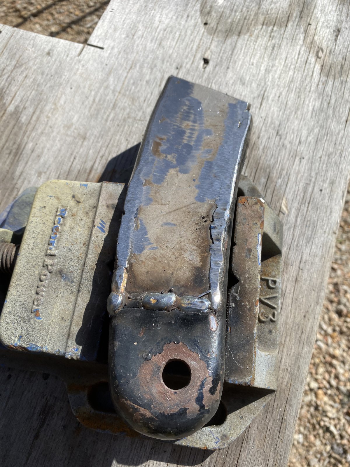

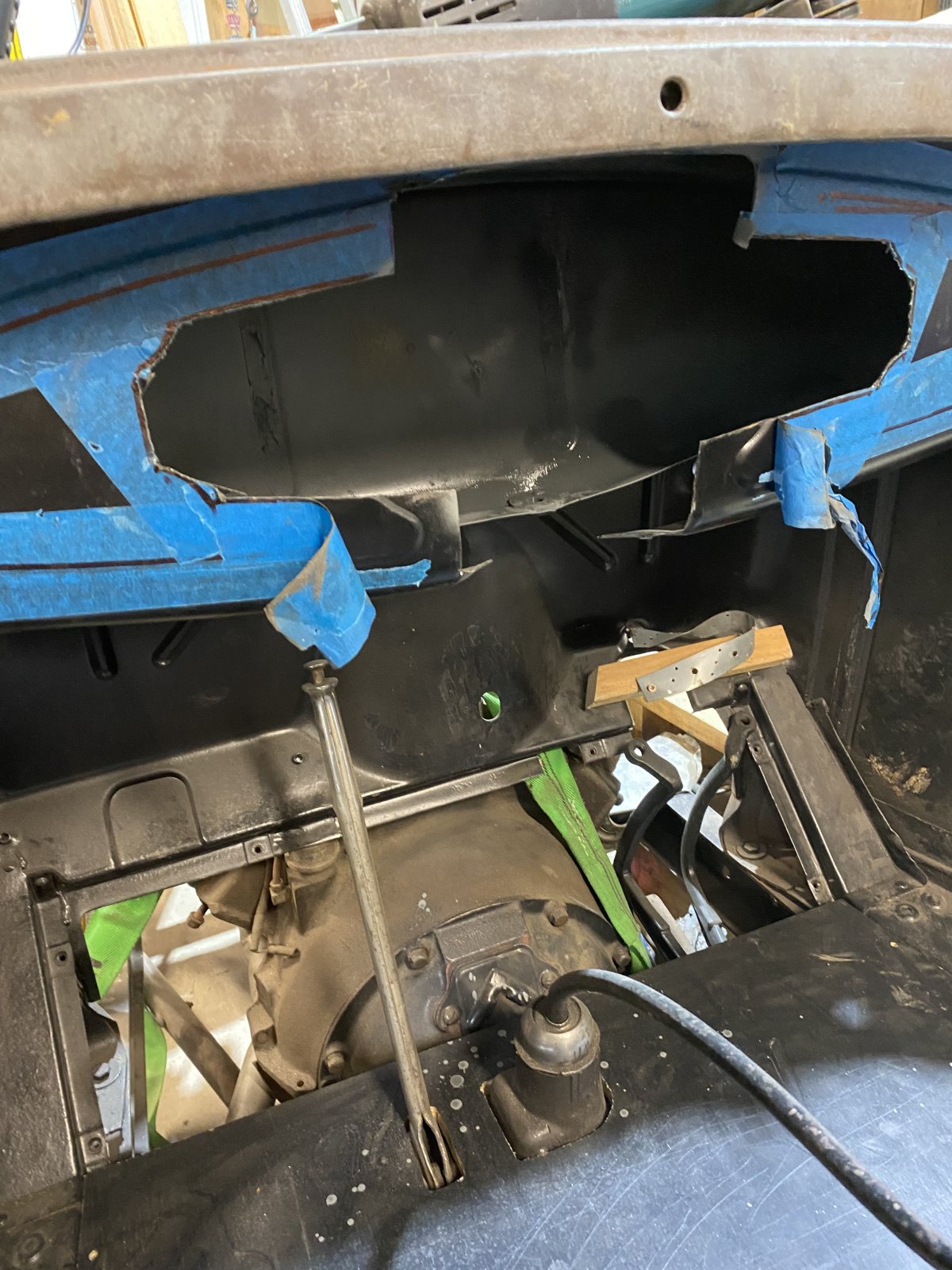

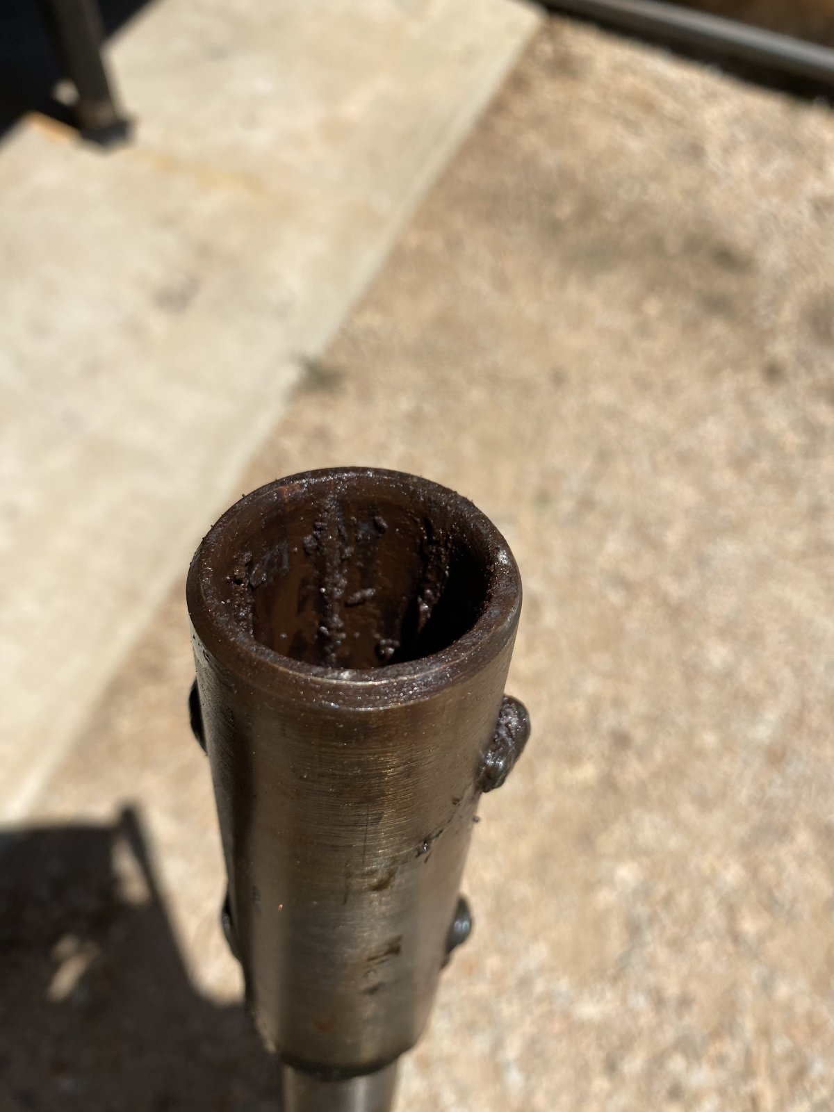

    Will be running a 39 box with f1 style pedal assembly and mechanical linkage.
    I used a splined shaft from a mower deck which l was welded to the clutch shaft ,some machining involved but really simple.
    It gives you plenty of scope to position the clutch actuator lever in the desired position
    I did this on my 36 , works well 80F6F25D-EC40-415B-B6DA-0AF27F7CF7EF.jpeg 57AAAF32-CB14-449B-90D2-85C2E98BC1F5.jpeg D54B9DCE-2101-4E86-8B07-D2601CAD4904.jpeg [

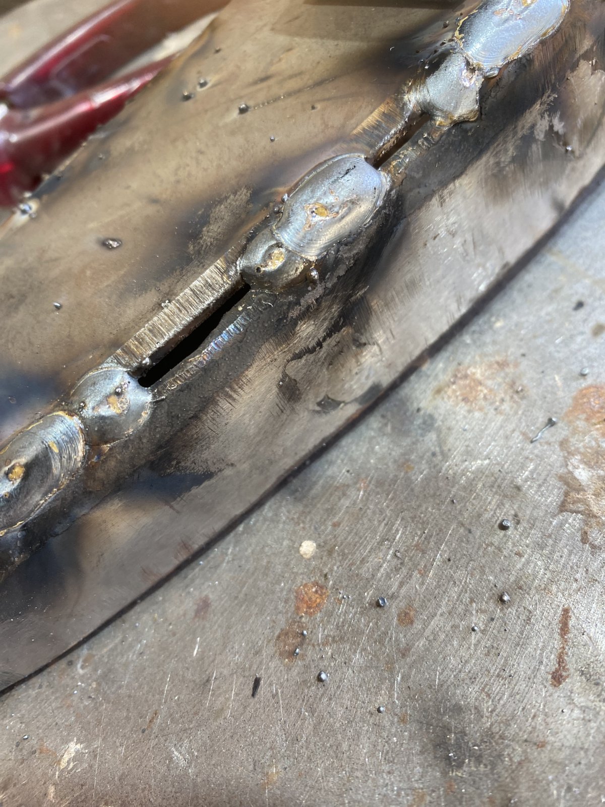

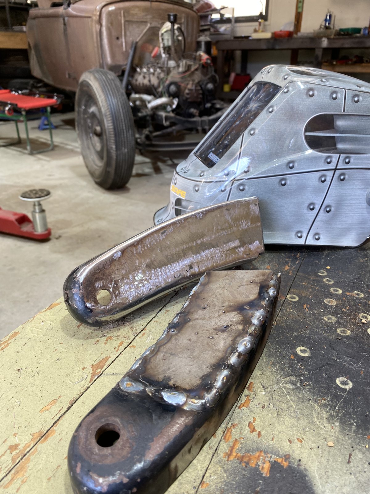

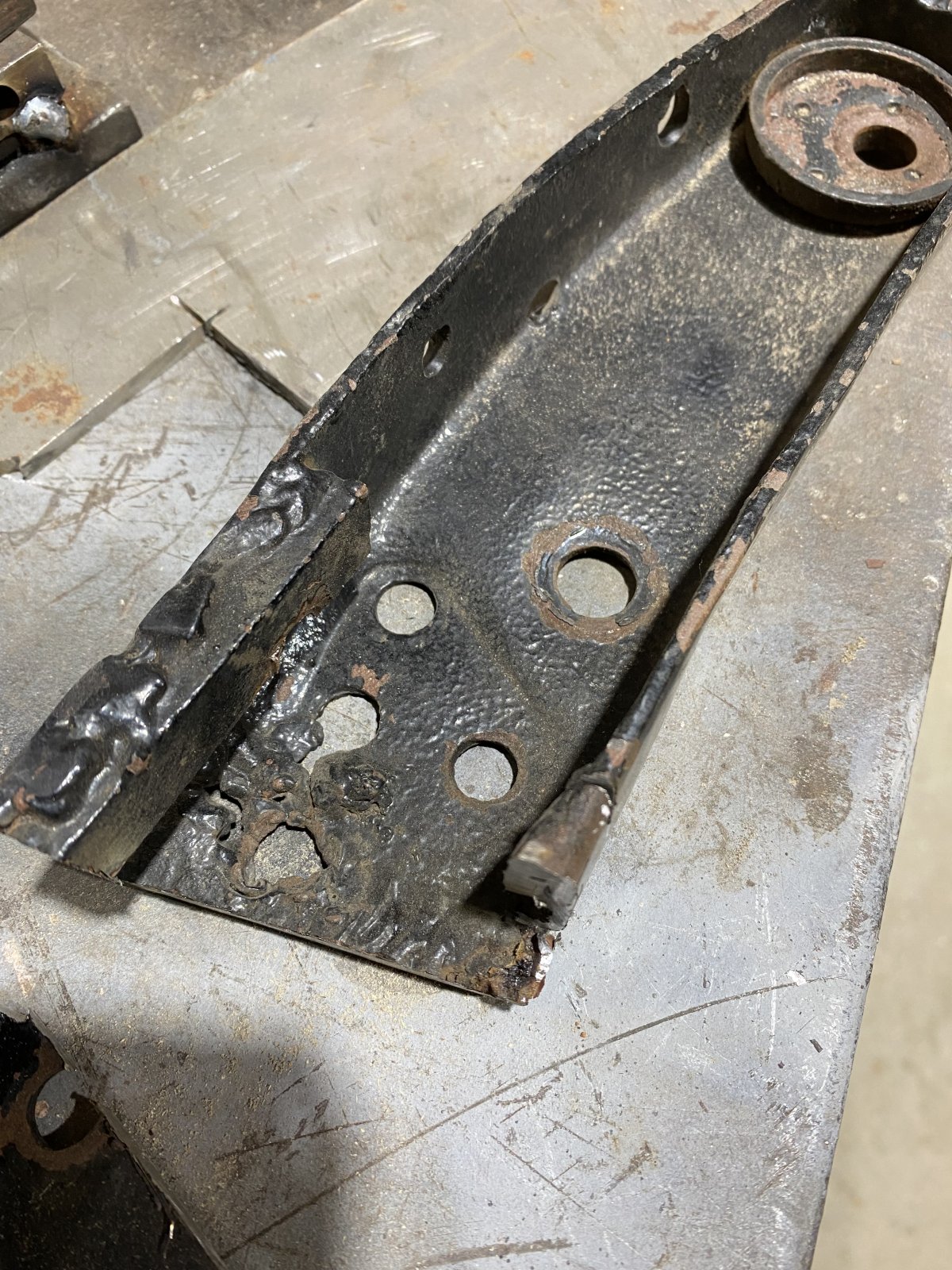

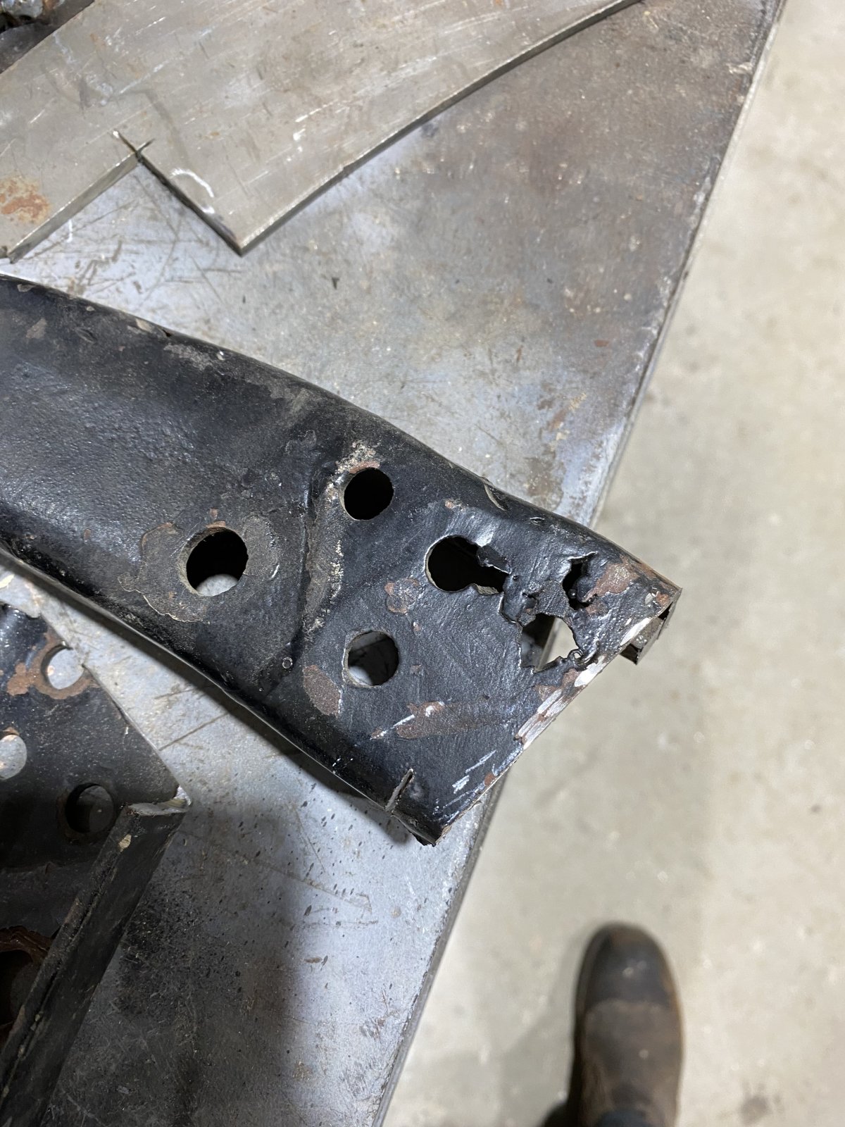

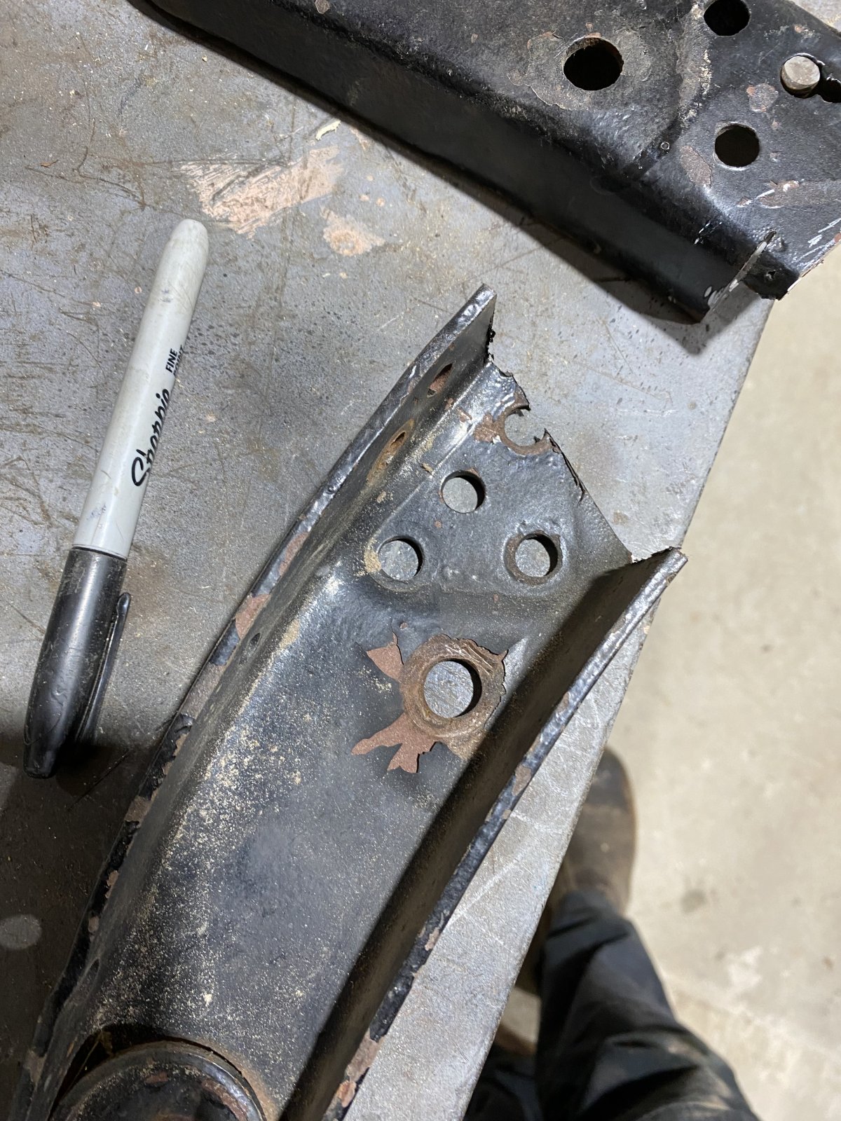

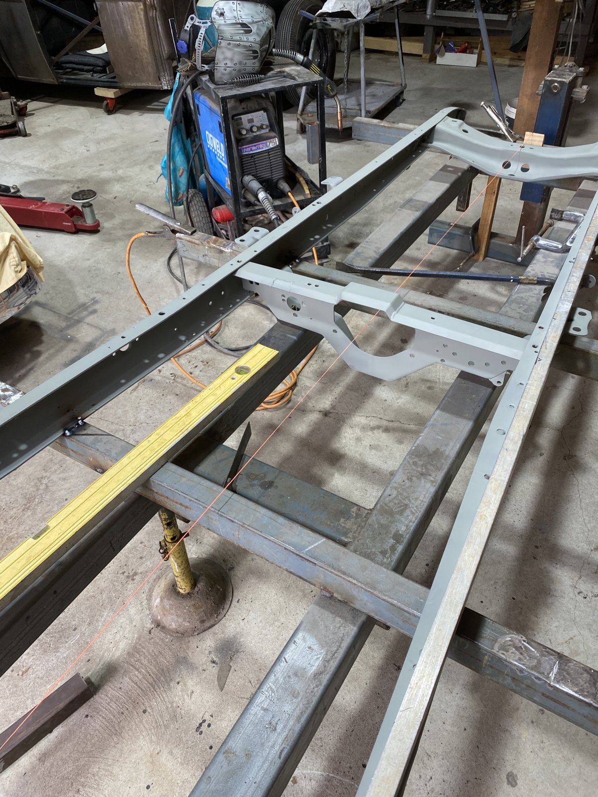

    Frame horns were knocked around generally so l am in the process of fixing them up

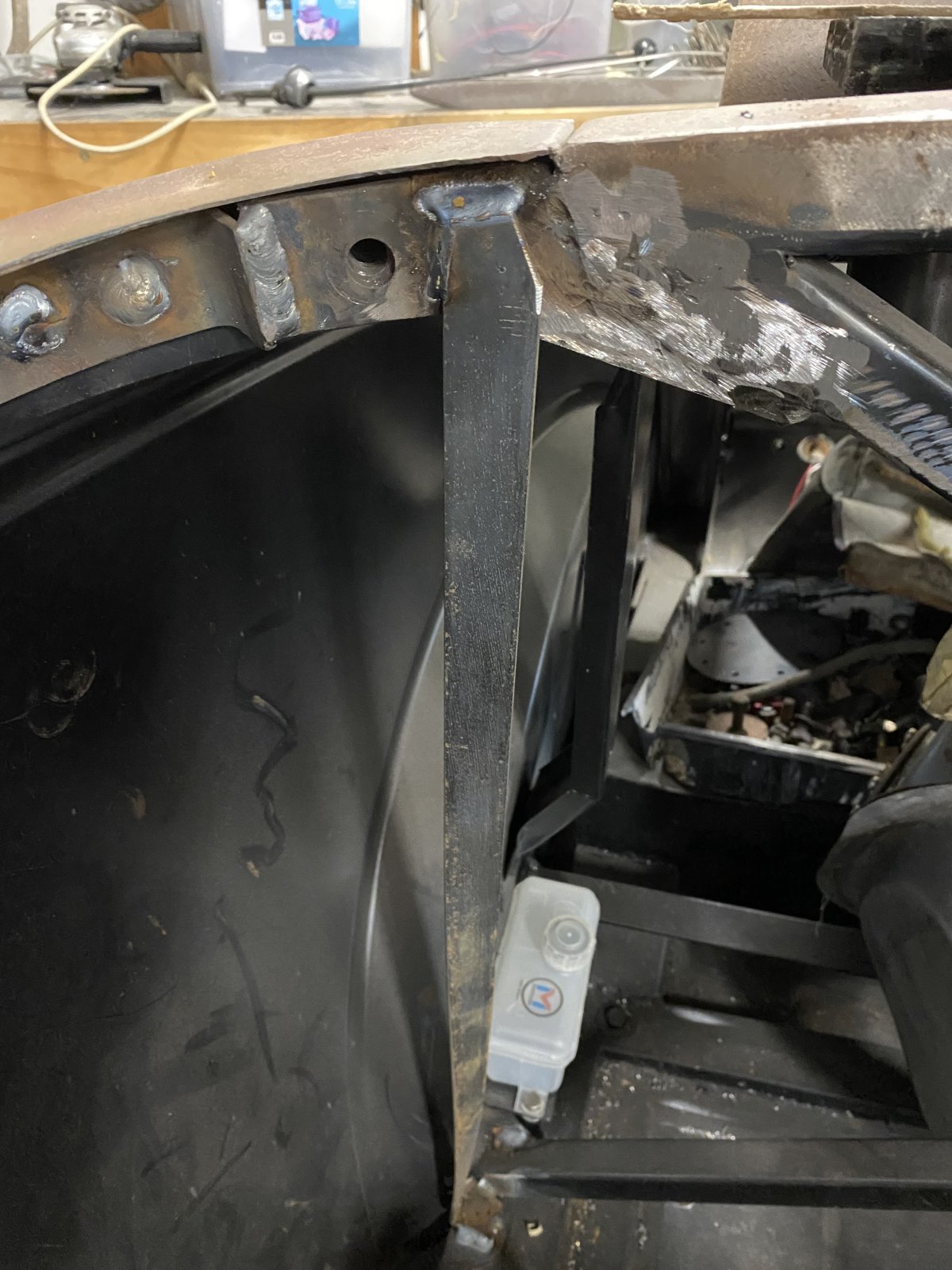

    Back into it

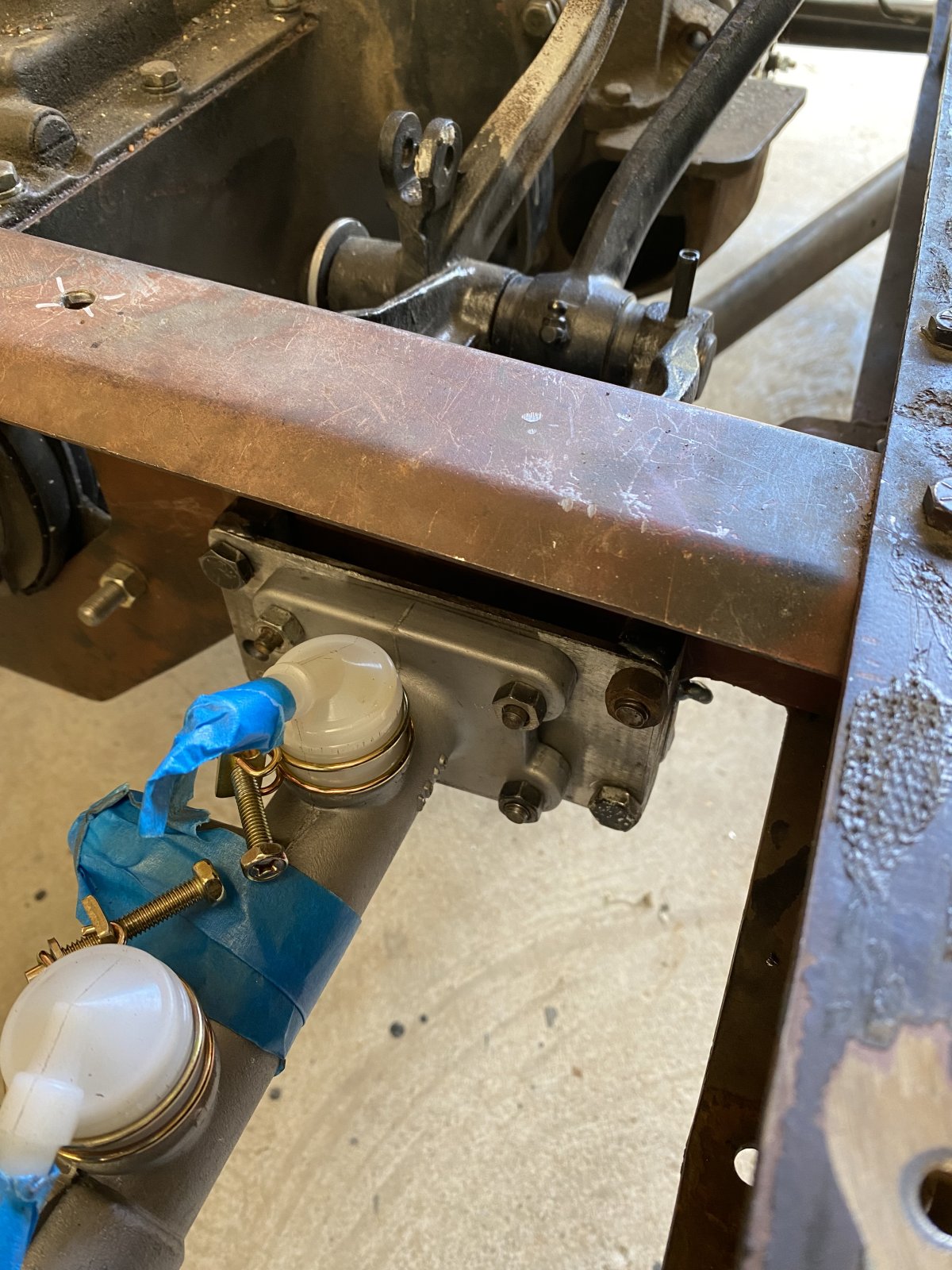

    Going to run a tandem m/cyl with remote reservoir accessible through boot/trunk.

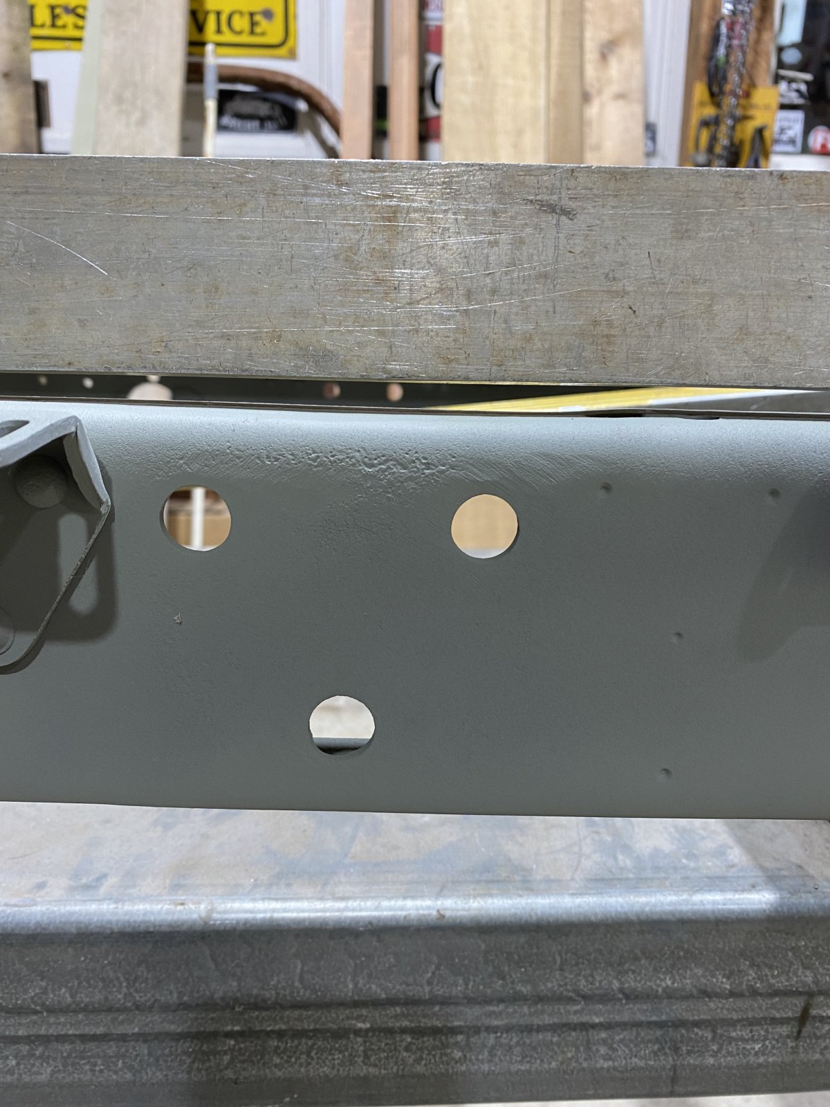

    Was thinking of retaining the original cross member but l don’t think it will be required

    Stripping frame down to sandblast
    I was bouncing around the idea of not blasting it in an effort to try and retain its patina/history /vibe but the reality is by the time l have boxed it and welded up excess holes what’s left of the old paint will be a mess .
    chryslerfan55 and oneratfink57 like this.

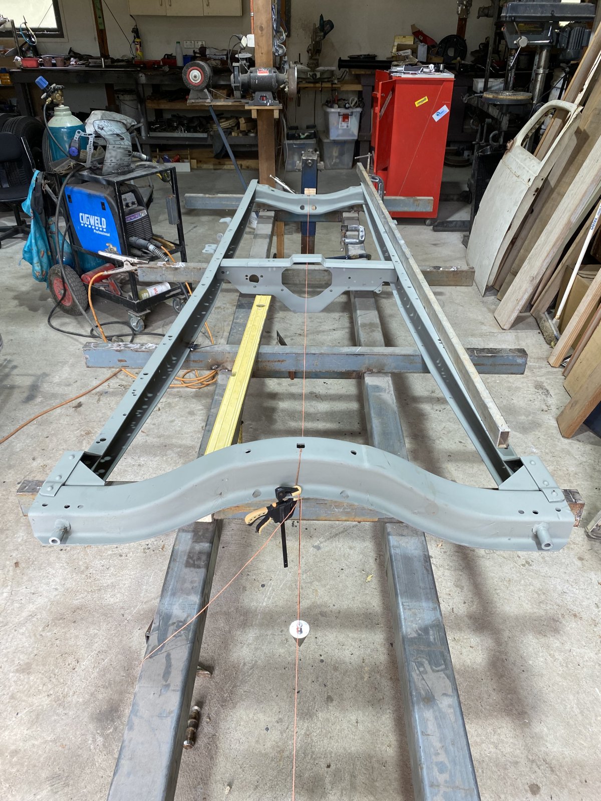

  16. wandi harry
    Joined: Jul 19, 2008
    Posts: 341
    wandi harry
    Back into it again

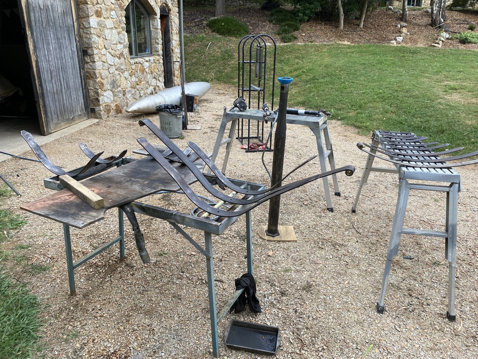

    Dragged the chassis table down from the loft , got it might as well use it.
    Frame is in really good condition as far as rust but did have a reasonable bow in it , measured 5/16 in the middle, l have taken most of this out with a bit of “tweaking “. Heat and pulling.
    Get it straight, fill some holes then box it

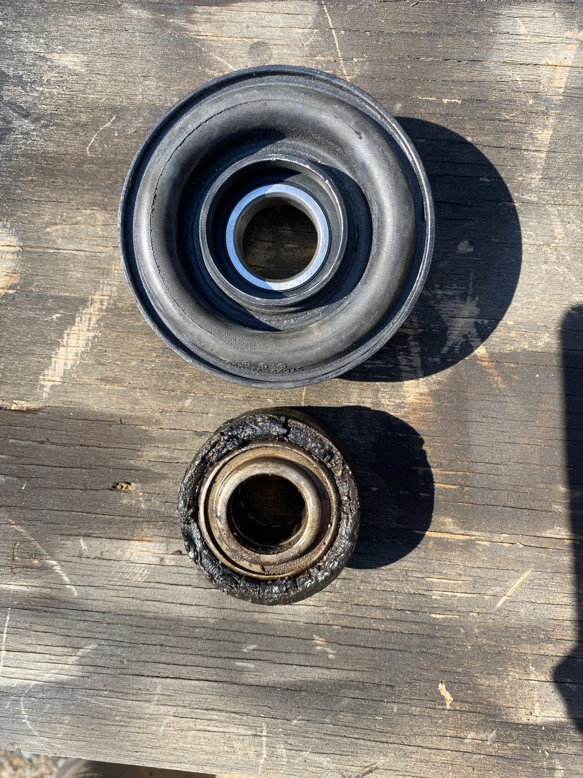

    Trying to come up with a new option for the torque tube centre bearing, experimenting with modern centre bearings

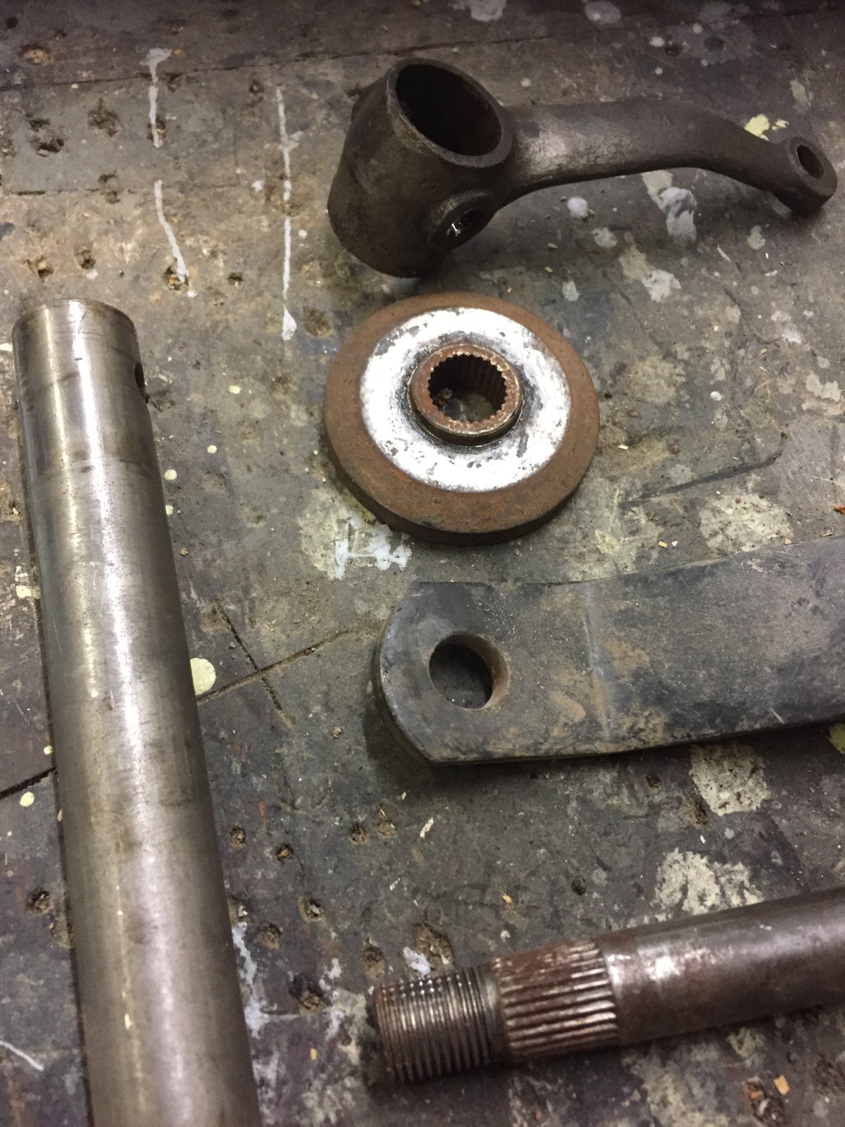

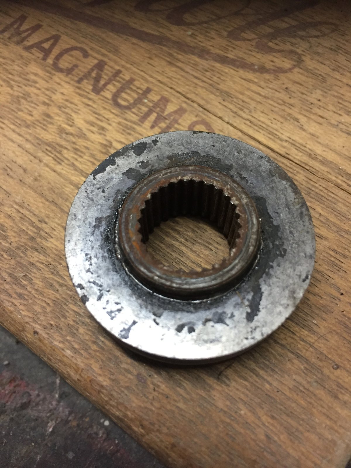

    IMG_6725.jpeg IMG_6634.jpeg IMG_6458.jpeg The splined coupler was totally screwed

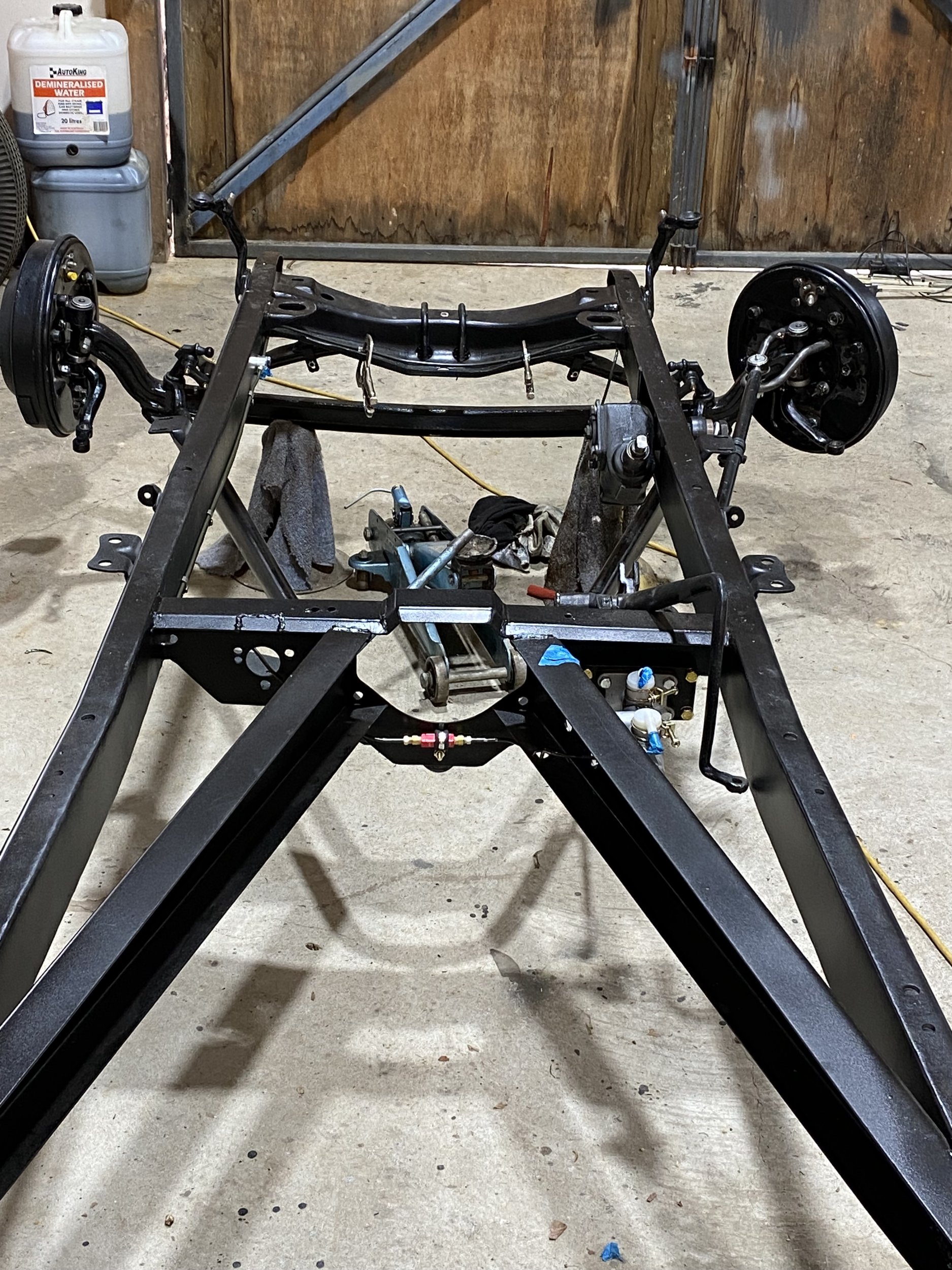

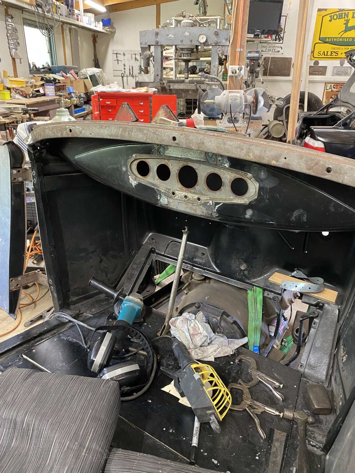

    wandi harry

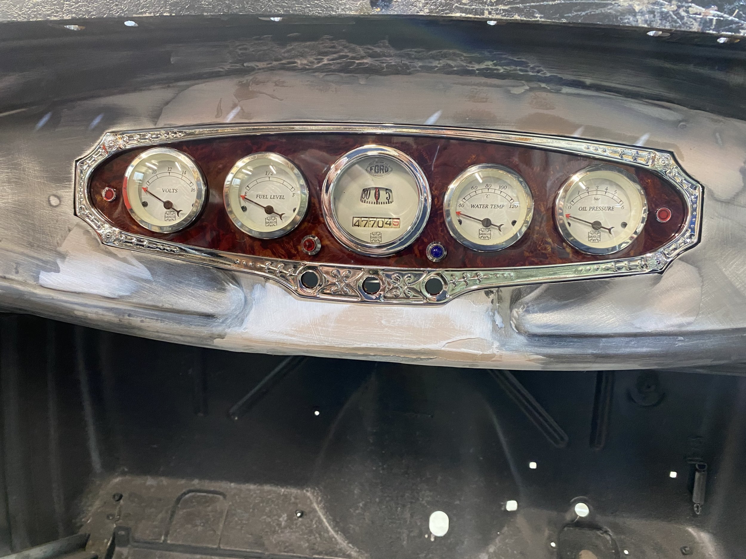

    IMG_7601.jpeg Really happy with the gauge panel, poor man’s options, el cheapi gauges , popped of the gauge glasses and put a cooler logo on them

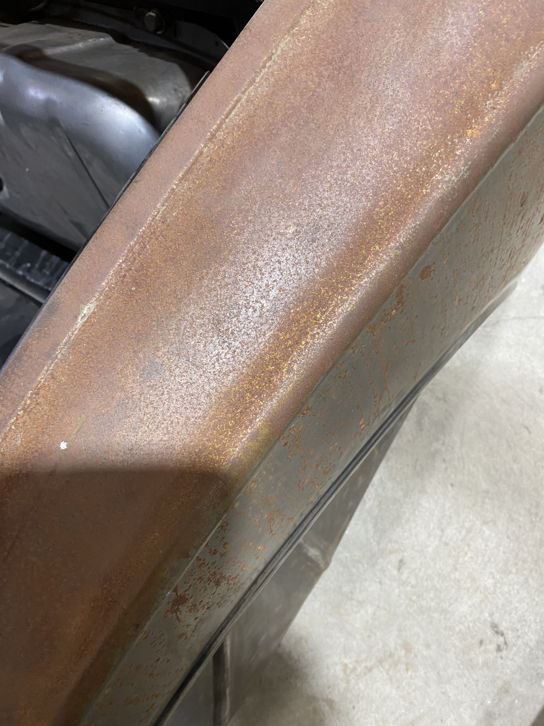

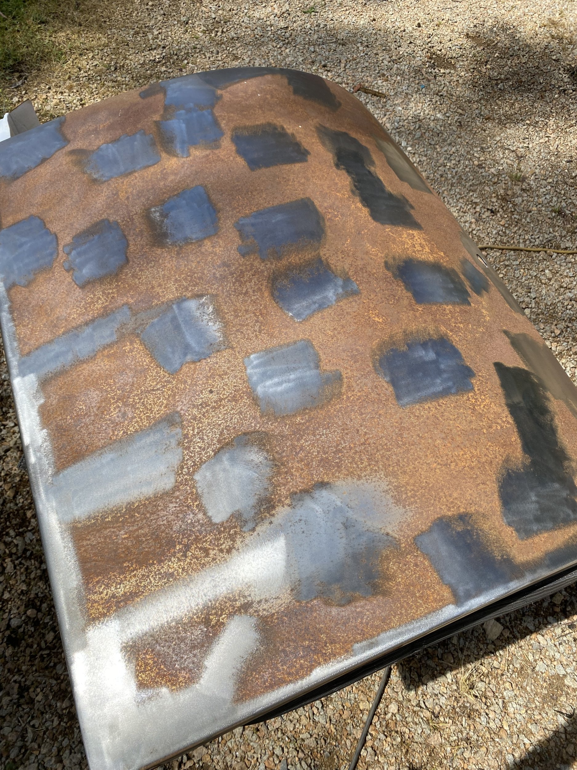

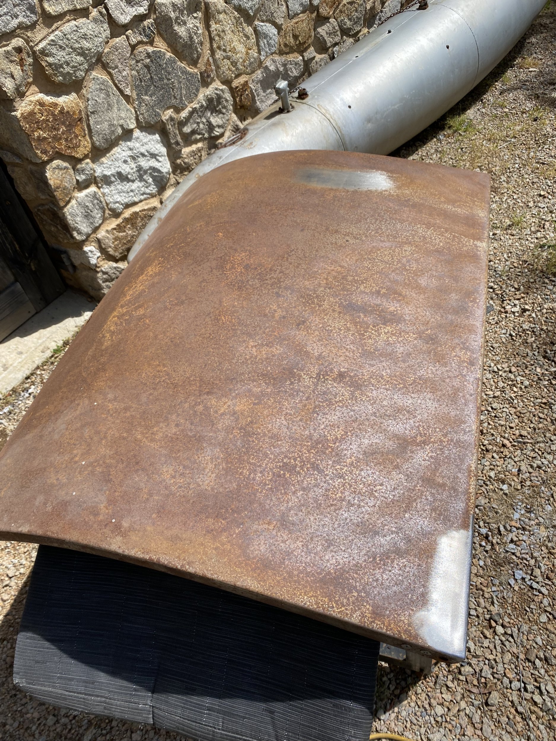

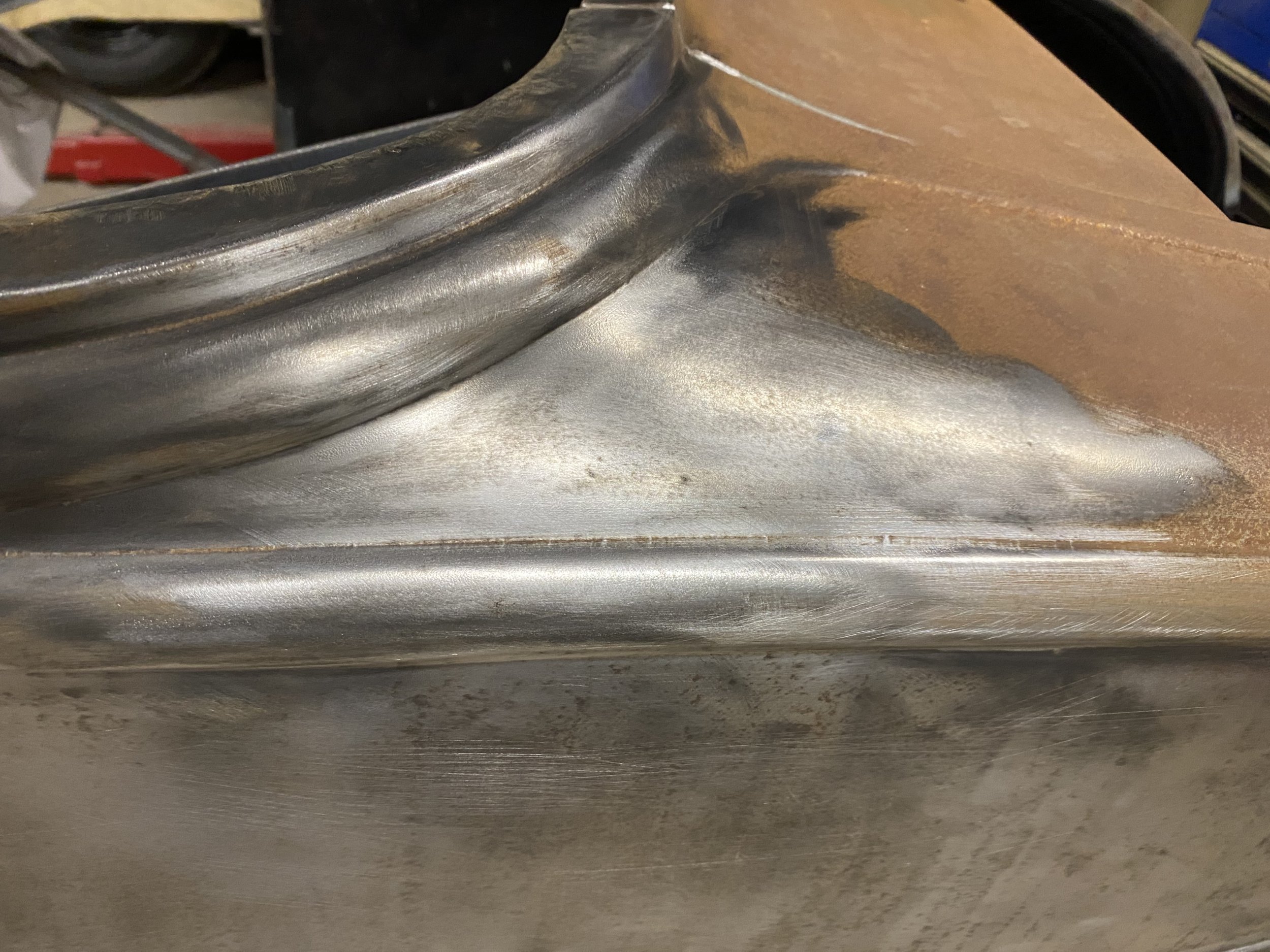

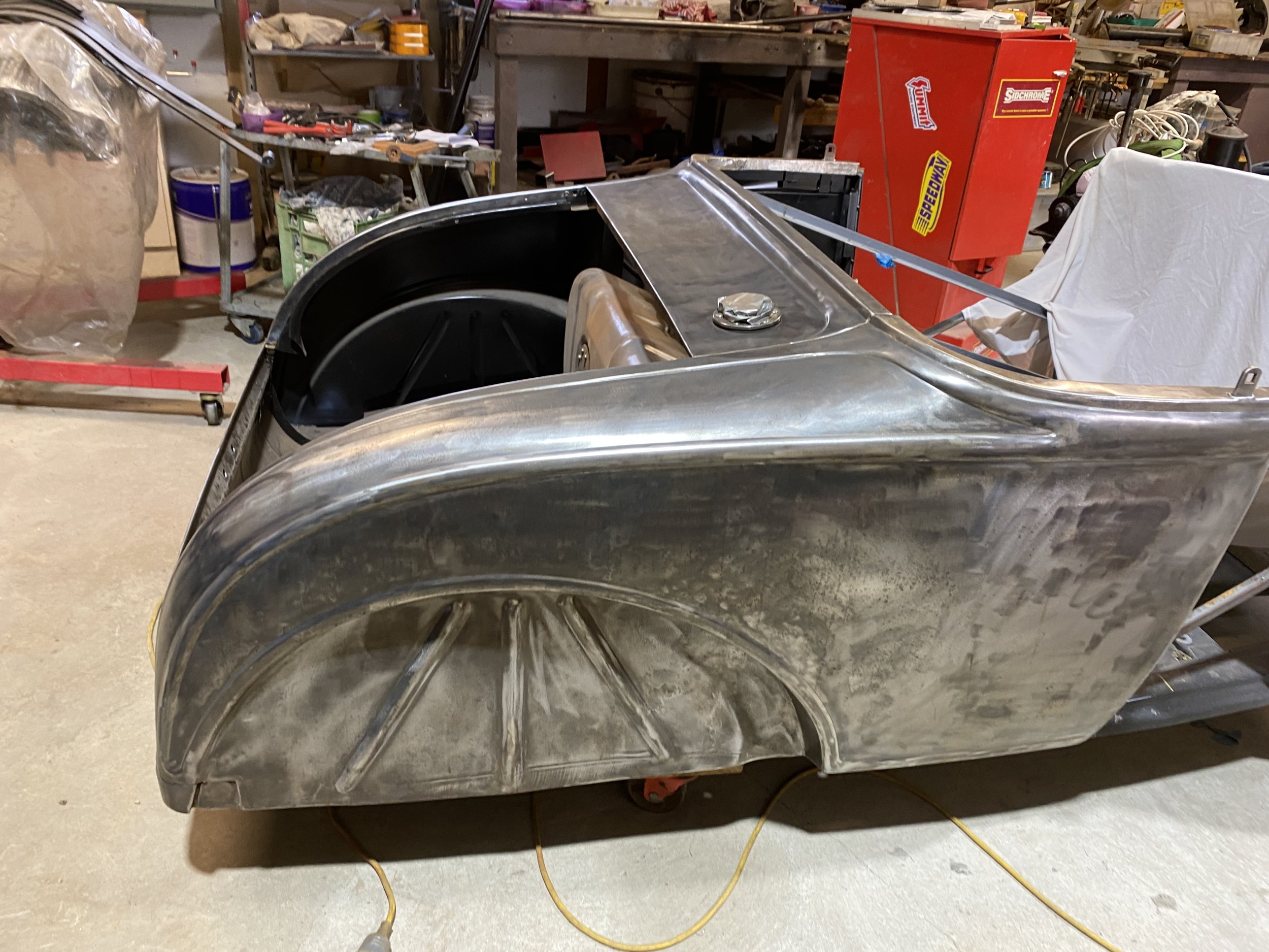

    Making a start on preparing body for paint
    Lots of surface rust, l found the heavy rust actually came of cleaner than the lightly rusted
    All came of reasonably easily with the wire wheel,
    Whatever you do when you use these things l highly recommend using appropriate safety gear, at the very least safety glasses.
    IMG_7618.jpeg IMG_7616.jpeg IMG_7617.jpeg IMG_7620.jpeg IMG_7622.jpeg IMG_7623.jpeg
