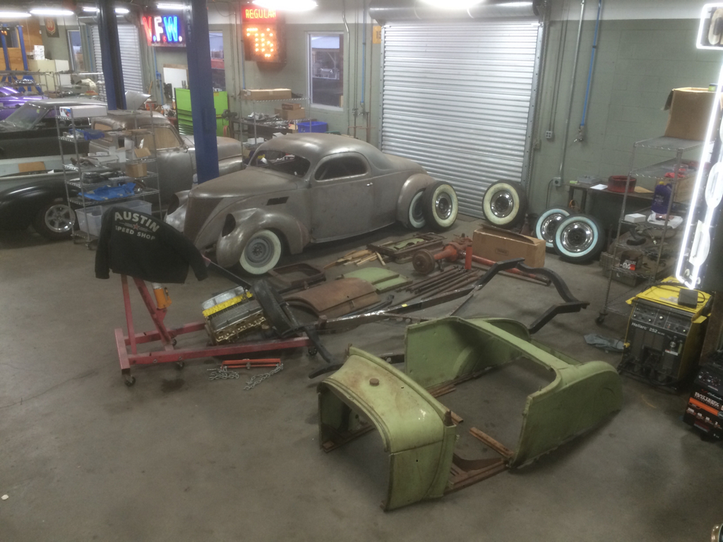

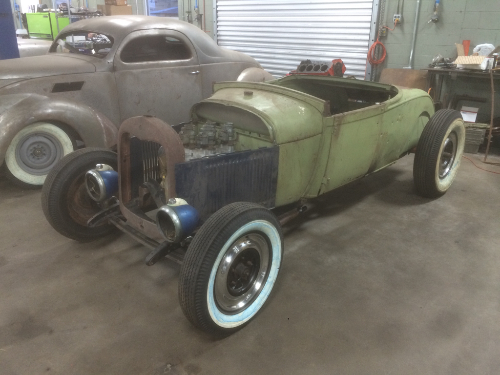

    Many of you followed along as I attempted to build a hot rod, starting in my mom's garage almost 6 years ago. I was a 22 year old kid who had a MIG welder, a drill press, air compressor, hand tools, and perhaps too much ambition.
    Well, that last part is probably still true, but over the last 6 years, I've gone from graduating from college, moving to Arlington, living there for two years, to moving to Austin almost 4 months ago to start working at Austin Speed Shop. In the middle of all that, I worked on what began as a coupster, and is now a genuine roadster, whenever I could.. On and off.
    Moving to Austin, the first couple months were rough as I was looking for stable ground. And after that happened, Eric discussed with the owners of *** and presented me with the challenge of getting my roadster driving in time for LSRU. Well, pressured me into it is more like it, and I couldn't be more appreciative of that! I feel as if the quality of the build has already improved considerably since I began working at Austin Speed than it would have ever in my own garage at home. When I moved my roadster from storage to the shop to start thrashing, I had about 100 days left. I've been using the hashtag #100DaysToLSRU on Instagram whenever I post a teaser or update. You can also follow me at @thenelsongarage on Instagram.
    Here's a quick run-down of parts the roadster is using:

    There won't be a lot of body modifications.. Mainly interior stuff and perhaps a chopped windshield. The body will be left as found. The frame was upswept in the front and Z'ed in the back to get the stance I wanted.

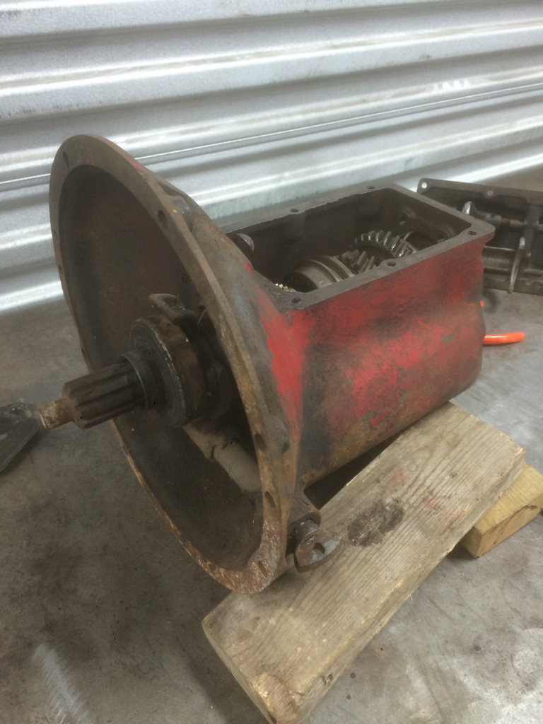

    Steven also wanted to replace the 3-speed transmission with a T5, so I was able to nab that up. While the frame was out getting sandblasted, I went ahead and blasted/primed a 78 case so I could transfer the gears in there. I also test sprayed the inside of the transmission face with a can marked "Universal Gold" to see if I liked it.. The drivetrain will be that color. If I have time before the show, I might throw the wheels in the blaster and paint them the same color..
    I haven't pulled the transmission out from under the work bench to paint gold because I was waiting on gaskets to get here from Mac's. They arrived last Friday so maybe I'll get that done sometime this week if I can get all the welding done on the bottom of the frame and flip it over. I also ordered this spring-loaded locking thingamajig off eBay that Eric told me about. He uses it in his T roadster and says it improves the shifter a lot. I'll have to get that done too..
