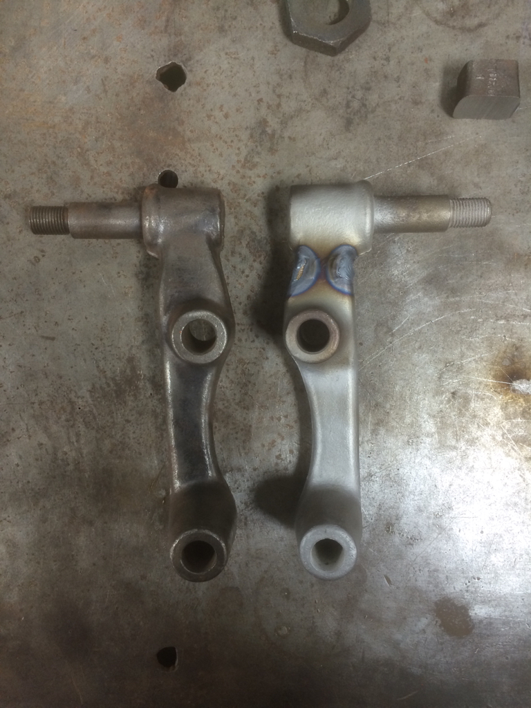

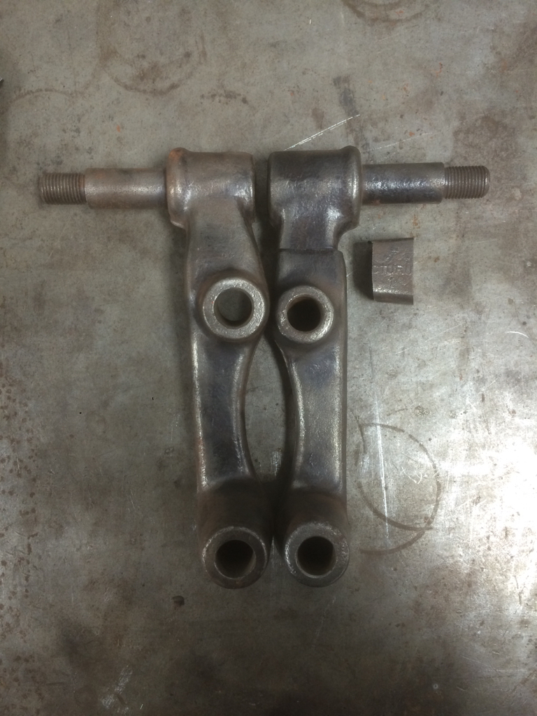

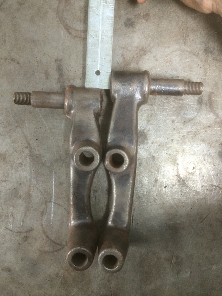

    Ever figure out why ford used a different length shock mount on each side?

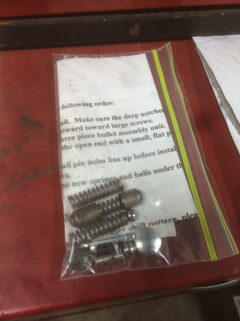

    I used one of those new detent spring kits in my roadster and found the shifting was way to stiff...popped em out and replaced with the originals and it shifts great now. Just a heads up...

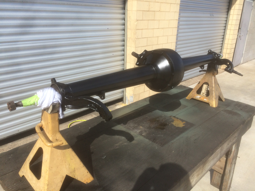

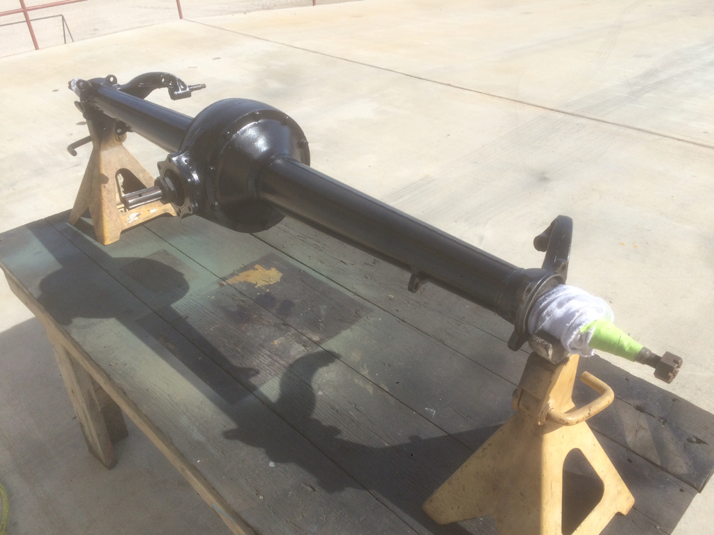

    What did you use for paint on your TT and banjo? Turned out nicely.

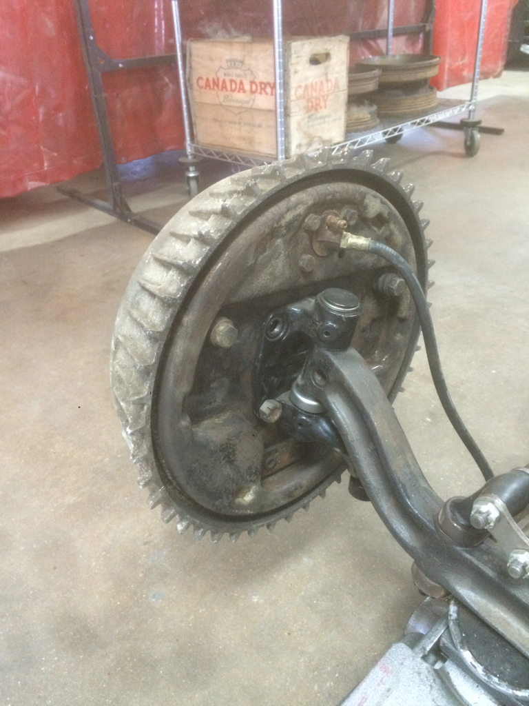

    Hey, @Tex***peed , would you mind do***enting the F250 brake conversion and ***embly when you get to it? I don't think I've ever manage to find a thorough enough do***entation of the parts and process.

    I believe it was to clear the panhard bar. I was hoping I would see why on RoadFarmer's '47 sedan but his sedan uses lever shocks and not tube shocks.
    Anderson seems to love his. There are varying opinions on these.. It could be your spring was just too stiff, but I have my original detents stashed away in case I agree with your opinion.
    Thank you. It was a Rustoleum product. Enamel black, if I remember right. I just grabbed them out of the paint cabinet at work and will have to buy more anyways. It's a spray bomb.

    I don't know if I could provide a better tech article on that than what is on here already.. Really, all I know is that the F2-3/F250-350 plates are what you need, 1946-1948 p***enger car hubs (mounted on the outside of the drum from the factory), and obviously Buick drums. I sent my hubs off to Bob Wilson to have him machine them so they mount to the drum from the outside. From what Anderson told me, Bob turns the little lip on the back side of the hub down so it fits in the opening of the drum, then he machines holes in the drum that you bolt to the drum through the back. I will have to drill the Ford bolt pattern through the drums myself and install wheel studs.
    If you want the hubs to mount through the back, then that involves making a spacer ring that fits in between the drum opening and the lip on the outside of the hub which is a little more work - as well as turning down the outside of the hubs to fit against the drums.

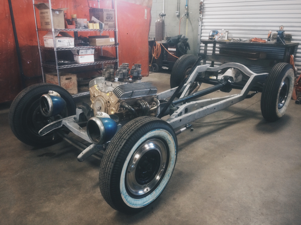

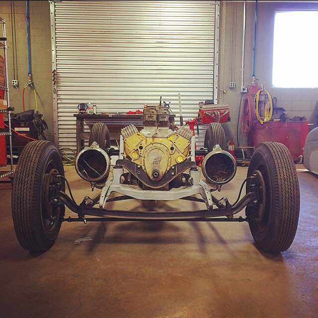

    I finished up welding the bottom of the frame, making boxing plates to fill in where I cut out the old "K-member" and redid a few of my old MIG welds with the TIG instead.
    Got the ch***is rolling again..
    Threw the mock-up drivetrain in there, bolted on some knick-knacks, and bolted on the brakes for mock-up..
    I couldn't resist throwing the Buick drums on there for a quick look-see. I like how the brakes all look like old hot rod parts. I probably won't clean them up much.. The body will be left as is, so a little character here and there won't hurt.
    I'll have to make 1.25" spacers for the transmission to get the drivetrain at the optimal angle.
    And maybe notch the center of the X-member for a little room around the radius rod mount.
    But I really love how the radius rods all mesh in with the X-member so well. I made the radius rod mounts years ago before I even contemplated the X-member and it all falls in together. The parking brake cable thing will have to take some serious thinking though.
    Check out how the X-member just disappears into the A frame from a worm's eye view.. :)

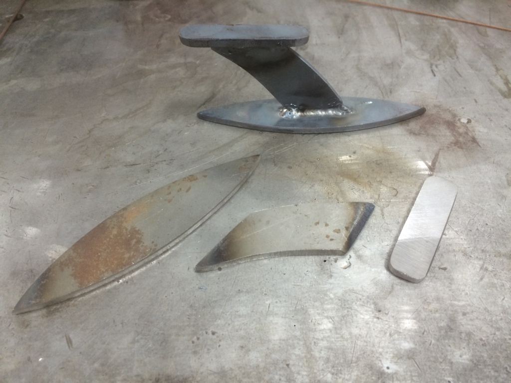

    Thanks everyone! So, since the last update, I radiused the rear rails..
    Made a new pedal ***embly mount patch for the X-member and welded it in.
    Then had a co-worker machine me some body mounts in exchange for some welding I did on his taillight stands. Then I welded the body mounts in..
