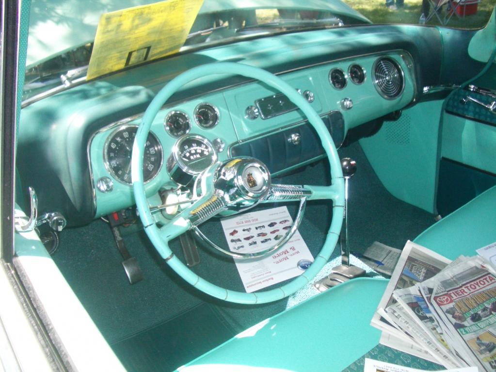

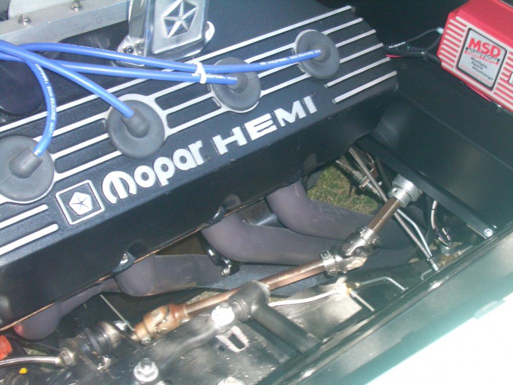

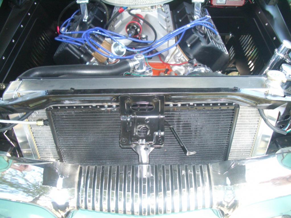

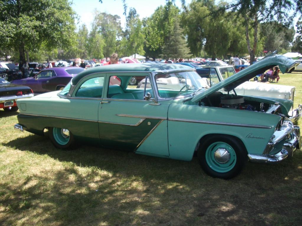

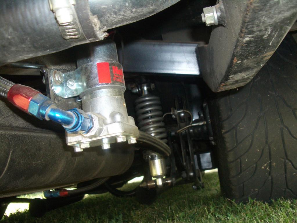

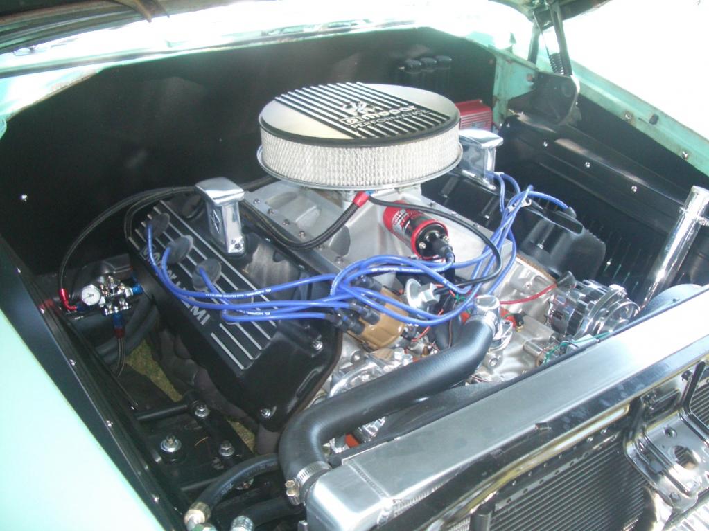

    Just got back from spring fling in van nuys, southern california. This is a 1955 Plymouth Belvedere, 2 door post. 528 Hemi, Fatman Fab stubframe, 4-link rear and 5 speed tko overdrive..bad *** for sure! owner was a good guy and answered all of my questions. Here's some pics. I took alot for fitment issues, and the radiator mounting.

    That's a nice Hemi-powered '55!

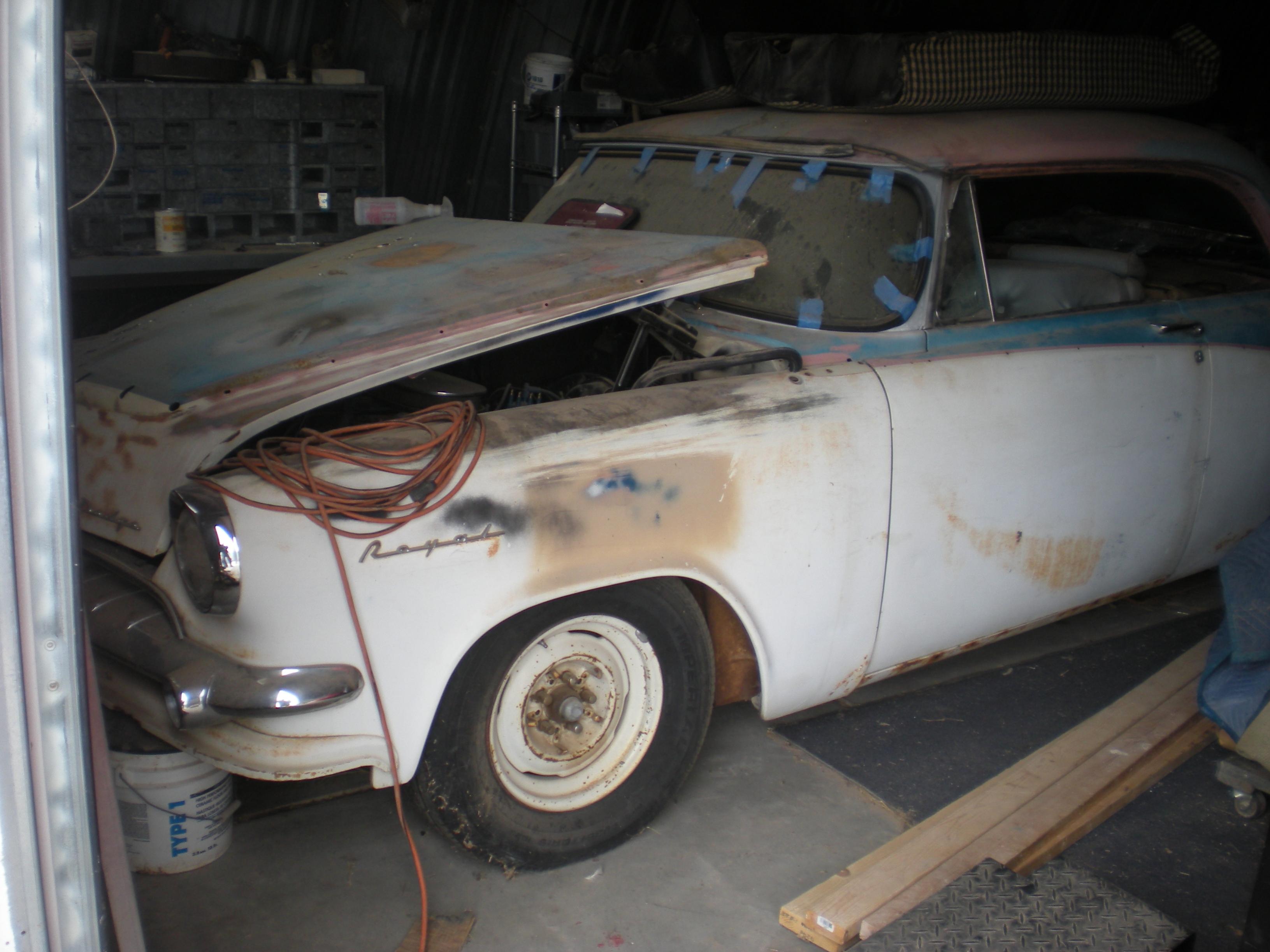

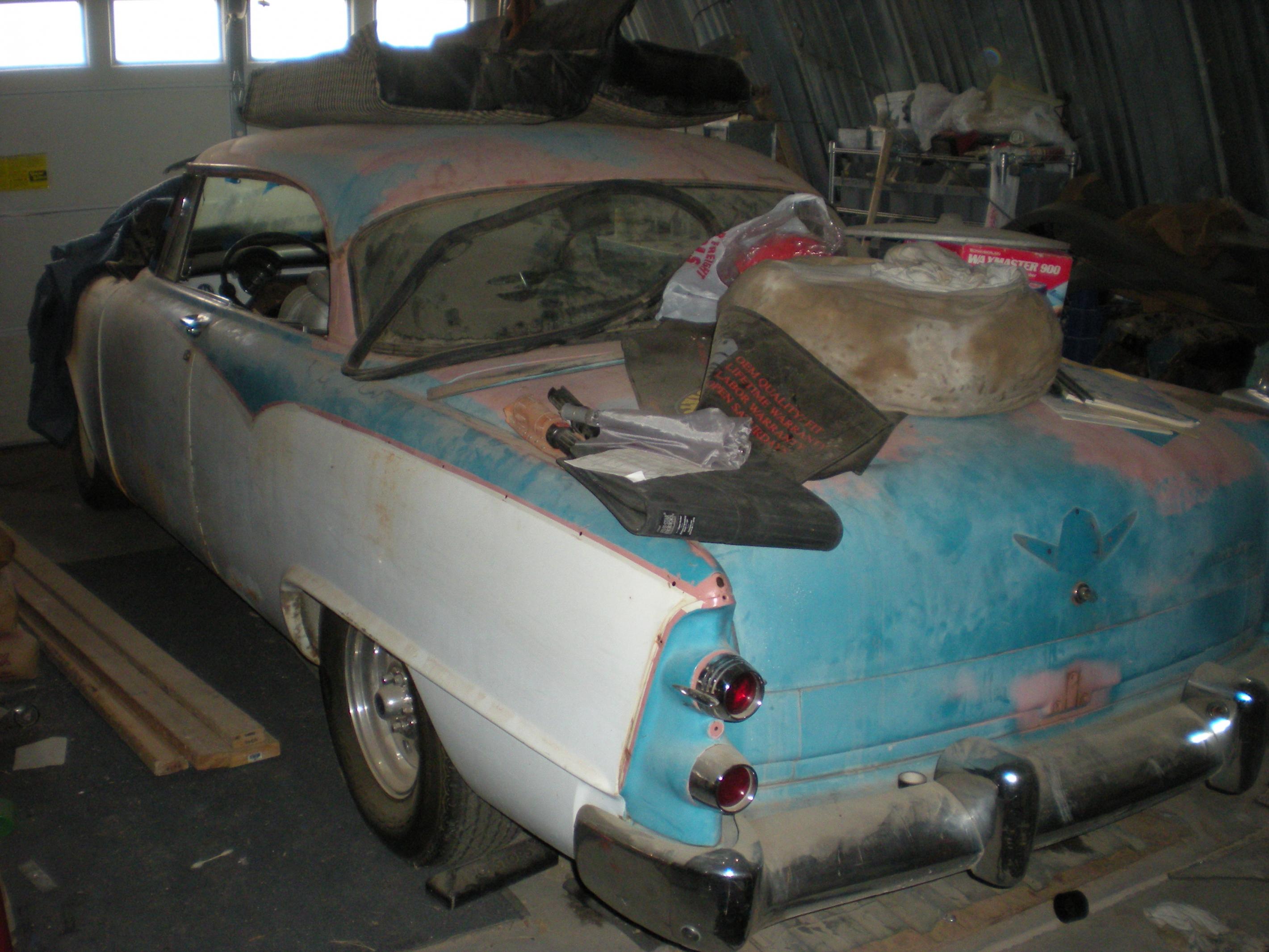

    This is Dad's '55 Lancer. He p***ed a couple years ago and (step)Mom is holding onto his cars. Once some family drama/politics are sorted out, I hope to get this one and finish it. I remember a few things Dad told me about the car and got more history on it last time I saw Mom. They picked it up in Flagstaff AZ 4ish years ago with a Volare front end already under it (wish I'd gotten pics for the above posters) and a later model rear axle but I couldn't get a good look at what it is. It has a 360/727 out of a 84 Lil' Red Express truck my brother-in-law swapped a late model Hemi into. The car seems really straight and pretty solid (but I haven't seen the floors yet). I think it wouldn't take much to get her going. If anyone in the Flagstaff area recognizes the car and can provide more history on it, I'd much appreciate it.
