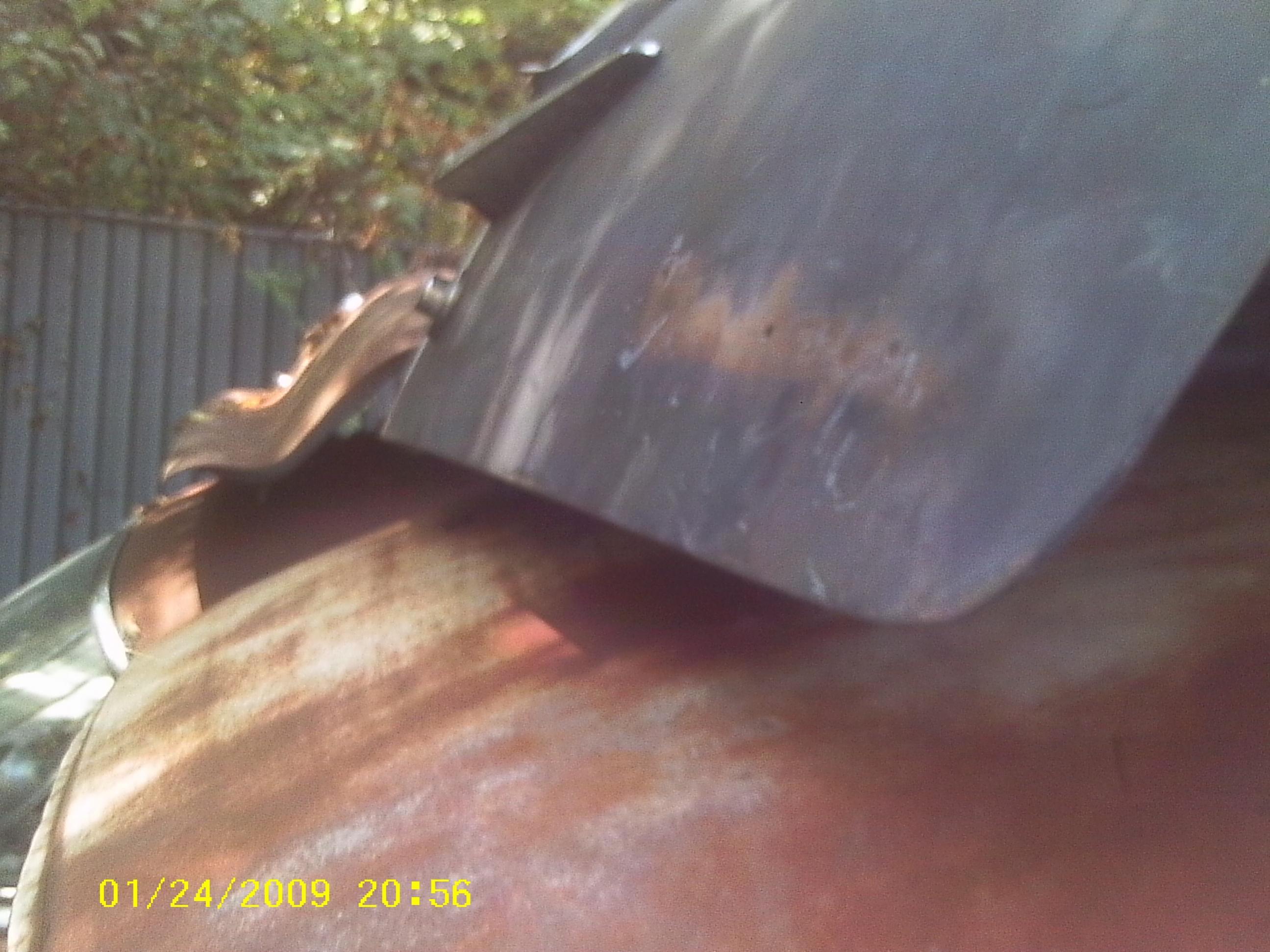

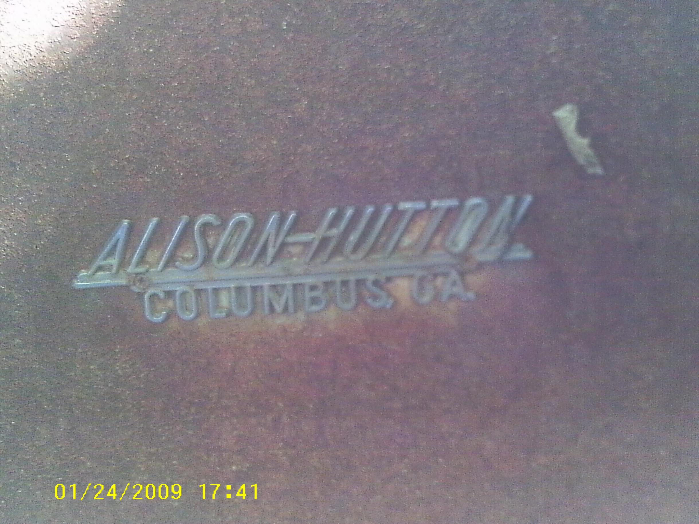

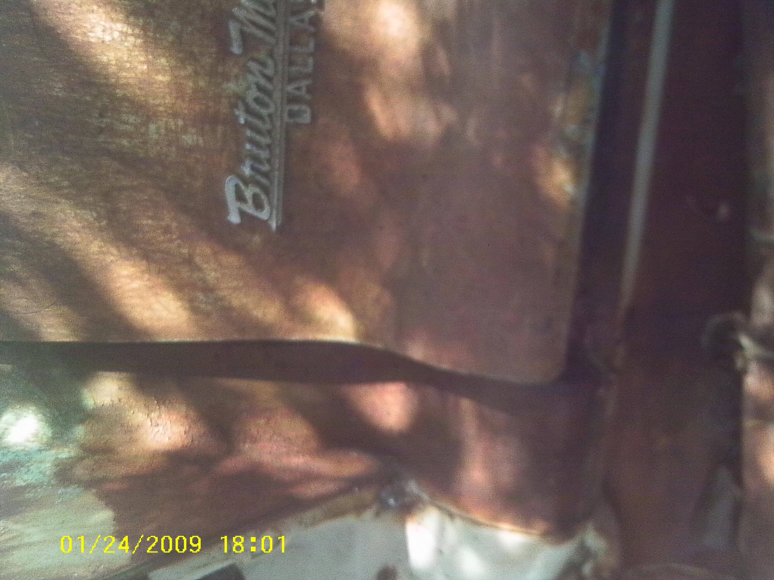

    today...let's take a 1956 2 door hardtop trunk lid from " Buckner Motors" - a mopar dealer in Dallas (the one from my parts car) and try to exchange it or put it on a 4 door sedan (another parts car in my yard) with a Alison-Hutton" trunk lid from a dealer from Columbus, GA...wholaaa...it fits....the difference in the Dodge and Plymonth is the Dodge lip near the bumper is straight and the Plymonth has a little bit of a duck tail? curve to it....
    soooo....1956 trunk lids exchange between 2 doors and 4 doors in like makes....sure it's the same for 1955 - between like make's....
    View attachment 1402207 "

    Doesn't get any more definitive than that, thanks for the extra effort.
