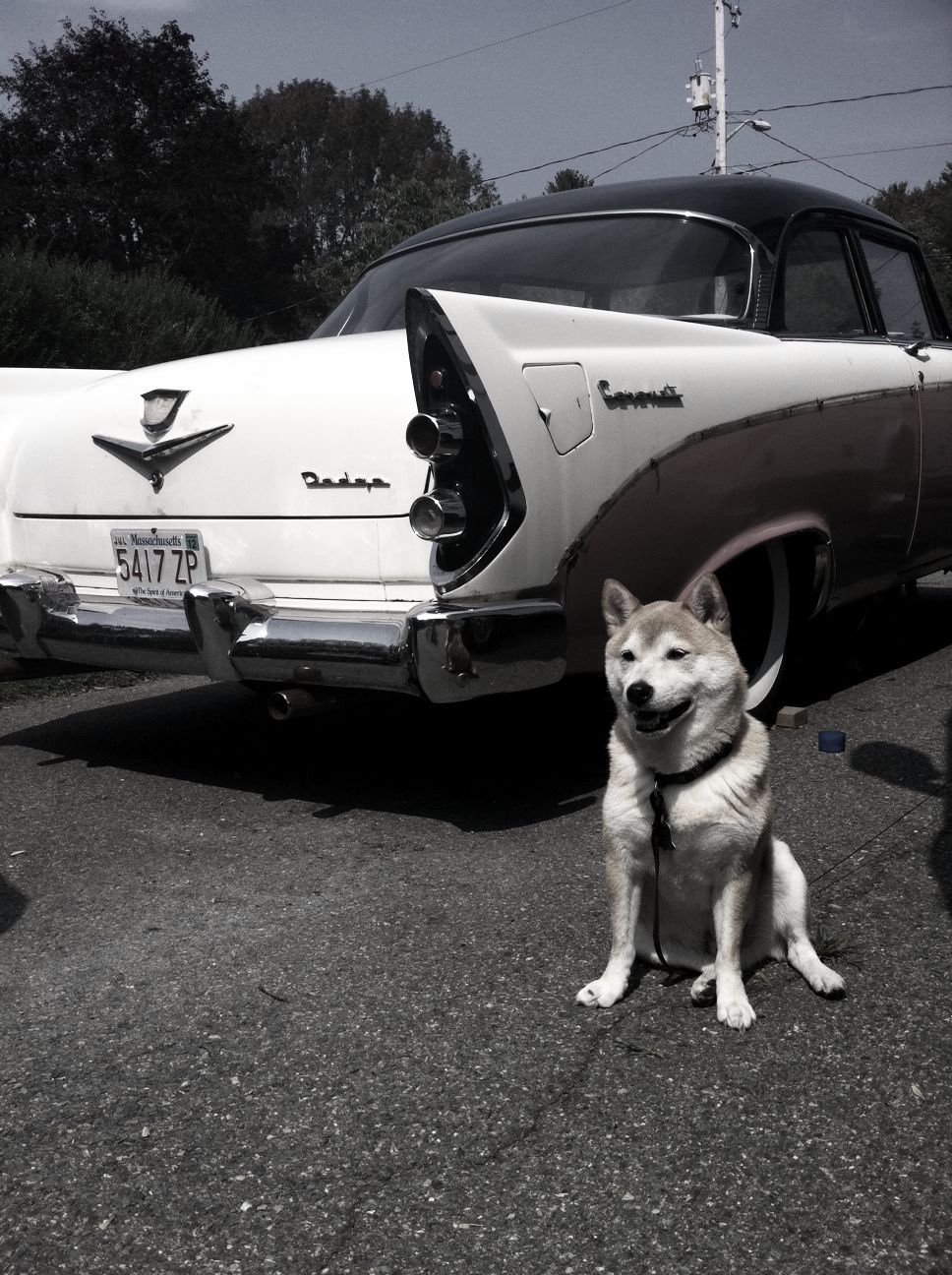

  3. Sure has quieted down on this thread! All the cars on here are AMAZING. My '56 is still in progress, coating it down in some primer and panel paint asap. Whoever painted the car before me really made a mess of things, the paint is coming off to bare metal in HUGE thick plastic-like chunks, primer and paint combined. I'm almost unsure as to how to prep, whether I should strip it all down to bare metal or just sand it as best as I can. As for the drivetrain, I've decided to hold off on throwing a big block in it and I'm gonna keep the 270 in it (which will hopefully be rebuilt this winter). I snagged 3 stromberg 97's off of craigslist and plan on doing a 3x2 setup. Just need the intake. With all that said, here's a picture of my car, and my dog, Nico.

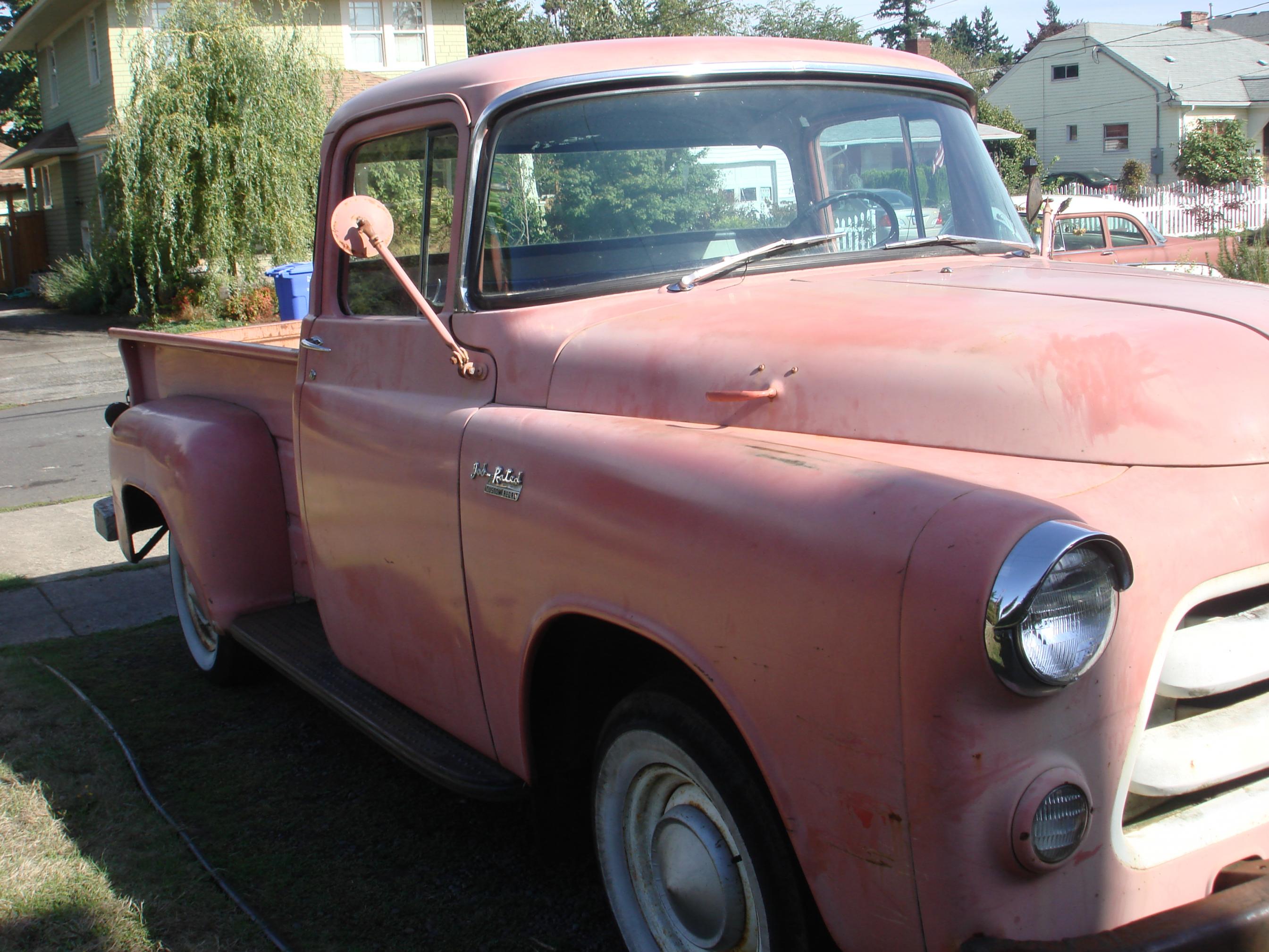

    stoked to find this thread. I've got a 56 dodge pickup and my kid's got a 56 coronet. bought the pickup after hearing tales of my grandpa driving his 56 pickup as a push truck every weekend at the Portland Speedway in the late 50's early 60's. kind of a way to honor his memory and spirit now that he's gone. trying to add some pics, their not the best but it gives you an idea. hope it works.
    cheers..

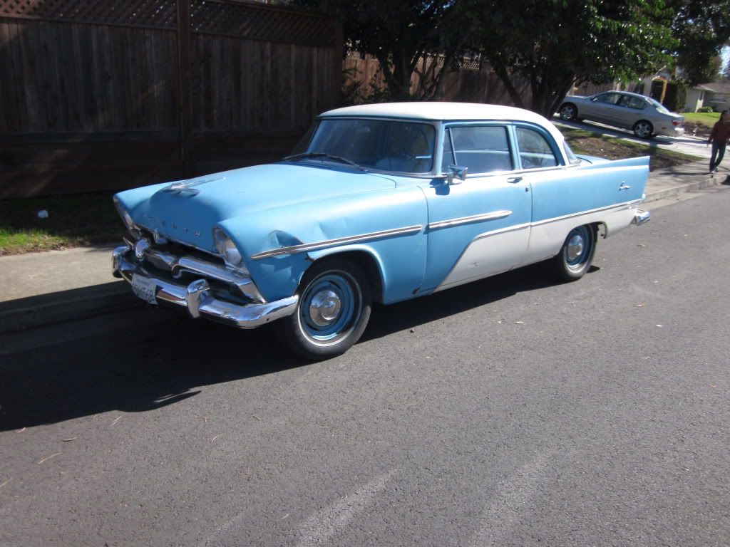

    Picture of mine when I first got it
    While I'm at it, I'm looking for a couple parts:
    Driver side fender
    passenger door
    Trunk floor panel, mainly the rear section.
