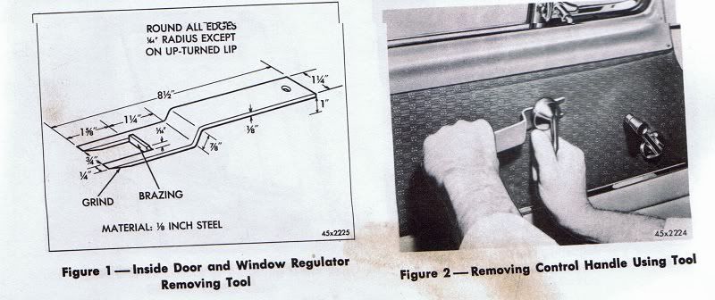

    I had forgotten that the service manual had this info.

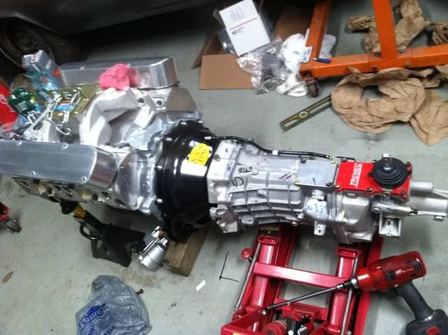

    It can be done. [​IMG]
    A stock 7" crank pulley will hit the frame unless you lift the engine, I wanted to keep it as low as possible so like Nick said, went with a 5" March underdrive pulley.
    A Center Sump oil pan will also work, I used a Milodon 30755 center sump pan that is supposed to fit A, B and E bodies. It seem to clear the steering linkage fine, but I am going with a Rack & Pinion that I am still in the process of working out.
    The engine is offset to the pass side, I just lined it up by centering it in the with the trans tunnel. A 727 will fit no problem and Imperial Services makes a transmission mount for that conversion. I went with a T56 6 Speed and modified the original mount to work.
    I will post more info soon.

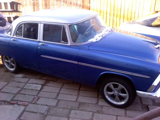

    from finland
    hi,
    looks like you have a lot very useful information here and
    awesome cars. I will take my time and read this thread.
    I have -55 belvedere with flathead 6 and powerflite.

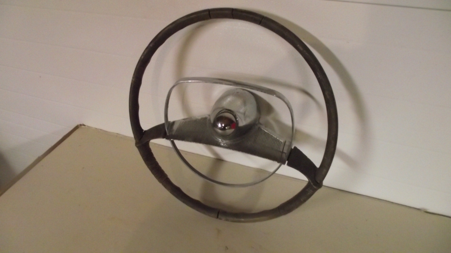

    Question: Is this a steering wheel for 56 Plymouth? Somebody told me it was and it was discontinued early 1956.
  17. tjsfury
    Joined: Oct 12, 2009
    Posts: 4
    tjsfury
    It looks like one from the photo. That unbroken horn ring is valuable.
  18. Studebakester
    Joined: Sep 14, 2007
    Posts: 264
    Studebakester
    from Oxnard, CA
    I've been told that that wheel was a rather rare option inthe mid fifties Plymouth. The same basic wheel was used in 57-59 Plymouths (I believe) but with a different horn ring. I'm no expert and am only passing on what I've been told. Nevertheless, I'm sure it is somwhat rare and valuable.
