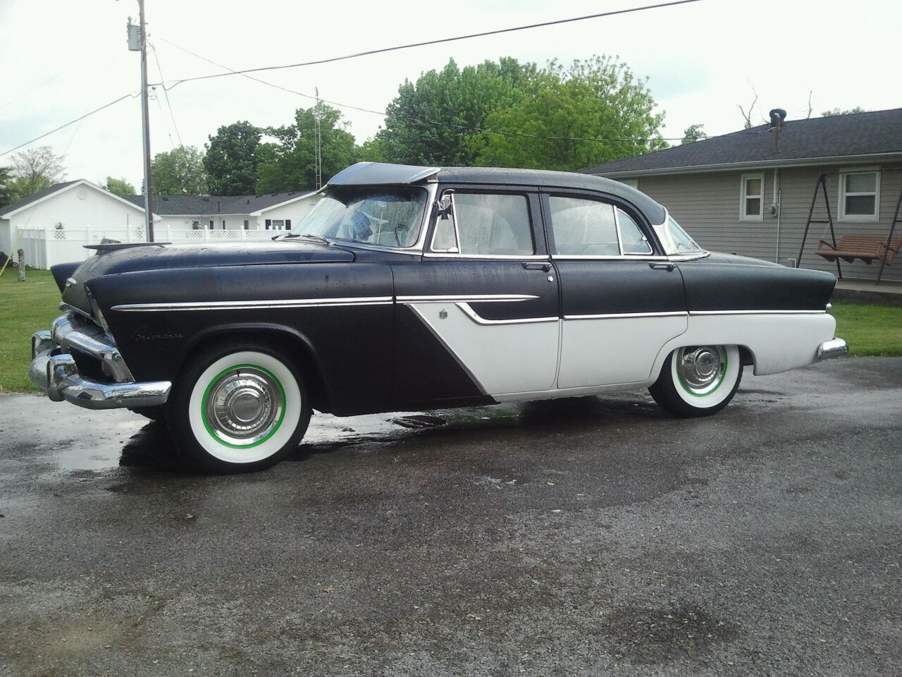

    Our 55 belvedere 4dr. Been a great car, lots of looks. Original 230 6cyl. still 6volt system. Only one like it at nearly 99% of cruise-ins or shows.;)

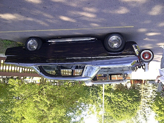

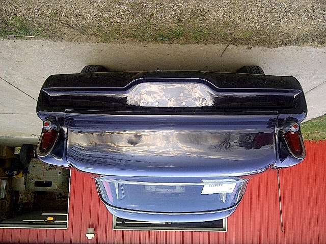

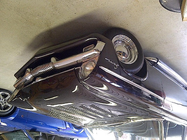

    My brothers 55 Plymouth Savoy. Louvered hood, custom front and rear rolled pans, 260 Poly motor.
