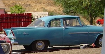

  19. I have a 56 post if your interested - PM me....
  20. RFERG - that was for you.....

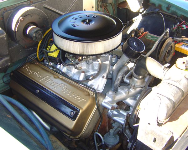

    Hey - Steppin' Out...I'm running an original 270 Hemi in my '55 Dodge and am using what is called a stock low deck 318 electronic distributor. It was a drop in and has worked great for 3 years and over 10,000 miles. Can't remember the exact year. Believe it was late 70's, early eighties...

    All the same, just a matter if you want points it's pre '73, electronic from 73 up through the 80s, don't know about the Magnum series engines.
