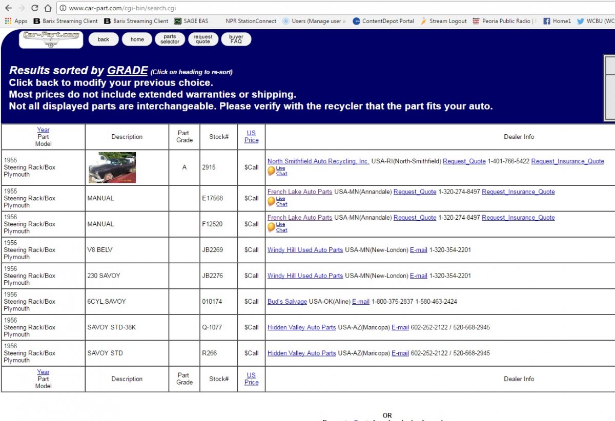

  1. I didn't see any in Canada, but there's several used ones here it the states on Car-Part.com that searches auto salvage yards for parts and compiles the listings for you. I've saved a screenshot with phone #'s and part#'s that may help. Sorry it turned out blurry. Good luck with your quest.

    I will give it a try. Thank you so much for your help, much appreciated.

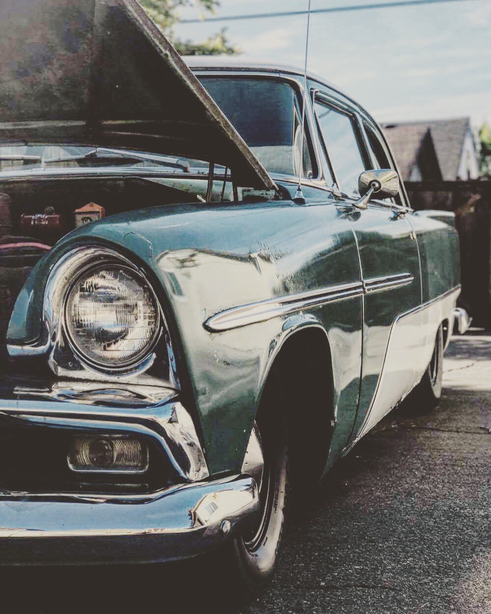

    Wow! I am so happy I found this thread. I am totally new to these cars and looking to learn about them. I have ordered a shop manual but it won't get here for another week or so. I have some quick maintenance questions before I read through the whole 50 pages here. Any help is appreciated.
    Firstly the car - I guess it is a little bit of an unusual bird for the US folks. It is a 1956 Dodge Regent 2 Door Hardtop. I could only find 3 pictures of a 2 door HT Regent on the web. Outside and underneath in excellent condition. The nice condition of the underside was a pleasant surprise. Engine bay needs cleaning up. Only engine choice for 56 Canadian Hardtops was the flat 6. I assume this is a 251(?). Single brake cylinders always make me nervous. I am curious to know what others are doing to improve the braking system. The car is in transit and I won't get it for another 2 weeks.
    First job is I just want to clean up engine bay and refresh all fluids. I did some research on gas and oil for flat 6's and got conflicting info. Hopefully you guys that actually own the same car can guide me.
    Feel kind of silly asking these questions but better safe than sorry......
    Gas - what octane are you using? It's a stock low compression engine so I thought 87 would be fine but other were saying put in premium. I am in Canada so premium goes as high as 94 here.
    Oil - I like Brad Penn oil as it provides a higher zinc content so no additives are needed. Is 10/30 Brad Penn fine for these engines.
    Oil Filter - I've never owned a car this old before. What oil filter is in the canister? What filters does it use? Can I get them at Napa?
    Transmission Fluid - What are you guys using or suggest?
    Anything specific or special quirks I need to look at in the engine bay?
    Thanks guys.....going to start on page 1 now and work my way through this whole thread. Time for coffee.

  4. Kmrumedy- Your '56 is a beauty! Always love to see the Canadian versions of these cars, they have a nice blending of body lines with Dodge and Plymouth parts. I'll chime in with a little help if I may.
    GAS: I run regular 87 octane in my '55 with the 230 flattie. It doesn't ping, and the car runs fine with stock timing. I think these are only like 7 to 1 motors. I think the 251 would be as well, but I'm not familiar with those specifically.
    OIL: For your climate, I think 10W30 is fine. Brad Penn makes a good high-zinc oil, and if you like it I'd say run it. Its a little pricier if I recall, so if you wanted to step down to another brand you could if you toss in a zinc additive. That'll keep that cam protected. I get mine at Farm & Fleet and I run a house brand straight 30 weight since I've never torn the motor down and I don't want a detergent oil, but it probably doesn't matter.
    OIL FILTER: If you have a drop-in canister style Mopar bypass oil filter setup, (pic attached) you will need a NAPA 1071 or WIX 51071 filter element. The 1080 / 5180 will work but that's for a full-flow setup, which these cars weren't.
    TRANS FLUID: I read a lot of folks just run DexIII in their Powerflite and Torqueflites.
    The nice thing about your motor is that a lot of parts are still available thanks to the Power Wagons running these for so long. If you ever need rebuild parts, you can find a lot at vintagepowerwagons.com
    Also, if you need a shop manual in digital form, you can download one here. Happy wrenching!
