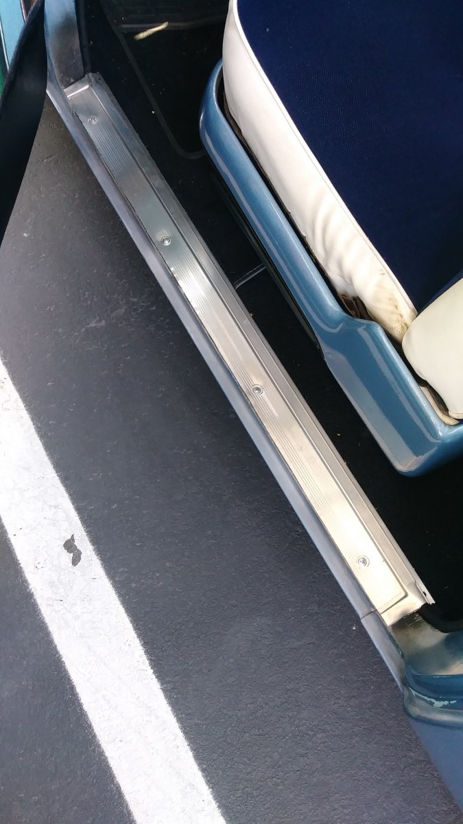

    good luck with that, I checked a few years ago and no one made them. I bought a 60`s B body door still and cut them to fit.

    Old Ray here`s what i did. Now this worked for me and my car might not work for you. I have a 1955 Plymouth Savoy. I purchased door stills from Classic Industries here in California. It was a close fit but not perfect. I did some trimming with the hand shears. Good luck.
    https://www.classicindustries.com/shop/search/?q=mb2259

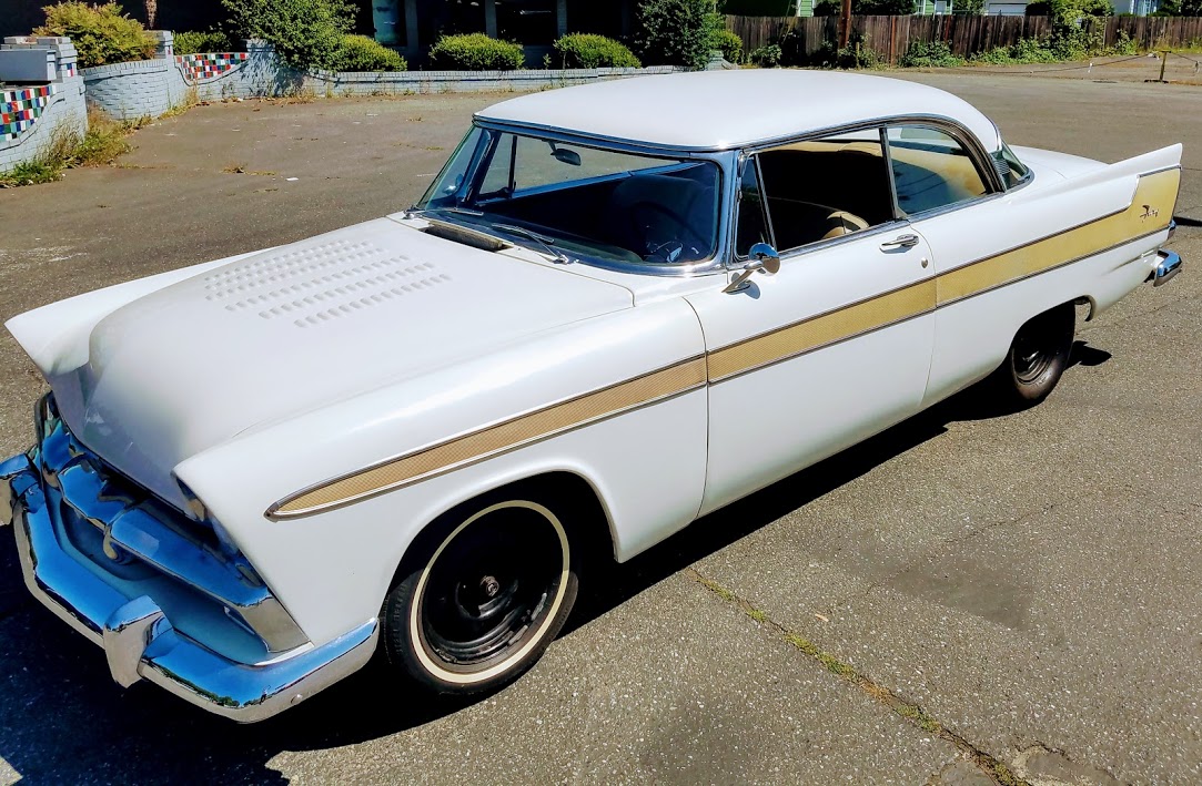

    Hey guys, I finally found my info on the door sill guy and gave him a call. He's located in New Jersey and builds sill plates for just about any vehicle. Took about three weeks and he shipped me a pair of sills he built and they are great. Not cheap but very nice and I'm glad to get them. Got the front fenders and bumper and grille on. Got the radiator mounted and the electric pusher fan installed and wired I had to use because of clearance issues. I can finally see the end in sight. A little wiring to do, an oil leak to track down, and the exhaust system to install. Been a five year project but things are finally coming together. Can't wait to get her on the road and see how it handles with the torsion bar suspension and the LA 318 and TorqueFlight.

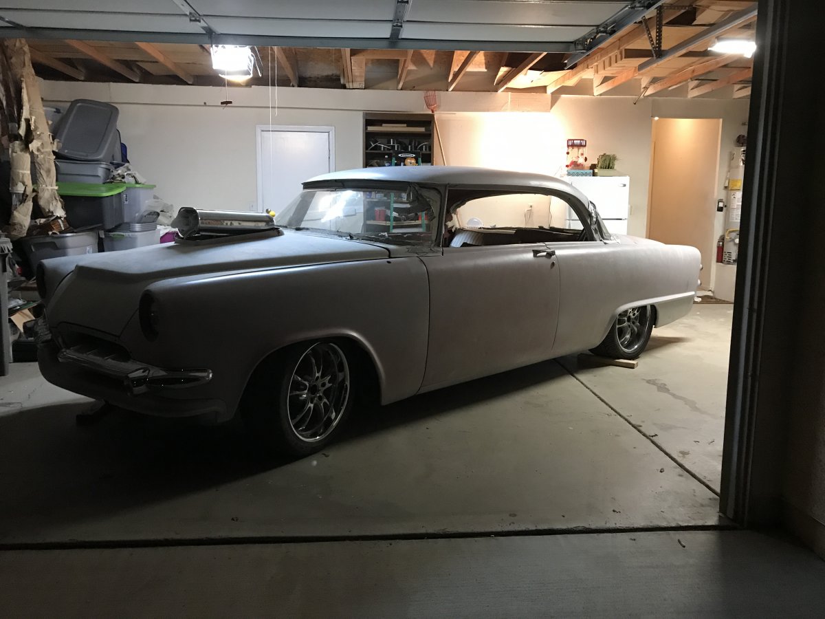

    Hey folks, Louisiana guy here, recently acquired the '56 savoy in the picture. I have been following this thread for some time now, LOTS of great info for these cars. I also plan on doing the Dakota clip swap, i had a local junkyard cut one out for me already. If anyone is looking for a factory V8 to swap into their car, i have the 277 poly pulled out and do not plan on using it.

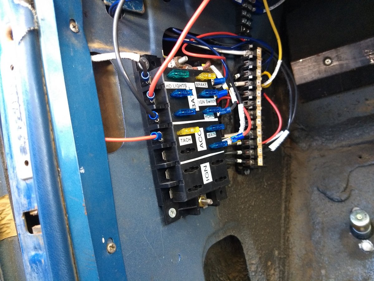

    Hey I got a 55 dodge that I bought which already had been changed to 12 volt. He rewired most of the front things, I changed out the wiper motor to 12 volt. My problem is the brake lights and turn signals. at the back. the flashers work but when I step on the brakes it blows the fuse. the wires that run to the taillights go into the headliner and than to the lights. do you think that maybe I have a wire grounding out up there where I can't see them?

    that's where I looked first, but I followed them from the tail lights forward and they go up in to the roof.

    I have a Plymouth, so not sure about the Dodge having separate turn and brake bulbs, But on mine, if the turn signals work but the brakes light don't, it has to be a short to ground somewhere from the brake light switch to the turn signal switch (including in the switch) as the same bulbs are used for both the turn and stop light circuits. Depending on the the turn signal switch model the turn signal switch also cancels the brake light to the side that is turning.

    to clarify, A add on turn signal is being used because the one in the column was messed up, also a brake light switch is being used one the pedal instead of on the master cyl. So than the flashers work but the turn signals and brake lights are on the same circuit. The turn signals work until I brake, blowing out the fuse. On the original wiring , the fuse is integrated in the switch. on my car a fuse block was added. Thanks for your help. Wiring is one thing I IMG_20190331_fuse block.jpg don't like to deal with.

    So, the brake light switch / wiring are grounding out the circuit blowing the fuse. Try disconcerting the brake light switch wire and see if it still shorts out? The brake light switch might be wired wrong?
