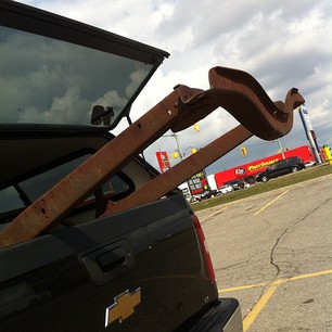

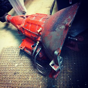

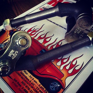

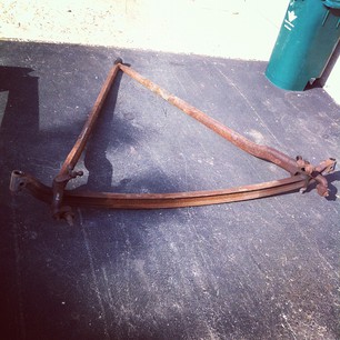

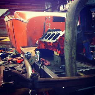

    Not really "FAKE" but I love calling my Fibergl*** T body fake...

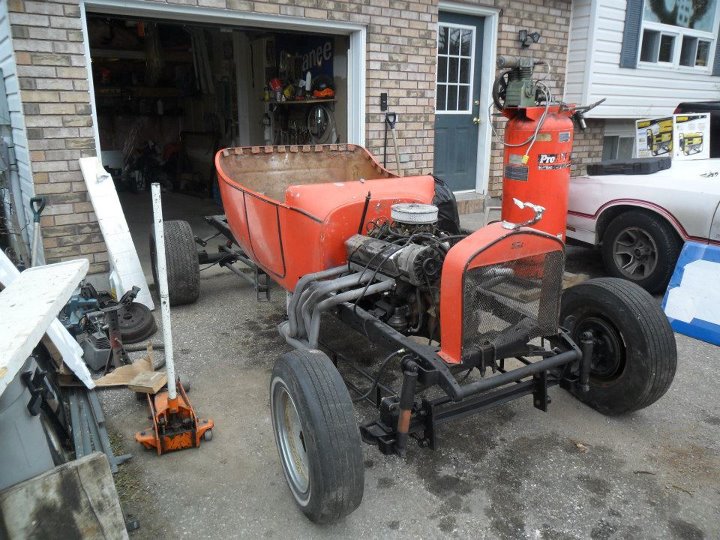

    283ci Chev and PowerGlide with a '57 Chev rearend behind it.
    Should get down the road pretty well I suppose...
    2"X3" mild steel frame with a WelderSeries Model A style front crossmember.
    Stock A rear crossmember, but undecided on what rear set up to really run yet.
    Dad wants coil over...
    Later 40's Ford front end, split bones, spring over axle, drums, etc...
    16" wheels front and back.
    Paid a bit too much for the body but I had to have it to get this thing going.
    It's gotta have some history, but I don't know about it.
    It's old real thin and has no floor at all...
    Time to learn a new skill!
    Well see what steering box comes along for us to use.
    I'd like to use something 30's.
    After selling my '27 the other year I've been kicking my *** to build another one so here goes!

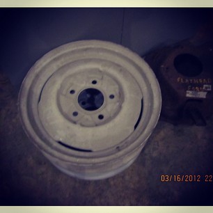

    fleet-master, The front wheels are 16" X 5" Ford wheels. Not sure on front tire sizes yet.
    The rears are some kind of new wheels with the old Chev bolt pattern, also 16".
    Not sure how wide they are but the rear tires are 16" X 7.00 Firestones.
