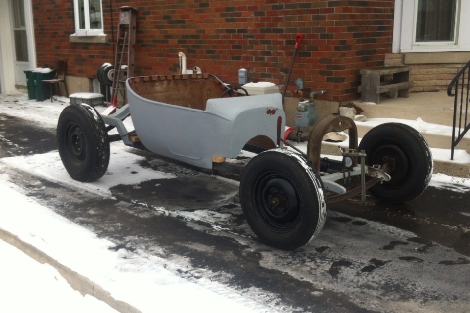

    Finally got the front tires on it and rolled it out on it's own!

    ....huge milestone right there....IT'S A ROLLER!!!!! Great fun pulling it outside for a new look at all your hard work, isn't it? Even the 'unloaded' stance looks great....

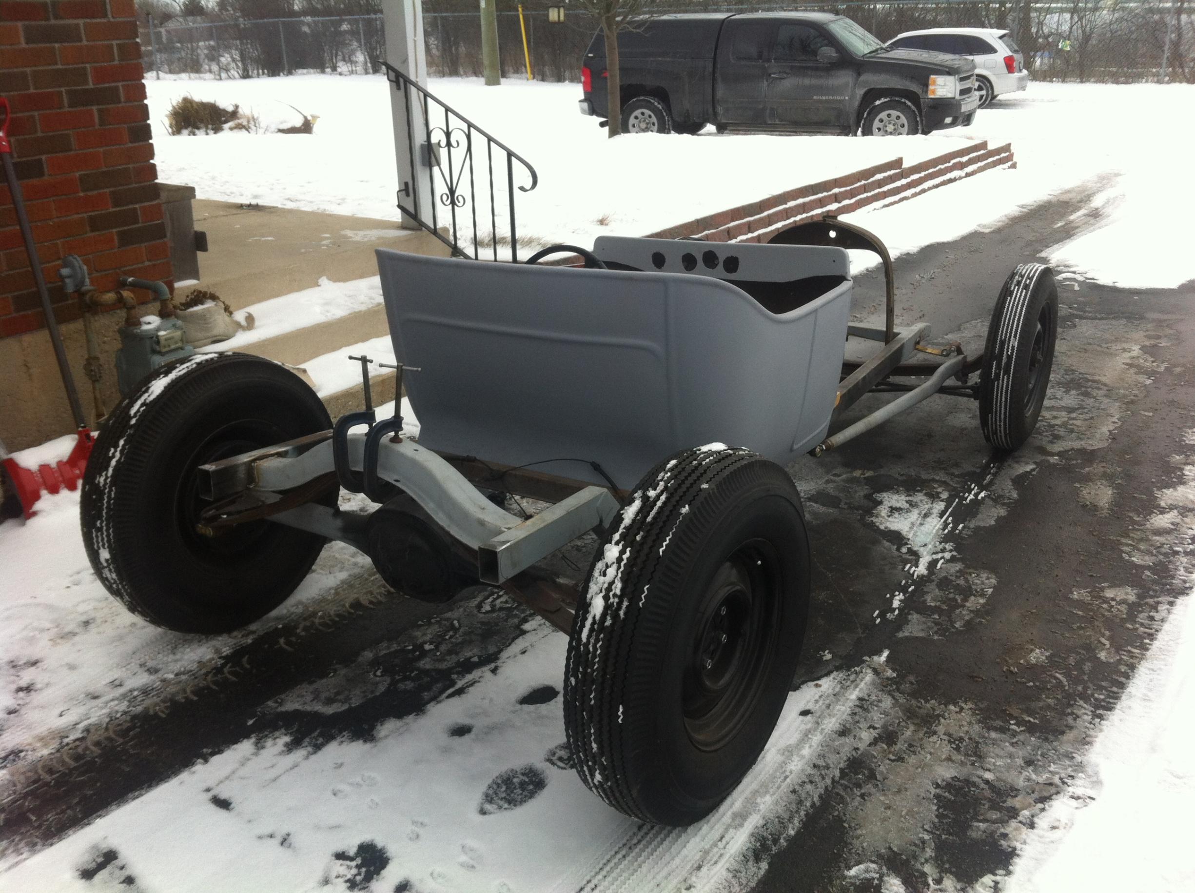

    I've got a clamp on the front suspension to mimic ride height but I'm not 100% sure how much pressure it's really putting on the spring.
    It's getting there... It's also been way too cold in the garage!
    Motor mounts are next.

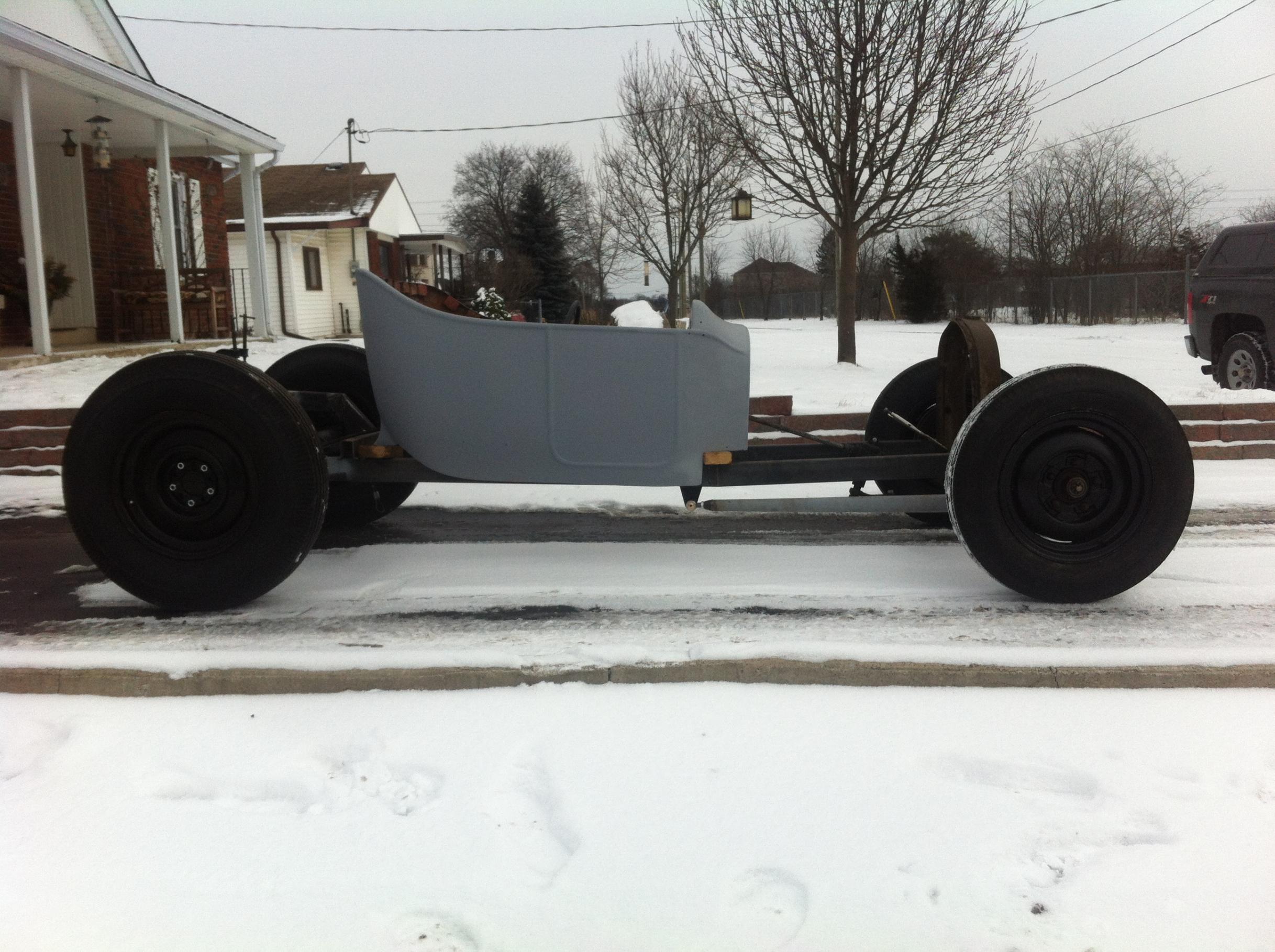

    I like this shot.
  10. Speedy Canuck
    Joined: Jun 3, 2010
    Posts: 3,896
    Speedy Canuck
    I dig it bud! I'm looking forward to seeing you drop the block in between those rails.

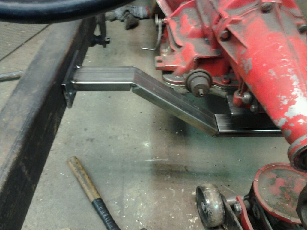

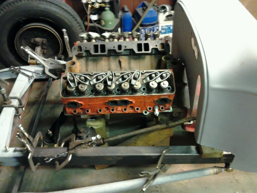

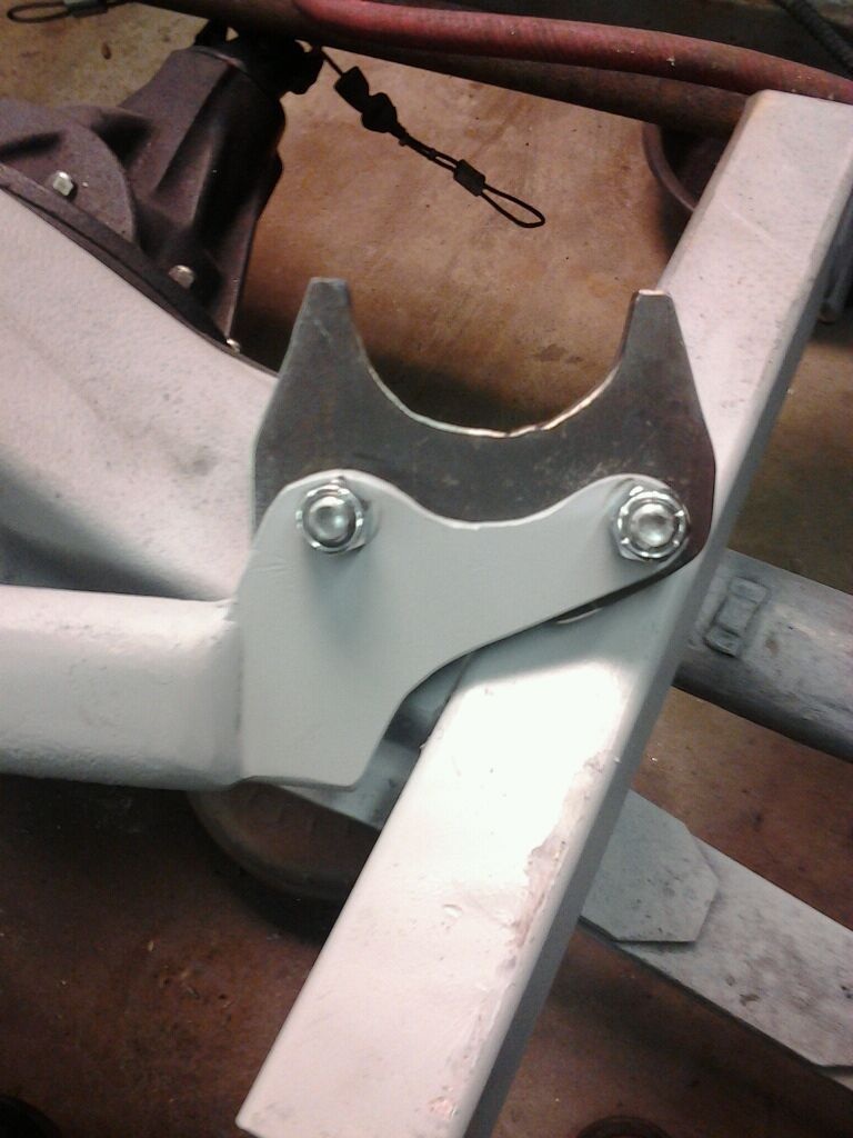

    Big progress has been being made on the little T lately.
    The rear bones are almost done and the motor mounts are almost in.

  22. Keep
    Joined: May 10, 2008
    Posts: 662
    Keep

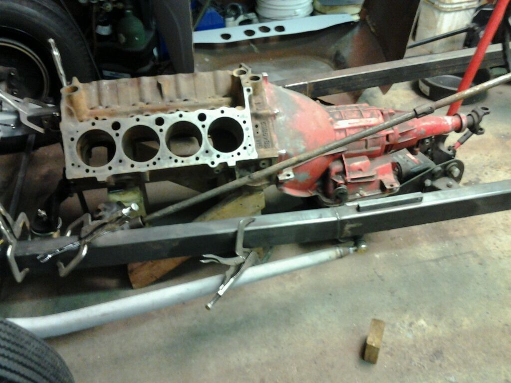

    Before you weld up those engine mounts drop a distrib in the block and drop the body on.
    I made that mistake and had to move the engine forward 1/2 inch.
  23. NortonG
    Joined: Dec 26, 2003
    Posts: 2,117
    NortonG
    That's what all the mocking up and the lines scribed on the frame were for.
    Thanks for the concern.
    I have room to move the body around still too.
    We had the water pump and fan on it and marked the frame for where the motor and body sat.
    Check post #294

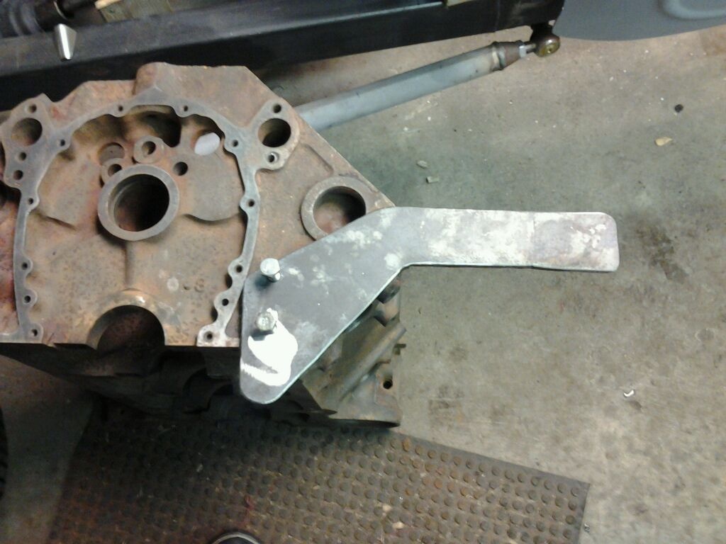

    A little more progress.
