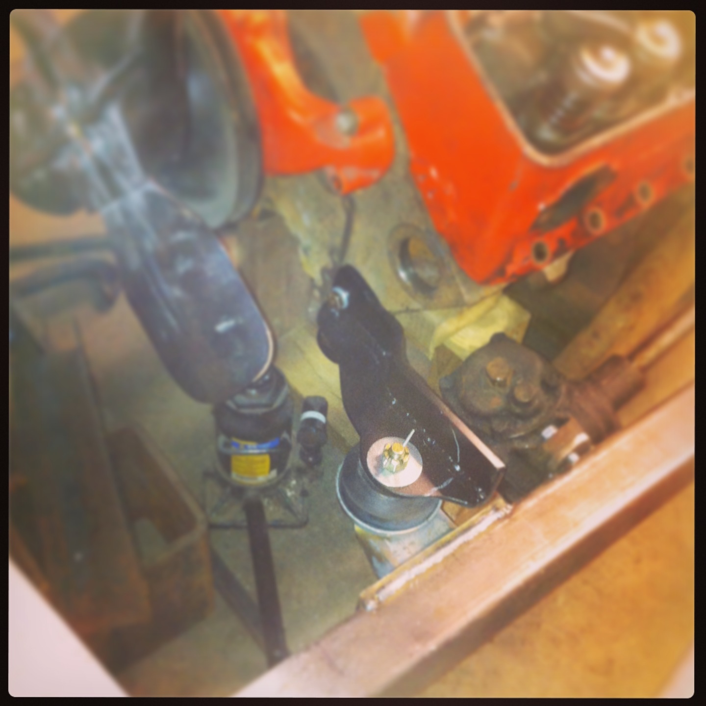

    The motor is officially in and the trans mount is in as well.
    Rear bones going in next...

    Ain't these projects fun? Looks like yer havin' some. Don't wanna sound like I'm rainin' on your parade, but have you ever give any thought of the span between the front mount and the trans mount? I was gonna use a front mount with a '57 bell housing, but had starter issues. Used the rear trans mount, but the front one scared me so I cut 'em out and put side mounts on it. Only did this 'cause a friend of mine's trans case broke. I had figured that a light car like a T wouldn't put that much stress on the trans, but that's exactly what he had. Keep up the good work and enjoy what yer doin'...... Norm

    COOP, I'm right there with you about that one and I'm pretty concerned about cracking the bell housing on the trans. We'll see what we can do about it. Side supports might just need to happen.

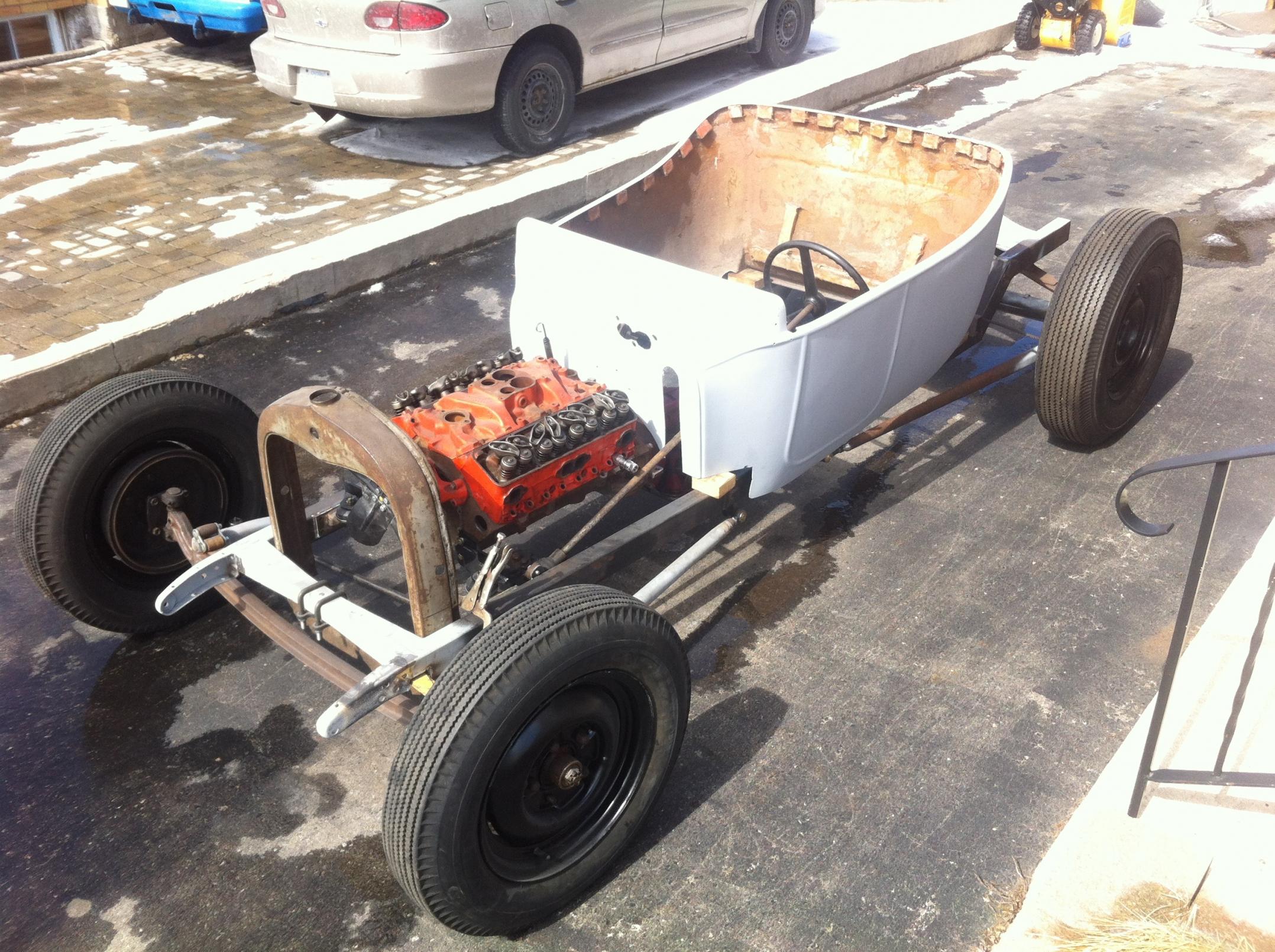

    Was hanging out over at Norton's place last night after we got home from Autorama. We just fiddled around with things, and I snapped a couple of pics. It's really looking like a hot iron these days!

  12. Speedy Canuck
    Joined: Jun 3, 2010
    Posts: 3,896
    Speedy Canuck
    I really dig that first picture I took. It looks tough.

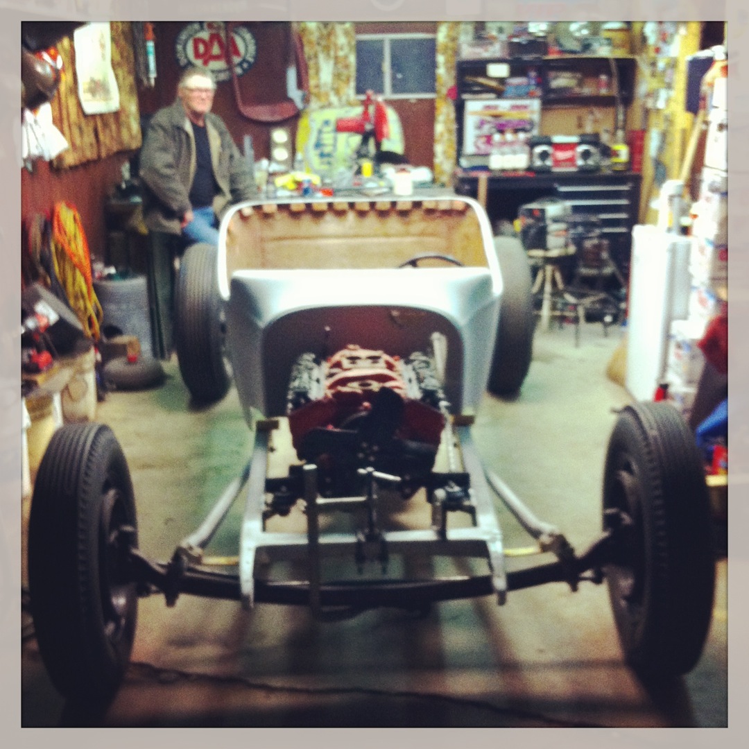

    Well this is happening today...
    I guess we should get those rear bones finished and a floor in this heap.

    ...that may be true....but looking at the third pic indicates that the project is ageing him at a terrific rate....slow down dude.....hahaha
  15. NortonG
    Joined: Dec 26, 2003
    Posts: 2,117
    NortonG
    Hahaha!! That would be my father in that picture.
    He's been doing so much work on this thing!

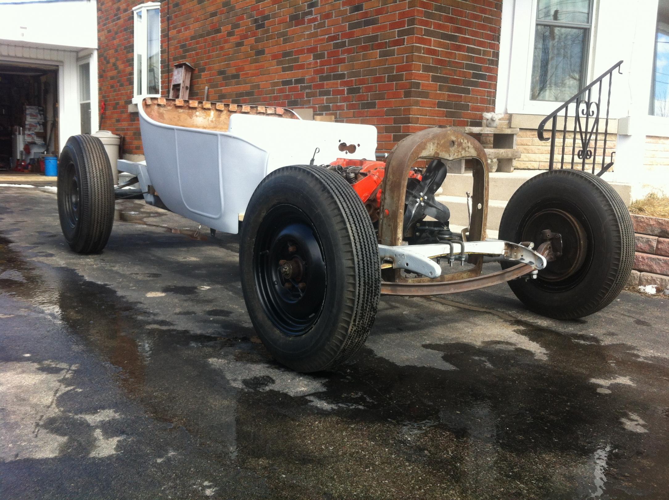

    Progress.
  23. NortonG
    Posts: 2,117
    NortonG
    One more.
