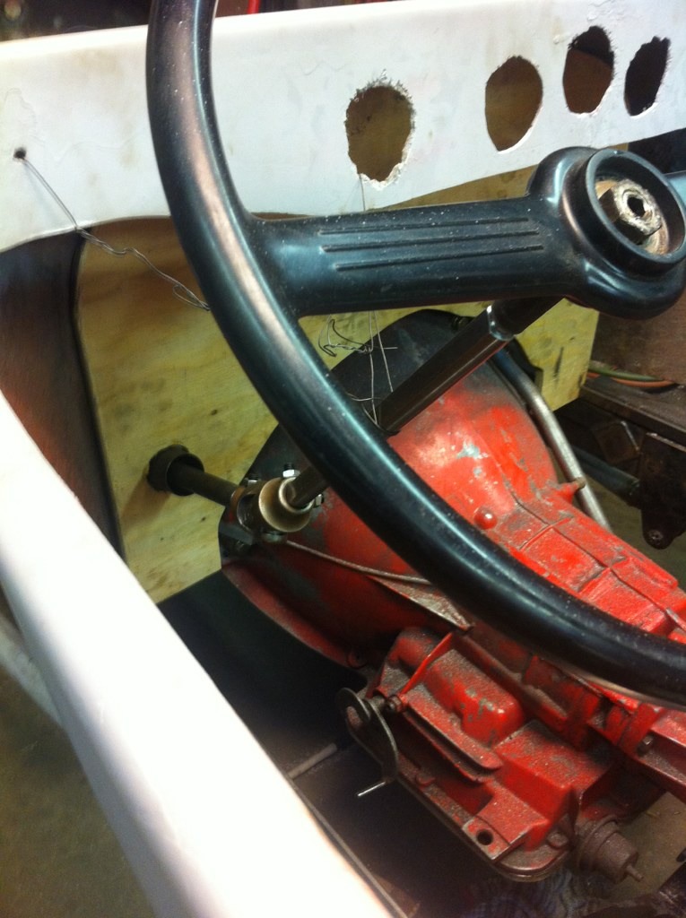

    With putting the u-joint inside the cowl and angling the shaft up from there, I'll actually end up with my steering wheel in a position close to where yours is Phil.
    There's plenty of room for my brake pedal to the right of the column and I could put a third pedal to the left in the future if we go that route.
    It's tight but I knew that getting into this, haha.

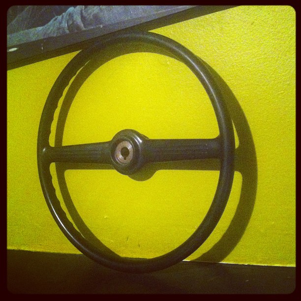

    I'll be running this 15" steering wheel..

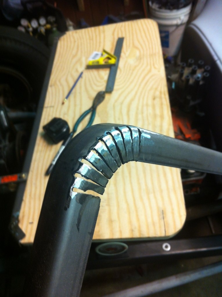

    Got the seat frame welded up. Mounts will get done tomorrow or Sunday.

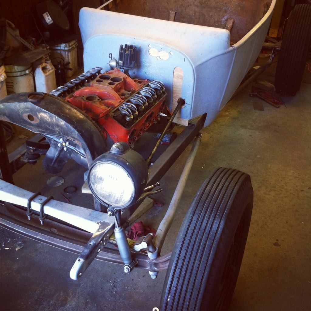

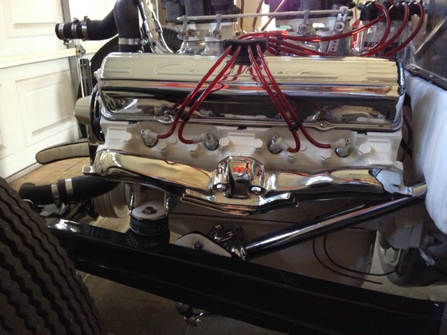

    Everybody loves a set of headlights...
    I was worried they would be too big.
    They're looking just right to me.

    The lights give a nice balance, looking good.JW
  27. Speedy Canuck
    Joined: Jun 3, 2010
    Posts: 3,896
    Speedy Canuck
    Looking good bud! I thought they might be a little 'heavy' for the front end as well, but now that they're on there, they look sharp.

    I need to get my tanks filled so I can finish bending my shock mounts and then I'll build my headlight mounts out of that Model A headlight bar I have.
