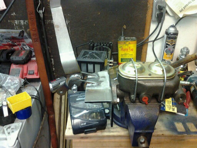

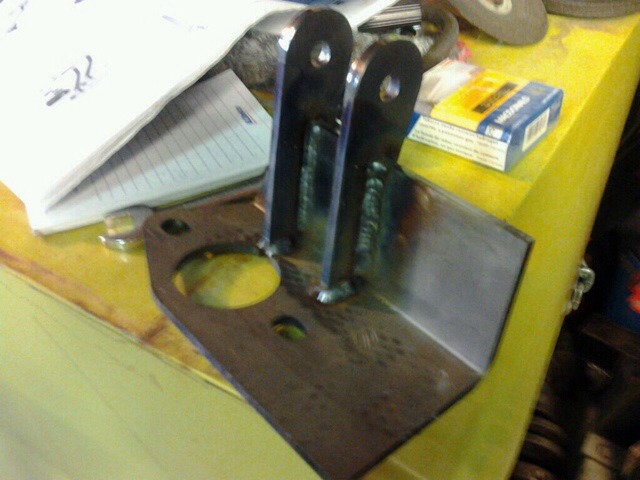

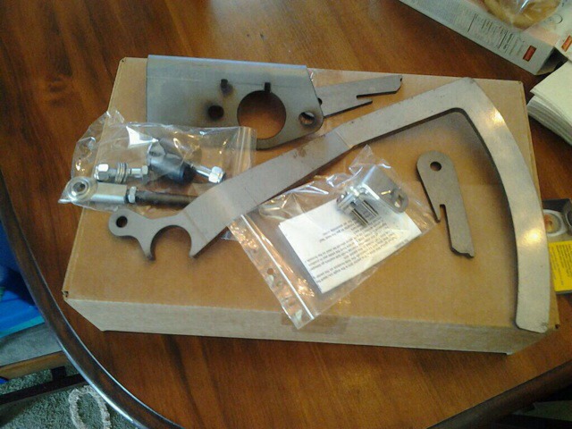

    In the meantime, there's a new brake pedal kit from Welder Series... ImageUploadedByH.A.M.B.1384463807.135652.jpg
    And here it is welded together.
    Slow and steady progress.

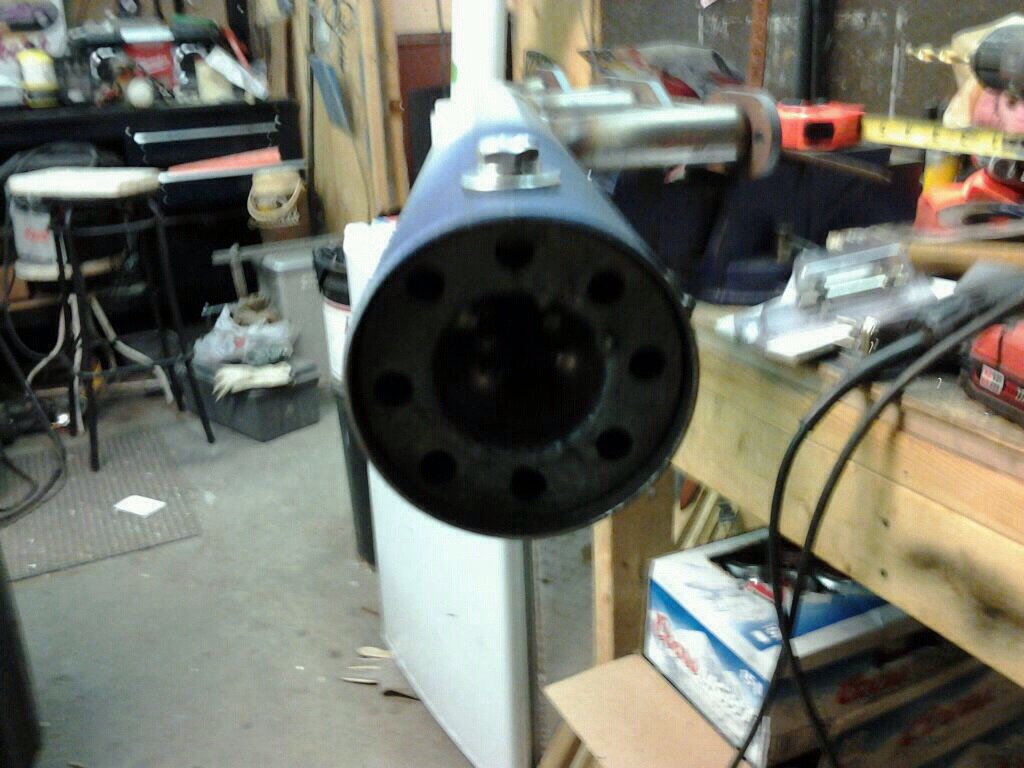

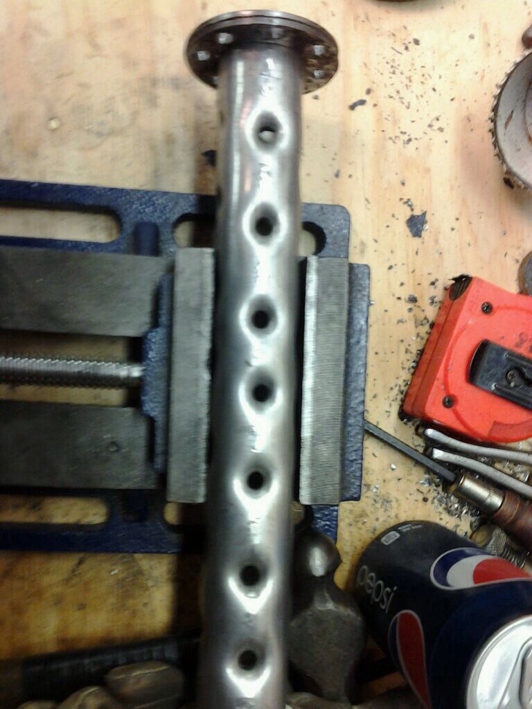

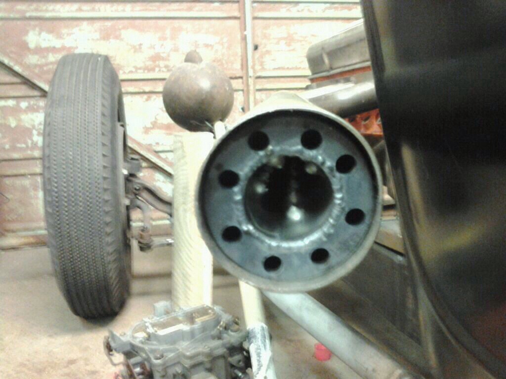

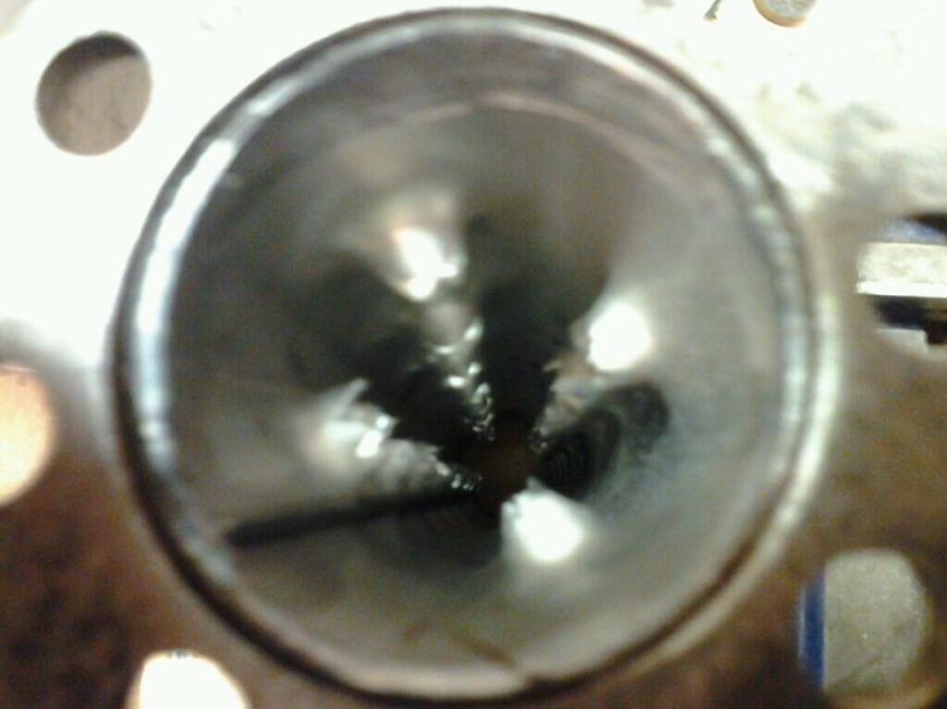

  18. A little more progress last night. The engine is finished and assembled. It's at the shop and might be firing up and broken in later on this week. I'm hoping for a video of that. The headers that Tim built from a GearDrive kit have been finished and hanging from the rafters for a while.
    What Dave never took a picture of and posted, were the homemade baffles that got made for the headers. I don't have a picture of them on their own, but Tim stuffed them in the headers last night for a final test fit.
    Then he glass packed them. They're ready for the motor now.

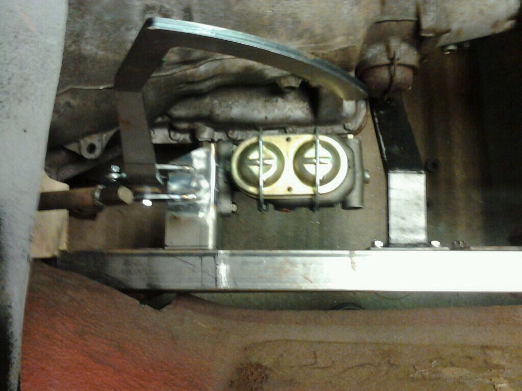

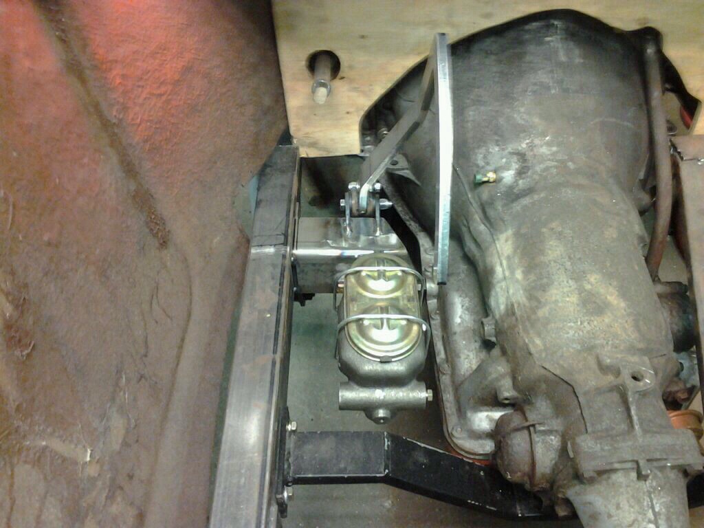

  25. A little more progress. Transmission is back in, and the brake pedal and MC have been fitted.
    Sent from a typewriter.

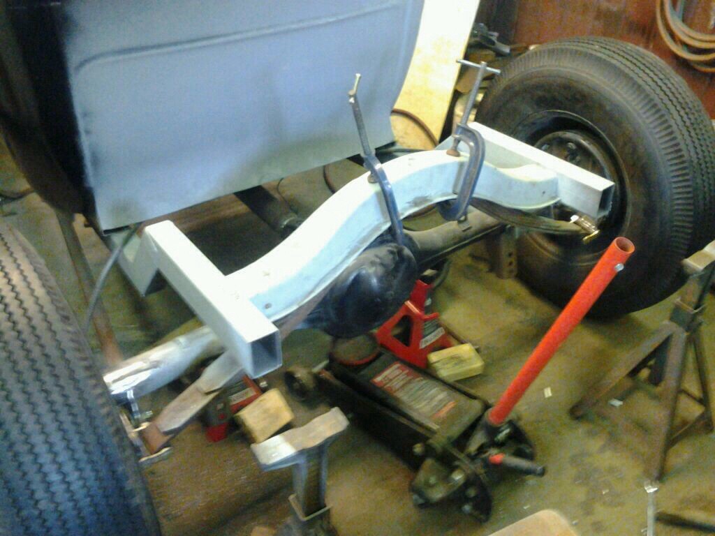

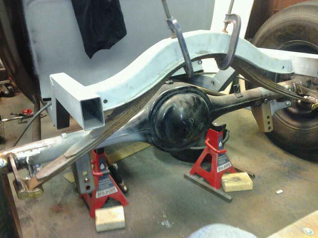

  29. I've been neglecting to update. A few small things...
    First off, the rear end came out to adjust the pinion angle. When it went back in, the rear bones were a bit too long. So they got shortened up, and now everything is in place.

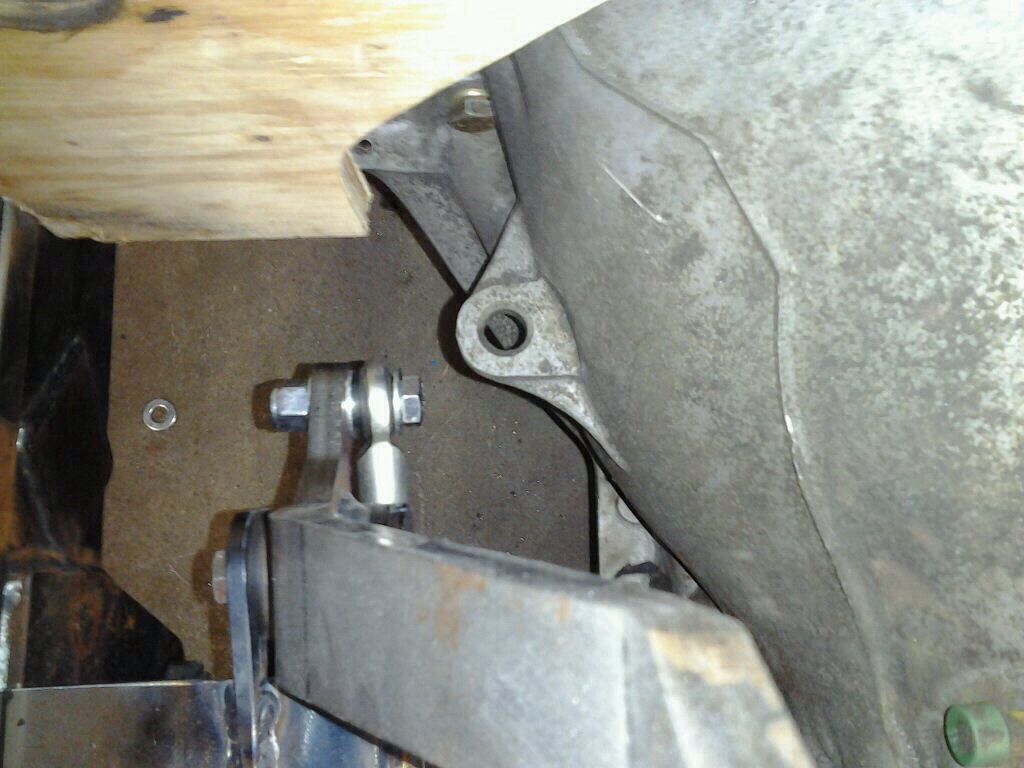

    Currently, the front motor mounts are in the frame. There is a rear transmission mount mocked up, but there is concern about the bellhousing cracking due to unsupported weight. So the plan is to add a transmission mount at the bellhousing...
    Something like this:

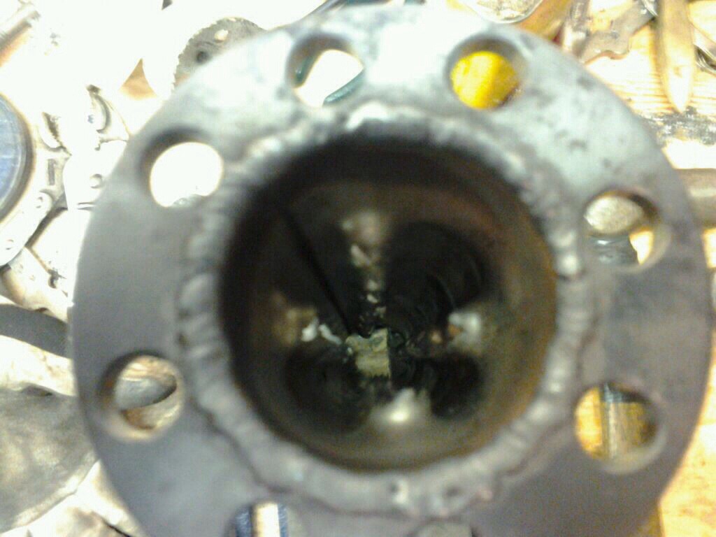

    A few more pictures of the homemade baffles...
    And as I mentioned before, the motor is finished at the shop. It's on the test stand, and is hopefully going to get fired up and broken in tomorrow!
