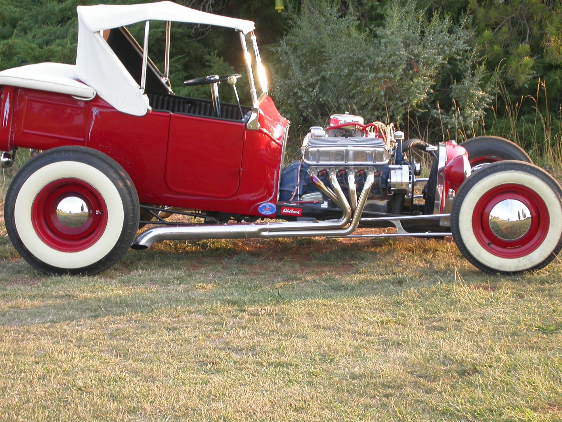

    I had to do the same with my roadster after a professional photographer pointed out "the ugly gap between the firewall and the engine) I moved the body forward three inches. And yes it is important to get the angles correct. You have to stand back maybe twenty feet and really look at the profile, even if you have to push it out of the garage. The grill is very important an inch too high and it looks like ****. My saying is if a grill on a roadster isn't too low it's too high. If that makes any sense.

    love the painted wheels on the red 1 ,, Kinda leanin that way ..Kev

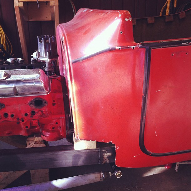

    How much space do you have between your distributor and firewall?

    I just measured about 1 1/2" but I have a crab cap with the wires coming out the side which makes it look closer. The measurement is irrelevant what you need to do is get the car out and look at it and see what looks right. If 1 1/2" still looks ugly them move the body up.
    I think you are doing some really kool stuff. I just don't want you to finish it and not like it and don't know why.

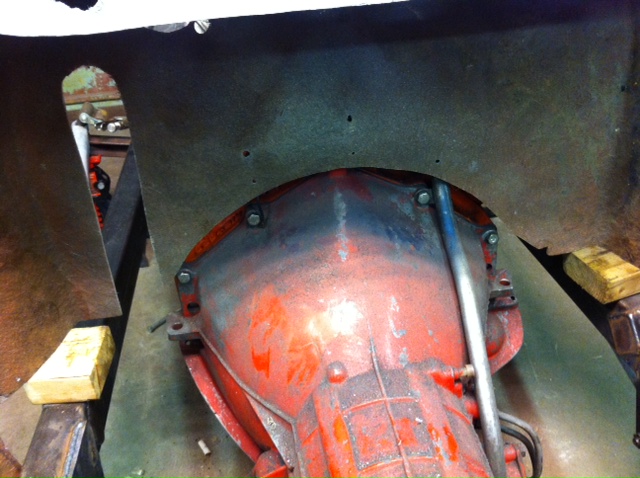

    You're going to like that gap between the distributor and your firewall. Mine was VERY close when I first built it. After my wreck, I moved the body back about 1 1/2". That makes it easy to get to the ****** bolts and it also doesn't look poorly planned.
    If I had a lift, I could drop my ****** without removing the body. A lot of guys have to take the body off just to see the ****** bolts.

    That's what the removable trans tunnel will be for...
    Having a well equipt garage with jacks and tall stands helps too.

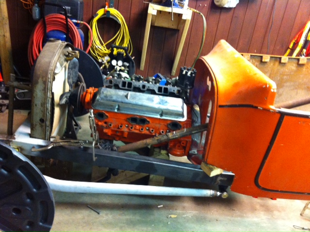

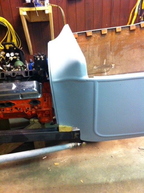

    Tight gaps are the name of the game and remember that Stubby HotRods rule!
    Lots getting done. The motor is sitting pretty much where it's going and the body is looking good where it is too...
