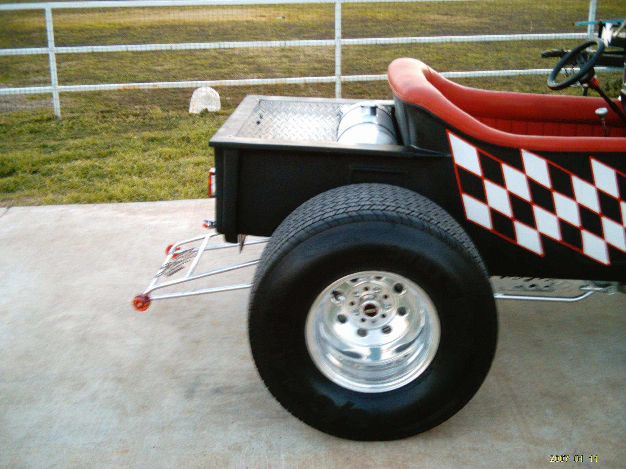

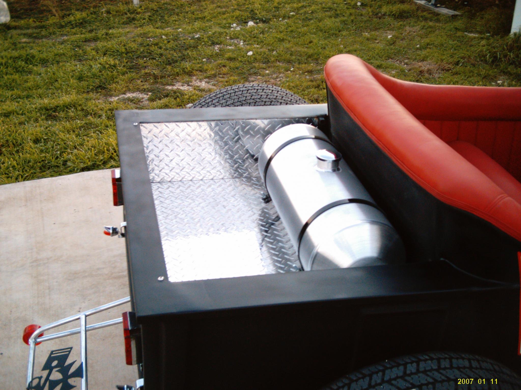

    The stock 6 blade sbc fans are 17 across. Its not 16, but its closer...lol
    The bed on mine is 30 inches if you are looking to see what it would look like.

    I just went out in the cold garage to measure my stock A tailgate. Your welcome. Oh cold in California is 40 degrees F. It measures 41" across and 13" high. That should give you something to gauge yours by. I like the length and height of yours but it might be widened enough to cover the line in back of the body. It is distracting. And if anybody thinks little things like that don't make a difference, that's why your car is ugly! Happy Thanksgiving. Oh yeah your in Canada. Well enjoy your family today anyway.

    Keep, I like the length on your bed!
    I think ours is just about that long.

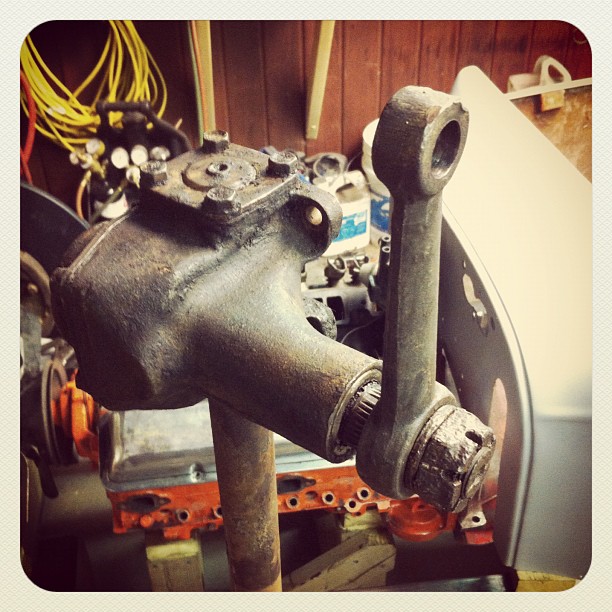

    Well, since we didn't get the steel we needed for the front of the engine mount that didn't get done. Lots of plans were made and measurements have been taken and we moved the engine up another inch.
    We started on the steering box mount and got pretty far with it.
    The steering angle is kinda low going into the cowl so we're going to put a u-joint inside the cowl to hide it and still have enough room to get the angle up enough to be comfortable sitting in the car. No one will be the wiser that it's hidden in there...
    Speedy_Canuck rules and (lent/gave/bartered/traded) me a '40 Ford pitman arm to use.
    I've really gotten a bunch of help on this build! Thanks you guys!

    Things look good. I think the u-joint in the cowl is the best idea. It'll allow you to dial in a comfortable angle on things.

    heres the one i stretched

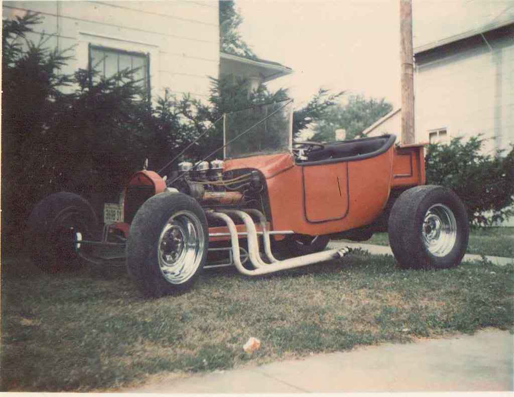

    Soooo this picture was found online tonight....
    I almost feel bad for painting it now.

    Don't feel bad for painting it, Your making it your own now. I have been following this build thread since it started and it is coming together nicely.
