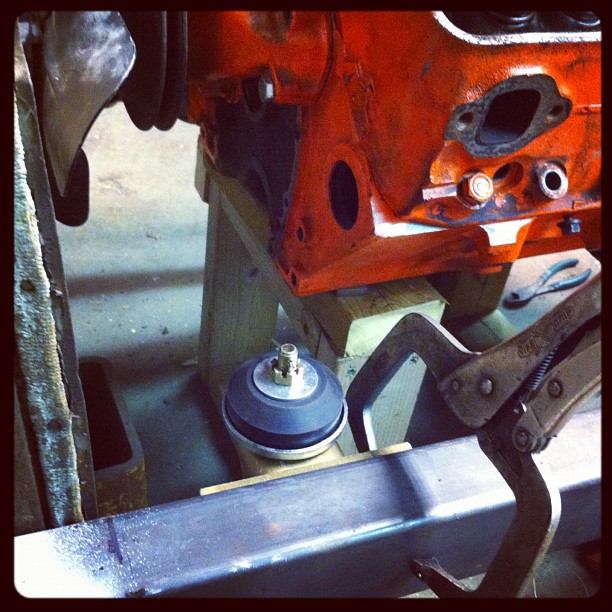

    More things getting done...

    I take it you are mounting the alternator up top?
  5. NortonG
    Joined: Dec 26, 2003
    Posts: 2,117
    NortonG
    It'll be getting a 12v generator if I can find a decent one to rebuild.
    We've got an alternator kicking around just in case too.
    But yes it'll be up top or over to the side.

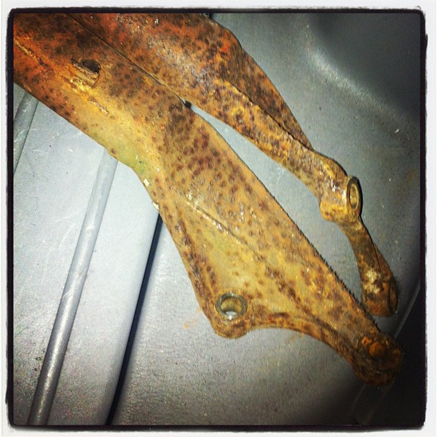

    More parts coming together...
    Gonna cut these ends off and make beefier mounts and beef up the bones themselves too.

  22. R U gonna leeve them rusty 2 B bad a$$?
  23. NortonG
    Posts: 2,117
    NortonG
    I think we'll add more rust to your truck instead of my car...
  24. steel rebel
    Joined: Jun 14, 2006
    Posts: 3,604
    steel rebel
    That's the first thing that broke on my roadster. If your going with open drive they are going to brake. If you want to see what I did I'll try to find a picture of take another.

  26. NortonG
    Posts: 2,117
    NortonG
    Just to make this point clear, I'll quote myself for effect.
    Lots of beefing up will be happening...
    I'm going to be possibly plating the whole side of these '40 bones.
    It might even get a torque arm off the pumpkin. We'll see how I decide to make the rear end brackets for the bones.
    Heres what we did for my last build,
    But, yes it had a torque tube drive line.
  27. Not to mention the horse power difference. I like the torque arm idea. It would certain take away worry about them breaking. Then you wouldn't have to worry how much horse power you may end up throwing at it down the road

  29. steel rebel
    Posts: 3,604
    steel rebel
    This is what I came up with. Heavy brackets angled in towards the frame. Held on by grade 8 bolts with spacers. Really looks crude in closeup photos but pretty invisibly on the car. Maybe I should have chromed them but I think you can overdo chrome. Or maybe I'm just cheap. Might not be the easiest solution but works well. Wow I need to clean the roadster. Sorry I'll get out there this spring before LARS and the T Bucket Nationals in Carson City in June.
