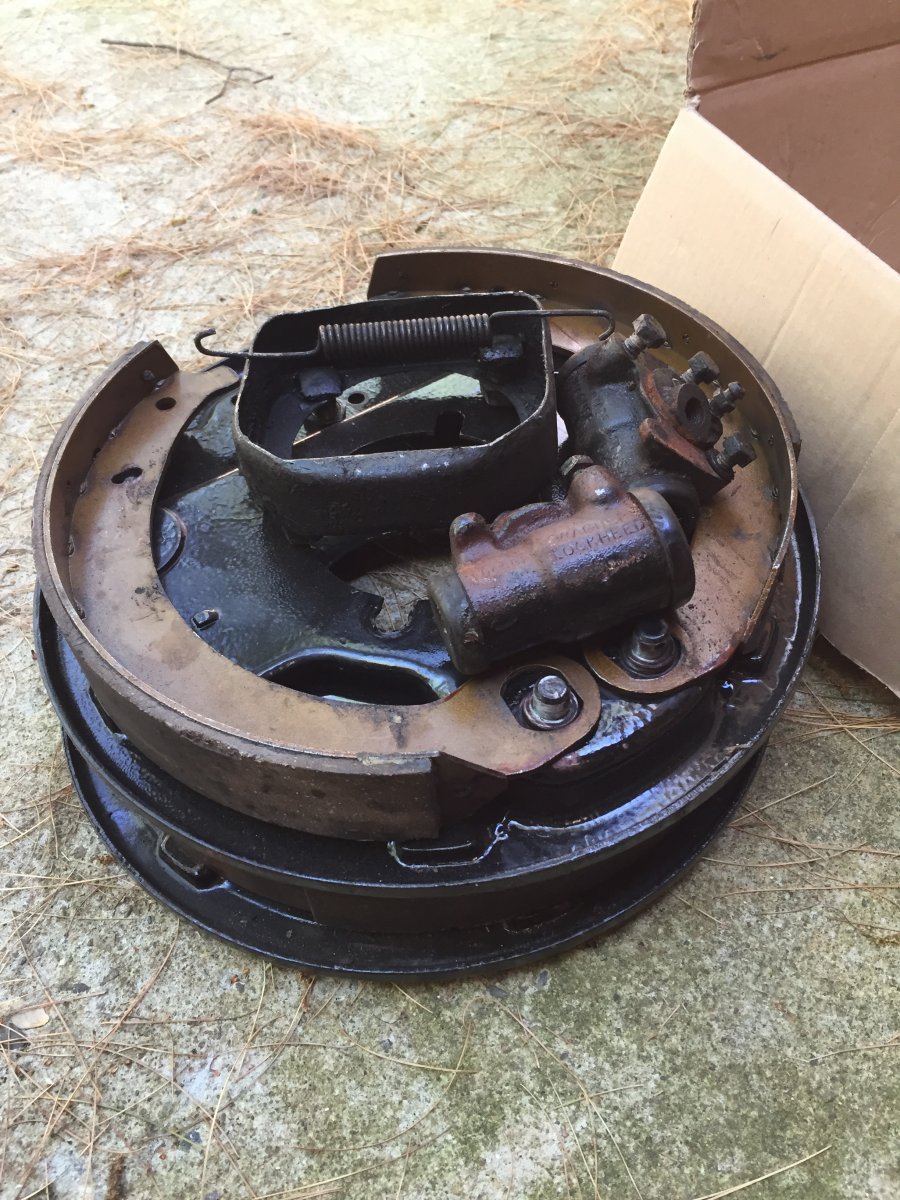

    Also got this nice pair of blasted and painted 46-7-8 front backing plates with new shoes and good wheel cylinders.

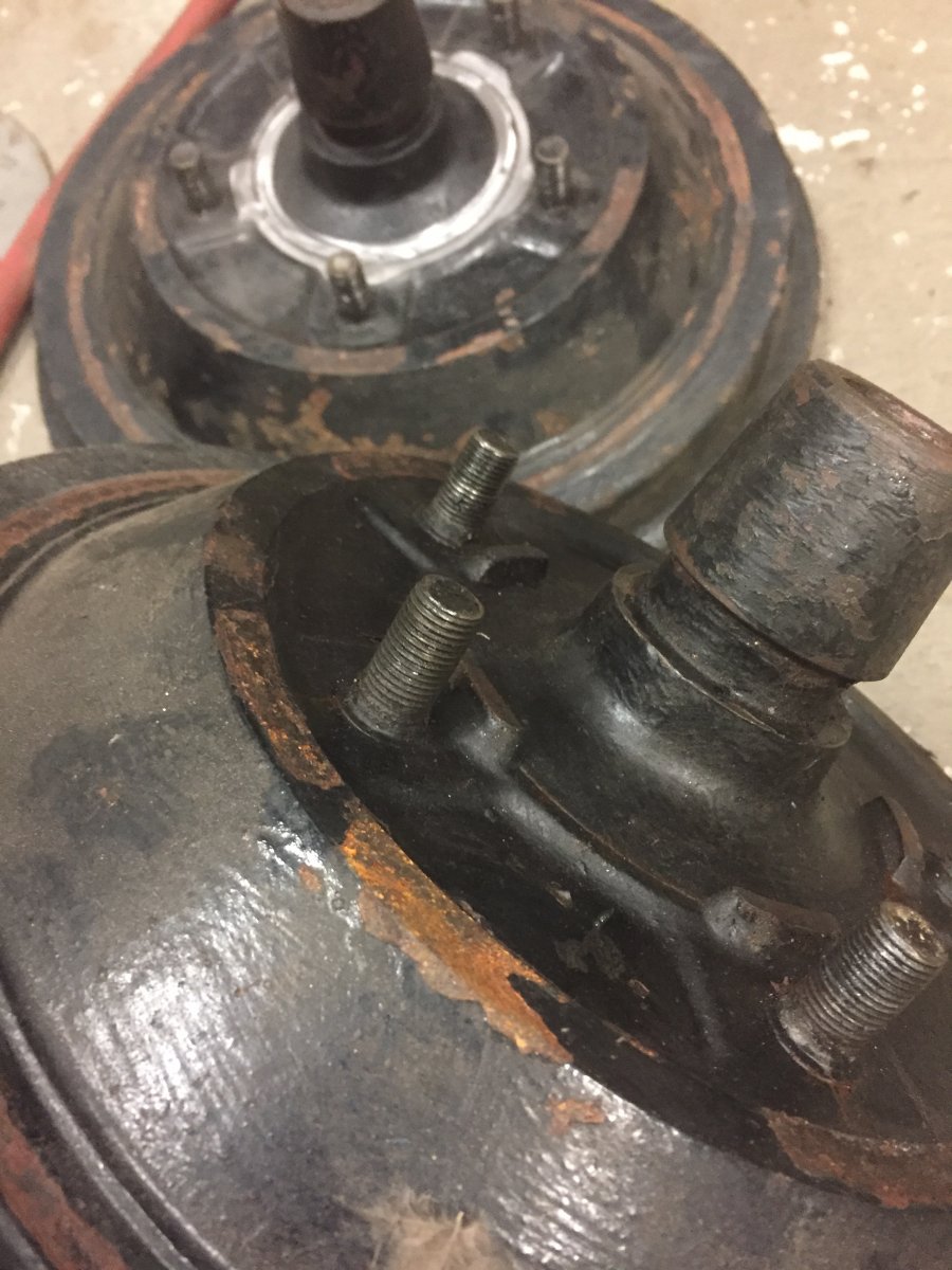

    IMG_1340.JPG IMG_1341.JPG IMG_1342.JPG IMG_1343.JPG Had the day off so I hung out in the shop. One of my issues was I'm using a '34 rear and wanted to run 40's steelies. There's several issues because the drums accept wire wheels and the spacers that are available didn't seem to cover the space where the lug nuts get torqued down on...kind of a bridge between the stud and cast pedistals.
    So I put the drums on my rotary table than on my milling machine and removed the pedistals than shaved the contact area down so that the rim sits flush.
