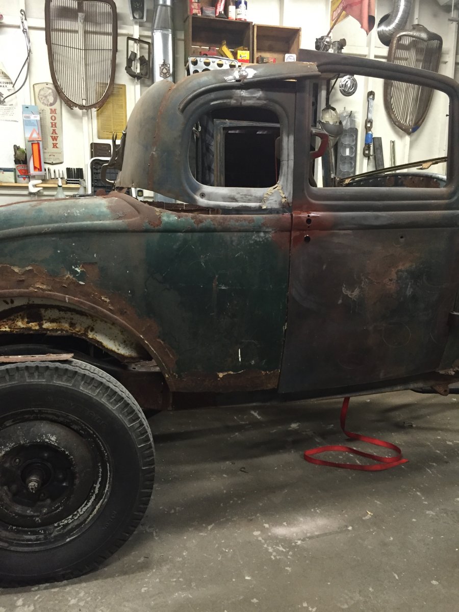

    Turns out the yellow windshield frame is chopped 4" and according to compiled mea*****ts of the quarter Windows.... Those are also chopped 4"
    So it's gonna be a 4" chop roof.

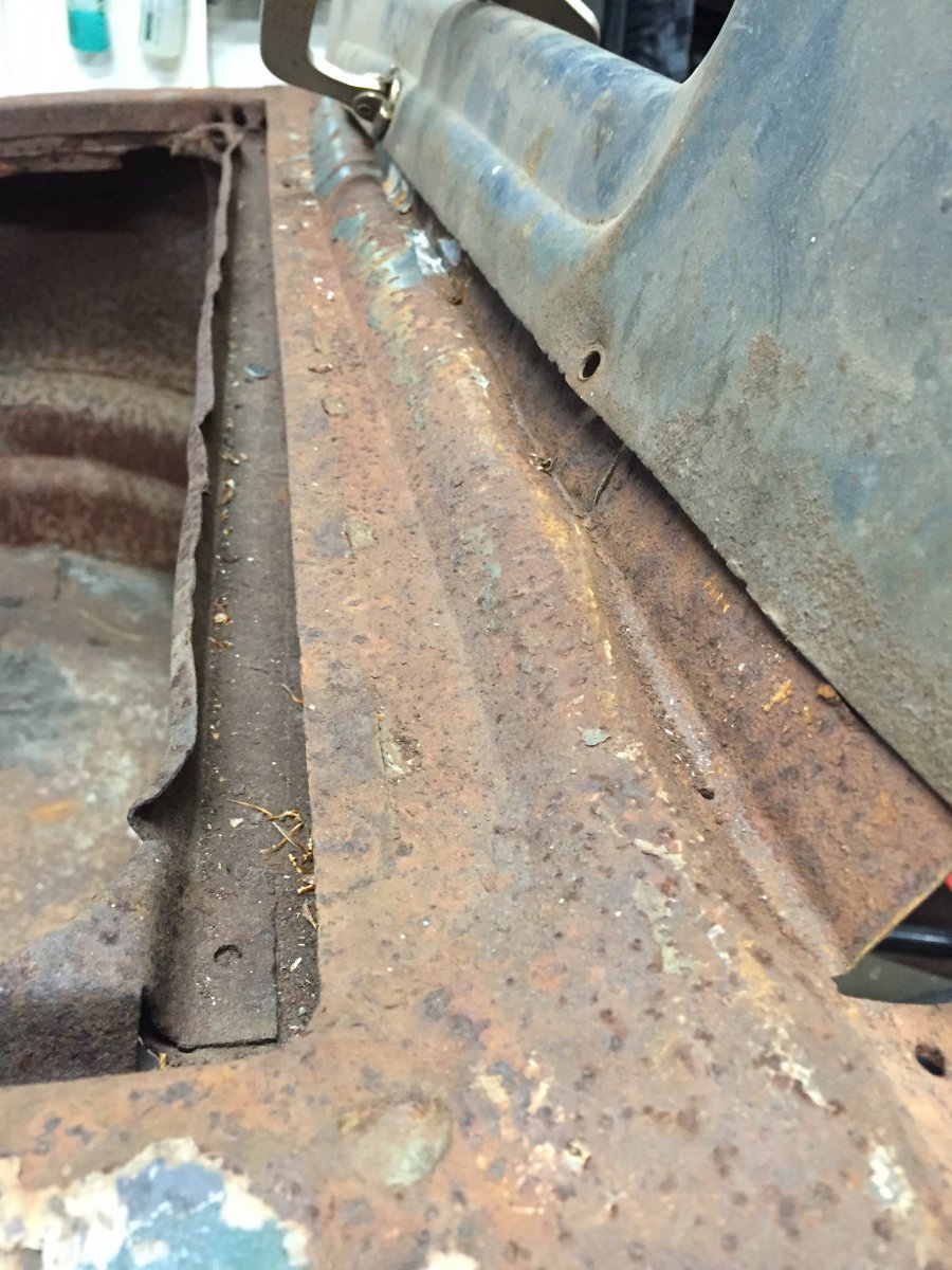

    The upper deck lid panel is in need of some metal work, I'm not 100% sure what it actually supposed to look like.
    Can someone take a pic of Thairs and post it up.

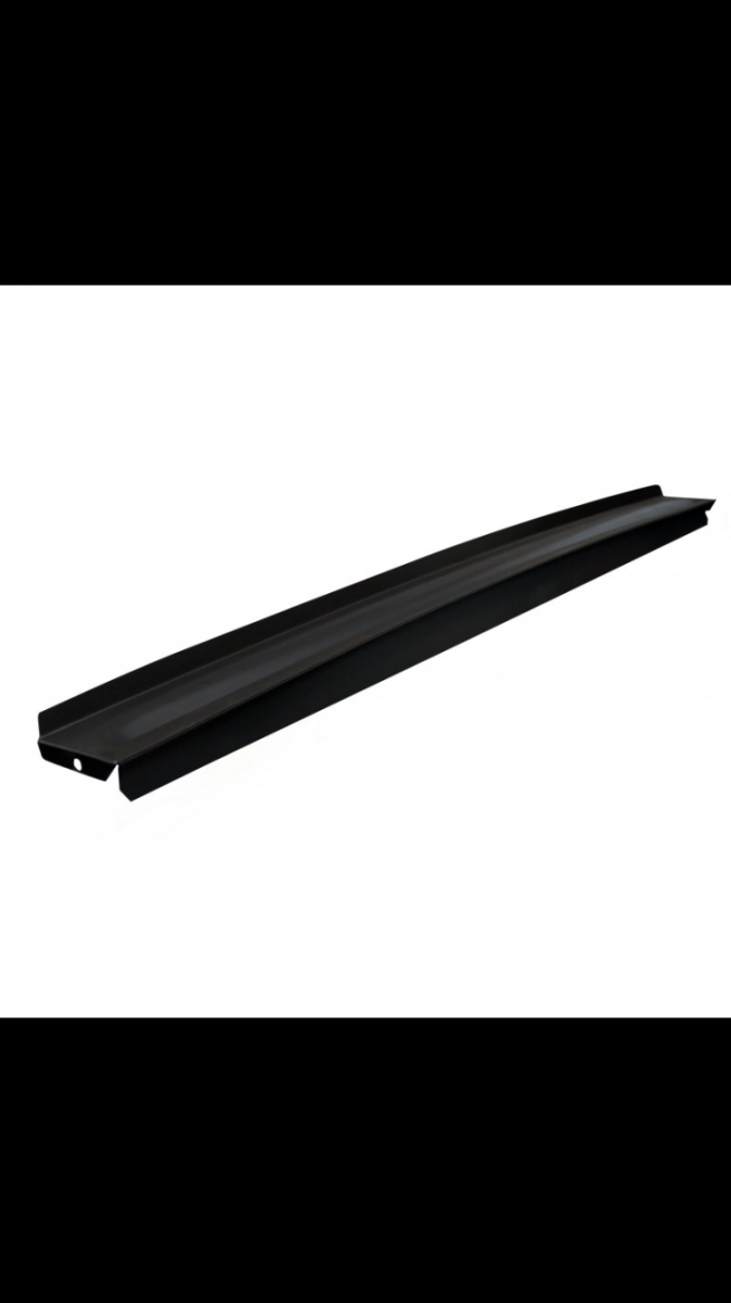

    Here's the united pacific replacement upper deck lid panel...
    Just doesn't look right to me ? Maybe it's the glare?
