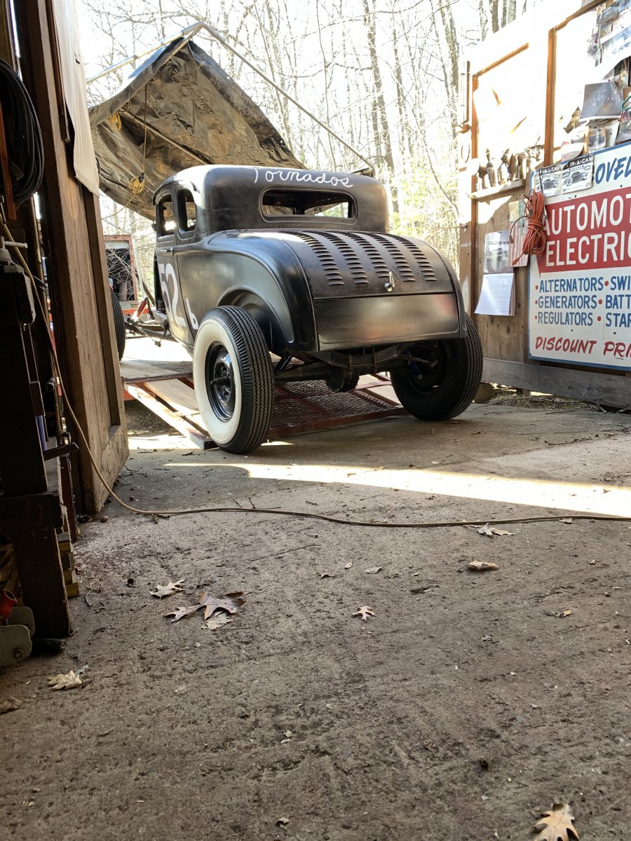

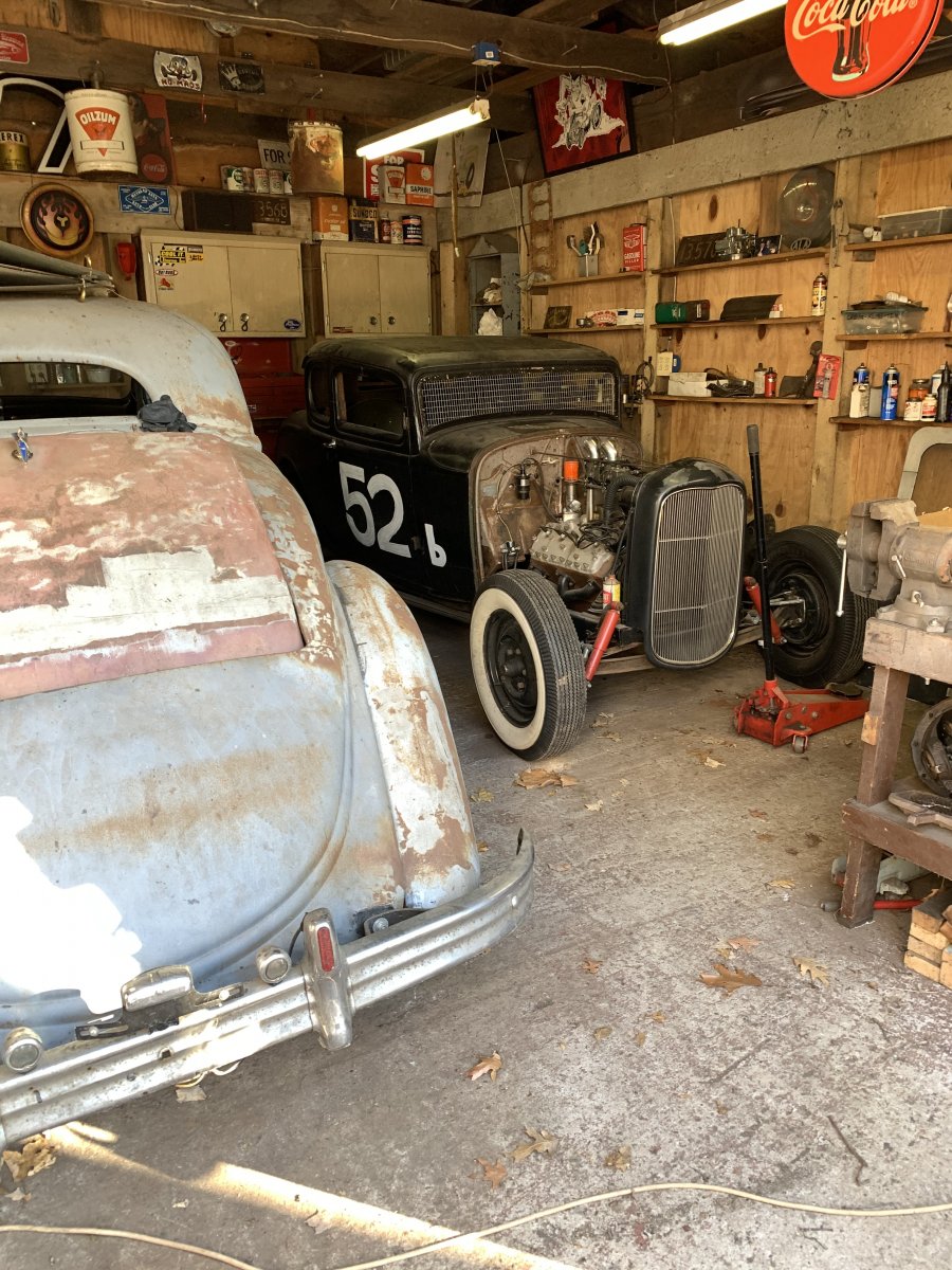

    It’s been a while since I posted about the ‘32
    It’s been in storage for a few years while Iv been working on another car. I swapped storage spots a few weeks ago.
    Iv kinda had a fluctuating problem with the car...I run low pressure electric fuel pumps on all my cars and still use a fuel pressure regulator. To be honest I would get the regs from my local auto zone,,you know the Mr. gasket chrome knob type adjustable ones. Iv had nothing but problems with the last 3 of them, the car would run good, turn it off and start it again....would run like crap, skip n pop.
    I removed the reg and installed a Holly adjustable, the style with the gauge......so much better! Car runs mint.
    plans are to do tear down, media blast, finish the metal work and maybe some paint.

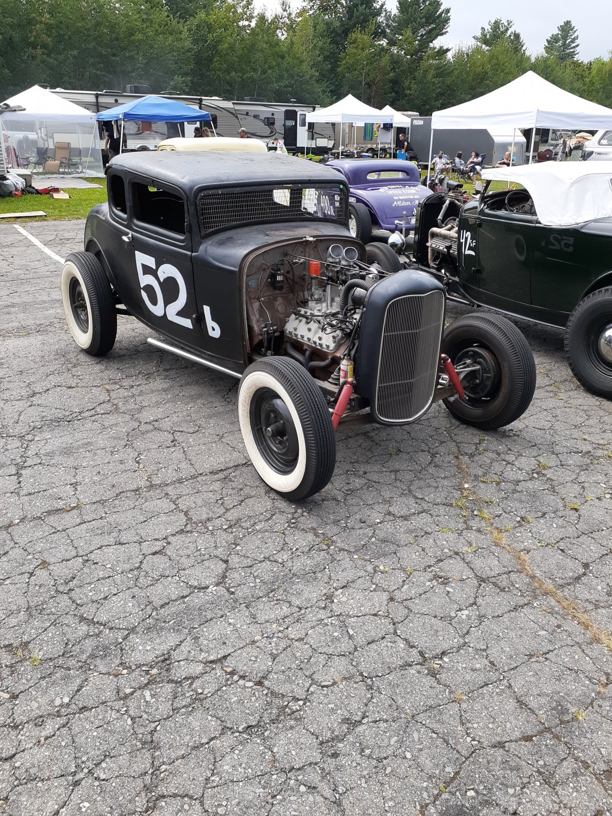

    The 52b at the Pinetree Jamboree
    Winterport, Me last weekend.
    Pete and a few friends put on one hell of a show, it was fantastic. Pete also let me run his car through the 1/8th a couple times. I have to say this car is rock solid, is wicked fast, and bad to the bone. Thanks again man, you made my weekend.
