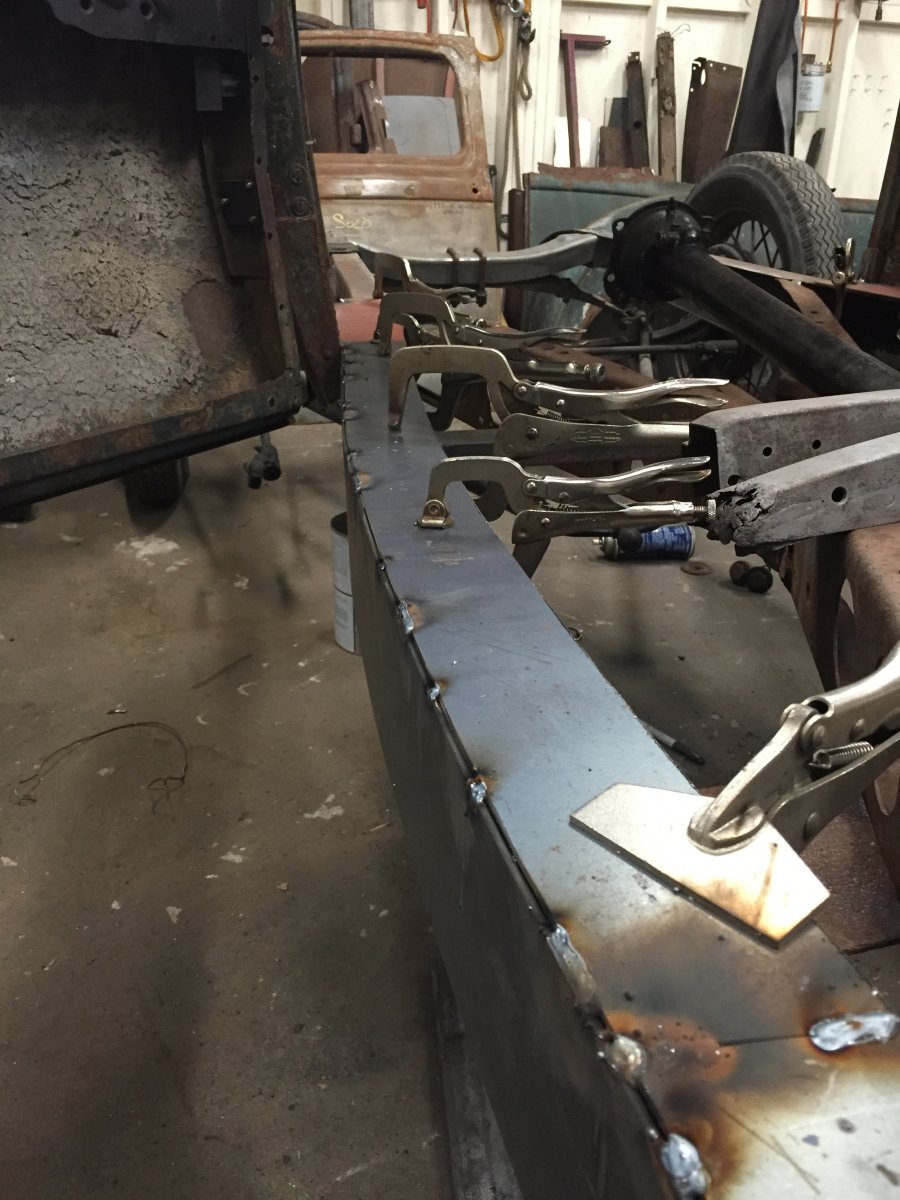

    In the garage now. Started making the channeled sub rail skirts

  4. Pete
    Joined: Mar 8, 2001
    Posts: 4,791
    Pete
    Driver side.

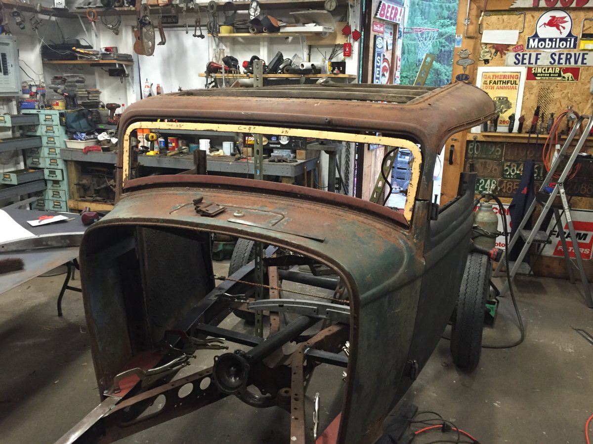

    image.jpeg T******* the roof to fit windshield.
    DAMMIT, I gave my windshield hinges away a few years ago and forgot!!!!! Anybody have a pair for sale???

    I found the hinges.... Phew
    Have the roof tacked on at the A pillars.... Gonna be a **** load of pie cuts to make everything line up.

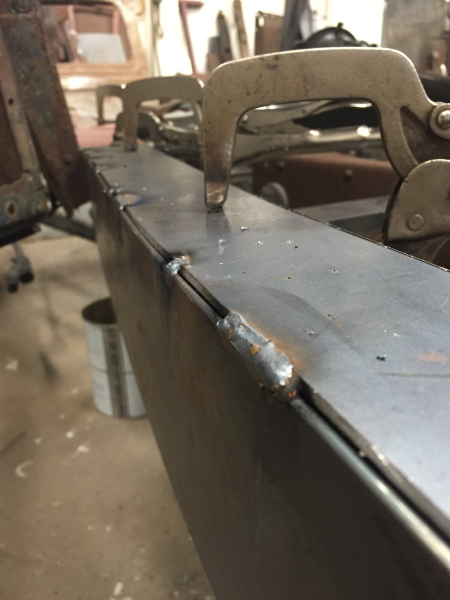

  12. What gauge metal are you using for the sub rails?
    jhouse88 likes this.
  13. Pete
    Joined: Mar 8, 2001
    Posts: 4,791
    Pete
    Well.... I had a full sheet of 1/8" that I ordered for another project... Figured shoot, let's use it up.

    image.jpeg G image.jpeg Trimmed a bit more off the A pillars. I have to tweak the hinges to get the frame centered but the actual window opening is right on.

    Im not sure if the gaps above the windshield or below are correct or even in the ballpark.
    A reference pic would be great... Anyone?

    My gap is 1/4" top and 5/16" on the bottom. I cant figure out how to post a pic from my phone.
