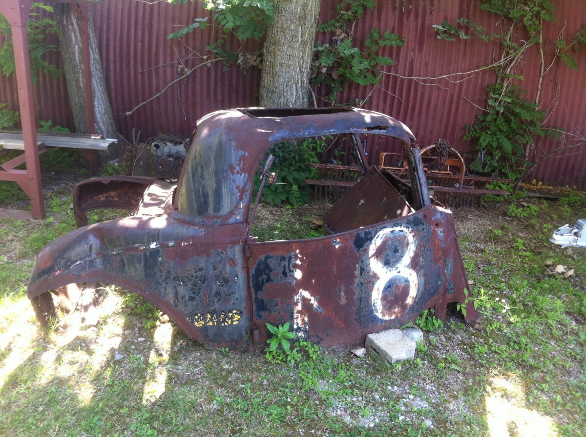

  9. spurgeonforge
    Joined: Oct 18, 2013
    Posts: 417
    spurgeonforge
    image.jpg here's another project when you get your 32 done
