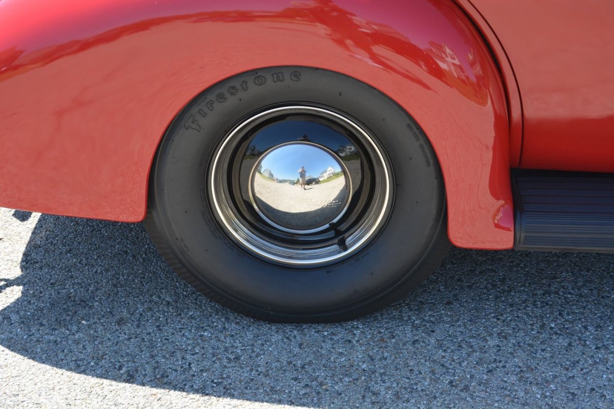

    What, no **** about the decision to be cheap and use the chromed Chevy ralley's leftover from the T???

    Nah... Moon caps'll fit over 'em anyways!:)
