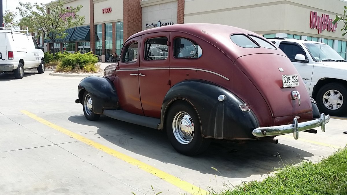

    Parked outside the restaurant where we had dinner, on the other side of town.
    After picking up the sedan from the muffler shop, I was pretty excited to drive it. I had the exhaust guy use the old gl***packs and the old tail pipes, so I was happy with the sound, well, except for the squealing belt that I could now hear. Every time I'd step on the loud pedal, you'd have thought I kicked a pig!
    A new belt, some additional tension, and a little bit of bar soap seem to have that under control now.

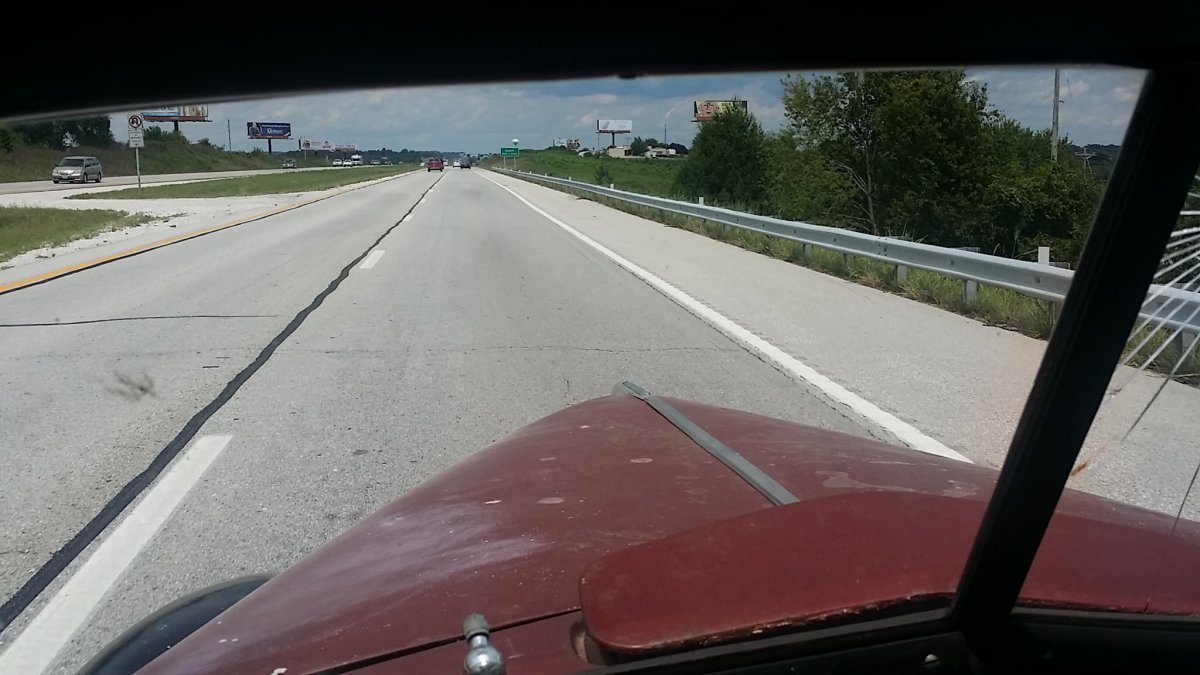

    Yesterday, the forecast was fairly decent, so I hopped in the sedan and drove it to my scheduled "office" day, in Branson. It's about 45 miles away, so it always serves as a great opportunity to put some miles on a car while getting them tested out. I'd driven it a few places, with the pipes snipped at the firewall, but now that I had full length exhaust, I could finally drive it without having ringing ears for hours afterwards, too.
    The trip to the office was pretty uneventful, other than the recurring belt squeal, once I got up to about 2500 RPM. The trip home, however, was where my trip became more of an adventure.
    I tend to run on faith (some would call it foolishness), with very few tools, and no extra parts. I did throw in a socket set and some wrenches, but didn't think to stop and grab an extra fuel filter. About halfway home, the fuel filter clogged. It's hanging just off of the fuel tank, between the tank and the electric fuel pump, so at least it was fairly easy access. I pulled the filter, knocked out some chunks of rust, blew through it, and put it back on. Back in bid'ness! Made it back to Springfield, but I had to run east of town, to pick up some club t-shirts. While on that run, I had to stop another time and blow out the filter.
    Apparently, the second time I blew out the filter, I caused the cap, on the paper filter, to pop off, so I started ****ing **** into the filter that is on the fuel pump. Had to stop about 5 more times, before I could hike over to a store and grab another one.
    The foolish part of that whole thing was that I p***ed 2 O'Reilly stores, an Autozone, and a WalMart, where I could have picked up another filter, just after the initial clogging. Yeah, I probably should have dropped and flushed the tank, prior to ever driving it, but where's the fun in that?
    Once I installed the new filter, it was back in bid'ness, and the car ran great again.

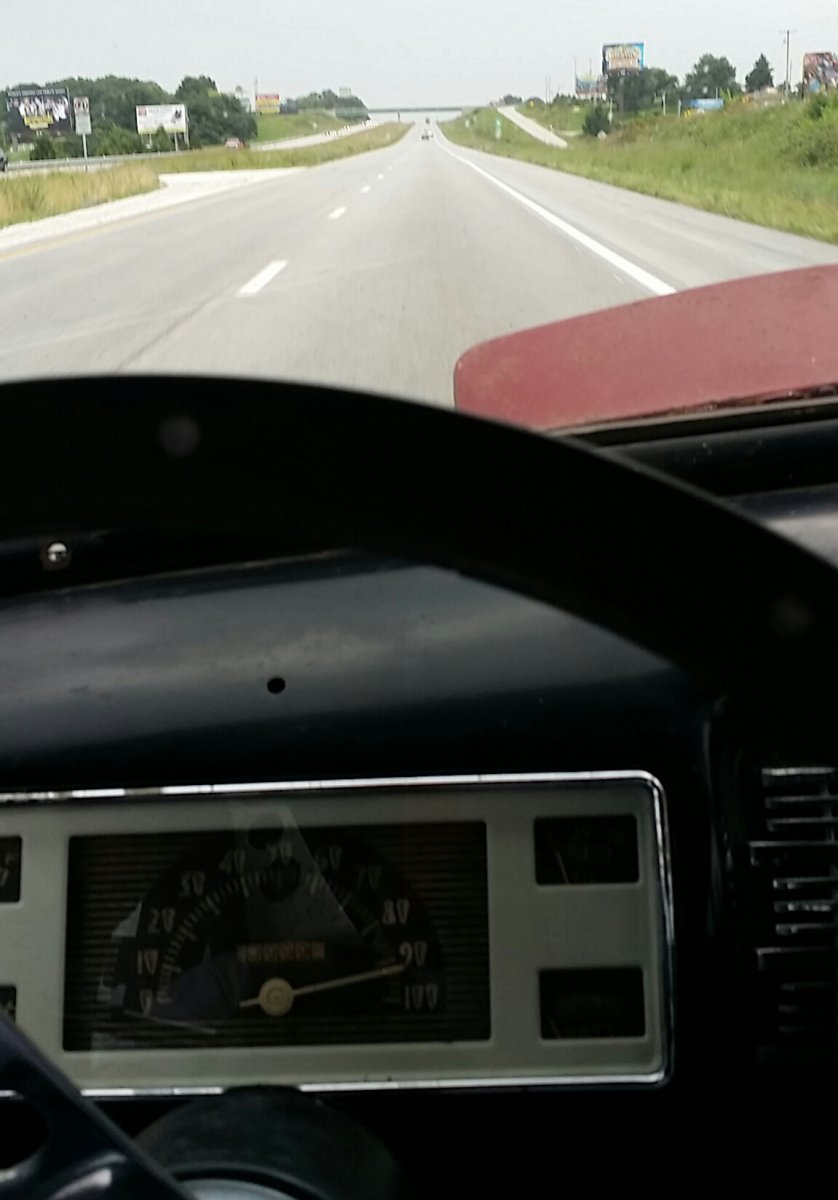

    Is that speedo accurate?

    LOL. No...I need to take some time and pull the speedometer driven gear out of the transmission, count teeth, and do some calculating. I was running along at about 63MPH when I took that photo.

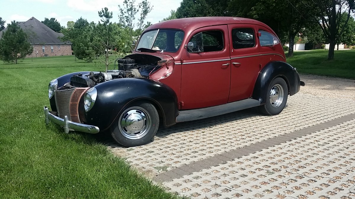

    Spent a little time under the car, modernizing the oil filter, with a spin on adapter. Changed the oil, and took it out for a spin. Before I left the house, I popped some caps onto the driver's side, just to get an idea of whether I liked that look or not. I don't know if the caps are too "finished" looking, or if I have just gotten used to seeing it without.
    So...public opinion poll time. Caps or no caps?

    I vote caps. Good job on the MorDor by the way.
    bchrismer likes this.
  17. 50Fraud
    Joined: May 6, 2001
    Posts: 10,099
    50Fraud
    Caps. And hood, before you're all done.
    I don't know if there's a smoothie cap, something like a '40 hubcap in appearance, available for use with rally wheels. I'd try that if it's possible.

    Yeah, the hood is a definite "gotta do" that I haven't gotten around to yet. When looking for caps for the wheels, I had the options of the stock bullet style or the "highway patrol" caps (at least through Speedway). Rally wheels were definitely NOT my first choice, but since I had two that we had taken off of Dad's T, it was the cheapest option, and since this project is all about getting it on the road for "the next guy", cheapest was the option that I chose.

    You really do not need 2 more of either caps in MHO, no one can see both sides of the car at once! I am going to do that with my '40 Coupe once I get the same size tire on the front TTD's that I have on the red steelies with 50 Ford caps & Stainless Steel ribbed beauty rings! Love your Mor Dor. I missed one way back when in NJ a '39 Deluxe with a SBC 283 stock '39 3speed
  23. I think if you add a bit of color on the caps, maybe in between lines, it will break up all the chrome. Still works out good though.

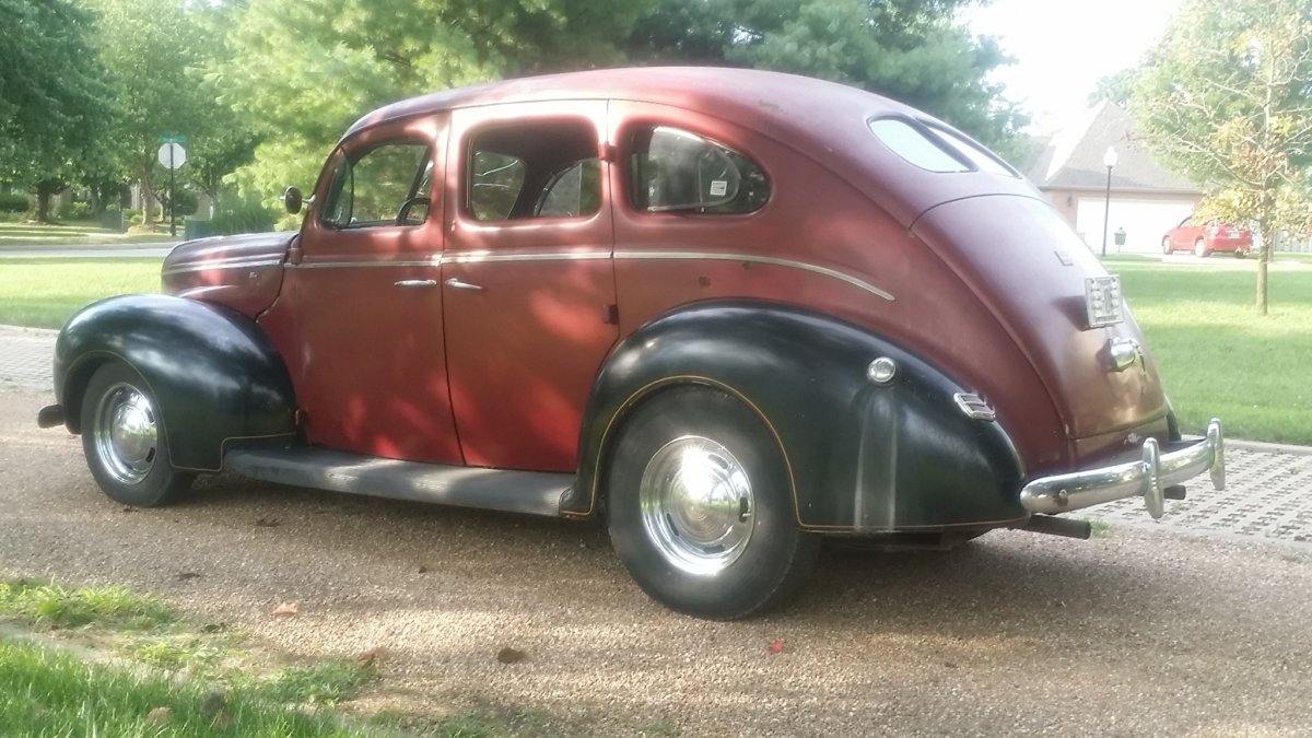

    Finally got the hood back on the car. Was kinda strange driving it with the hood on, but I like the way it looks MUCH better.
    Took it up by the neighborhood pool for a quick photo shoot, after giving the hood a good scrubbing.
    Got the p***enger side toe board replaced today, too. Didn't get to the horn, lighter, or replacing the faulty 6v regulators on the gas and oil pressure gauges, though. Wound up mowing gr***, instead.
    It'll be for sale up at the Springfield, MO Swap Meet, in the car corral, and I am planning on driving it over to the HAMB Drags, if it doesn't have a buyer on Friday. If it doesn't sell that weekend, it'll probably be over at Frog Follies with a For Sale sign in the windows, too.
