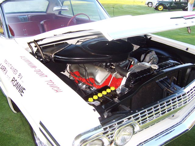

    I see Mgtstumpy has listed many articles that one can read on the 427 motors. Here is a picture of GM's 427 Mark II Mystery Motor they display at one of their Heritage Collection buildings. Second pic is Hank Gather's Z11 from Michigan (Ole Mr Wilson/Ronnie Sox 63 Impala). This is one of the best sounding cars in my opinion. The camshaft really makes some great noise. Then the sale pic is something I lifted off the HAMB I believe-just thought it was cool. Z11Thunder.jpg
